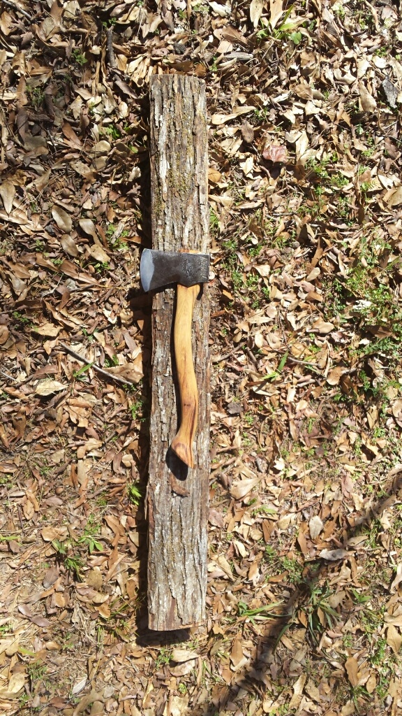

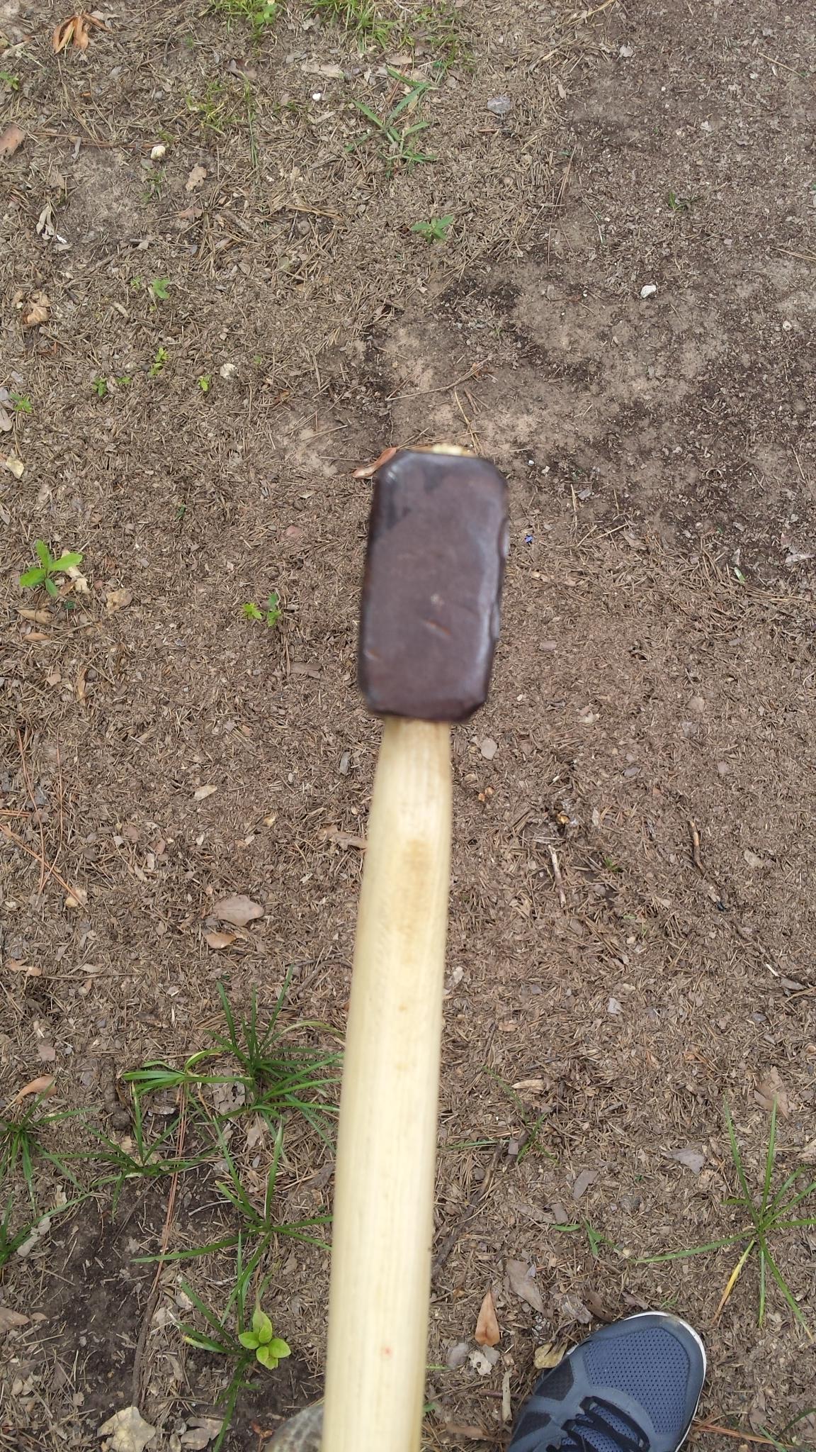

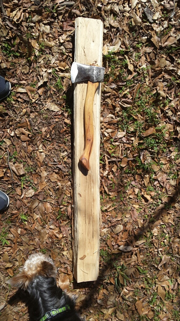

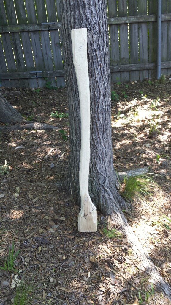

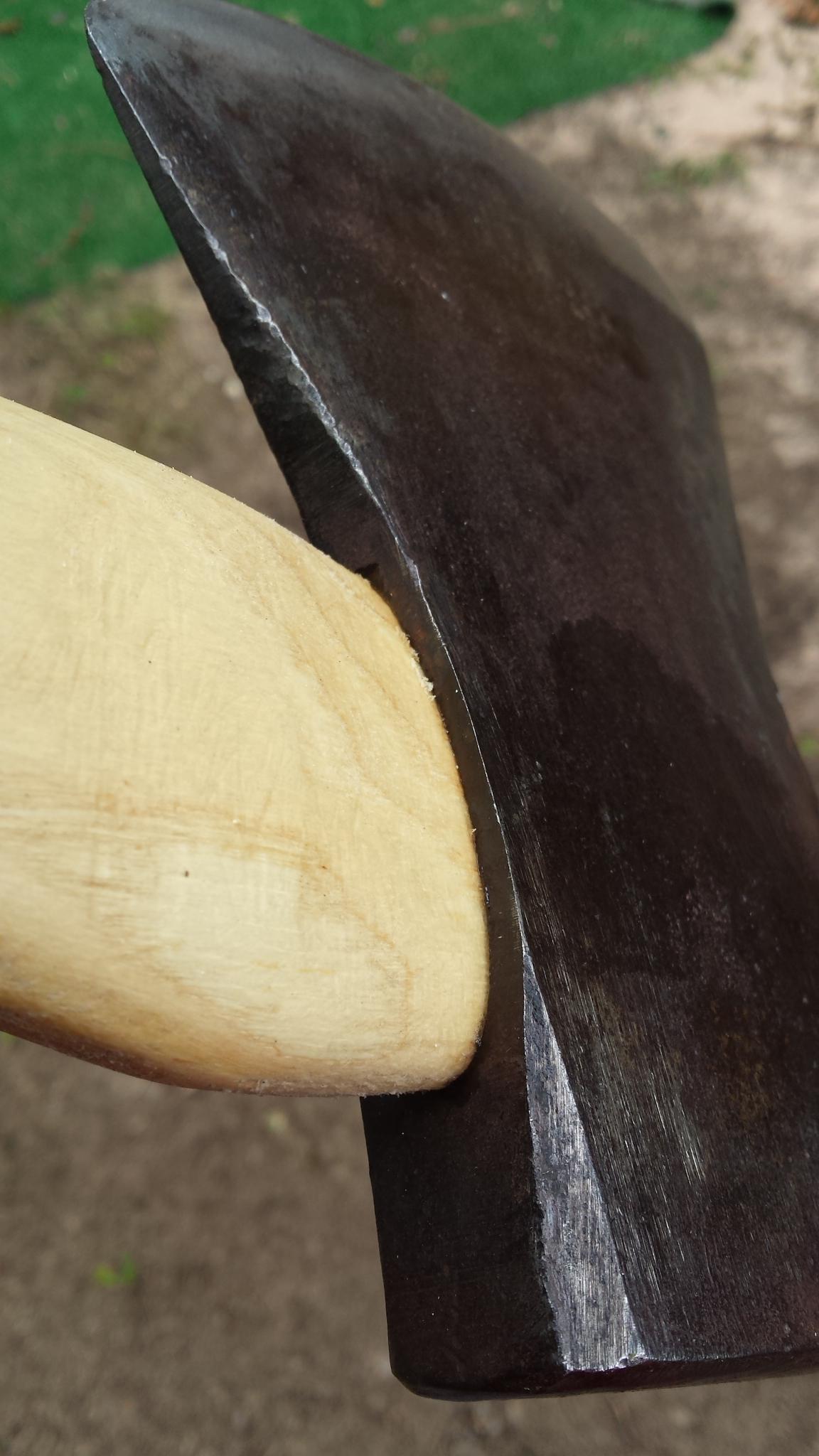

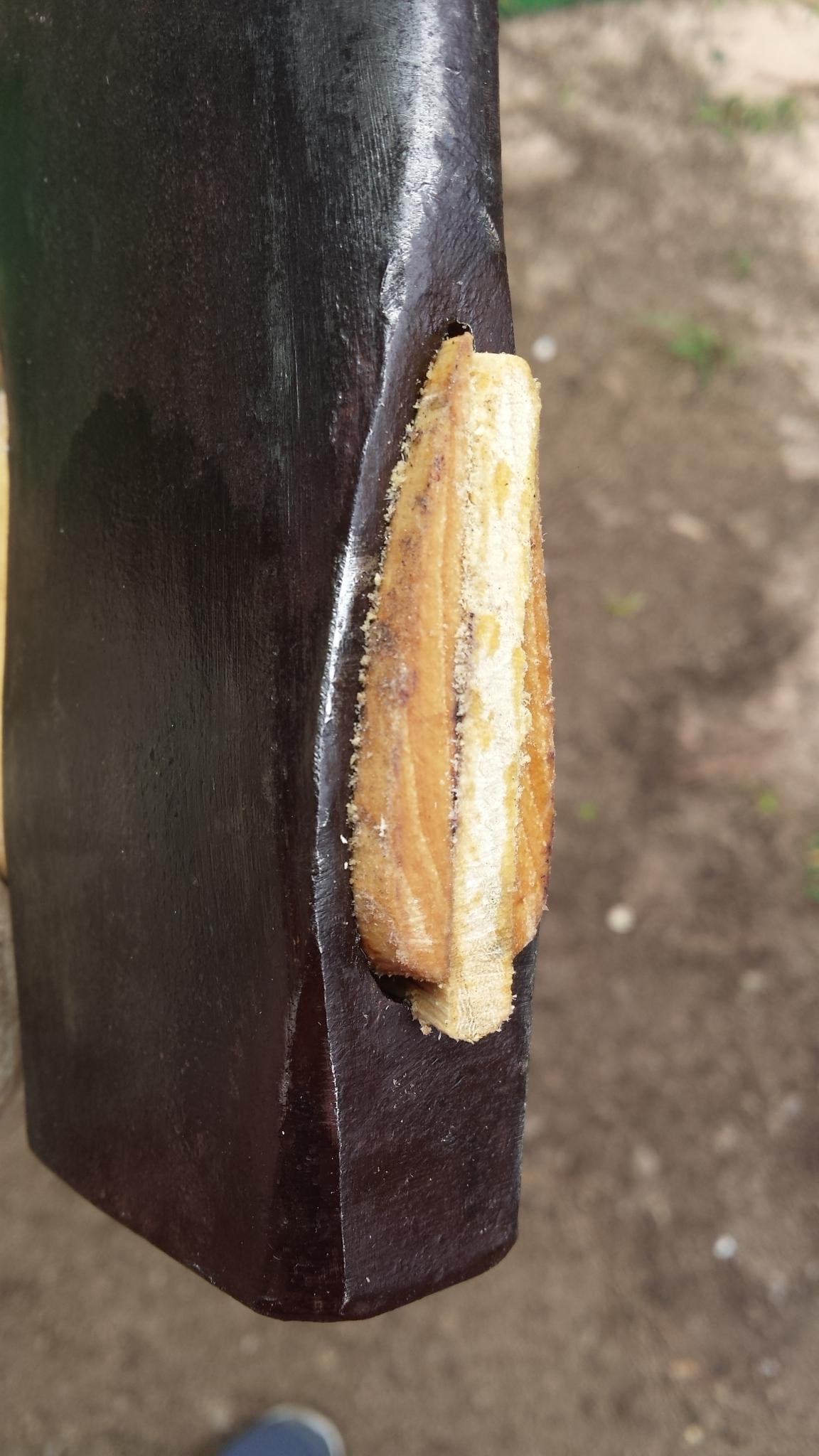

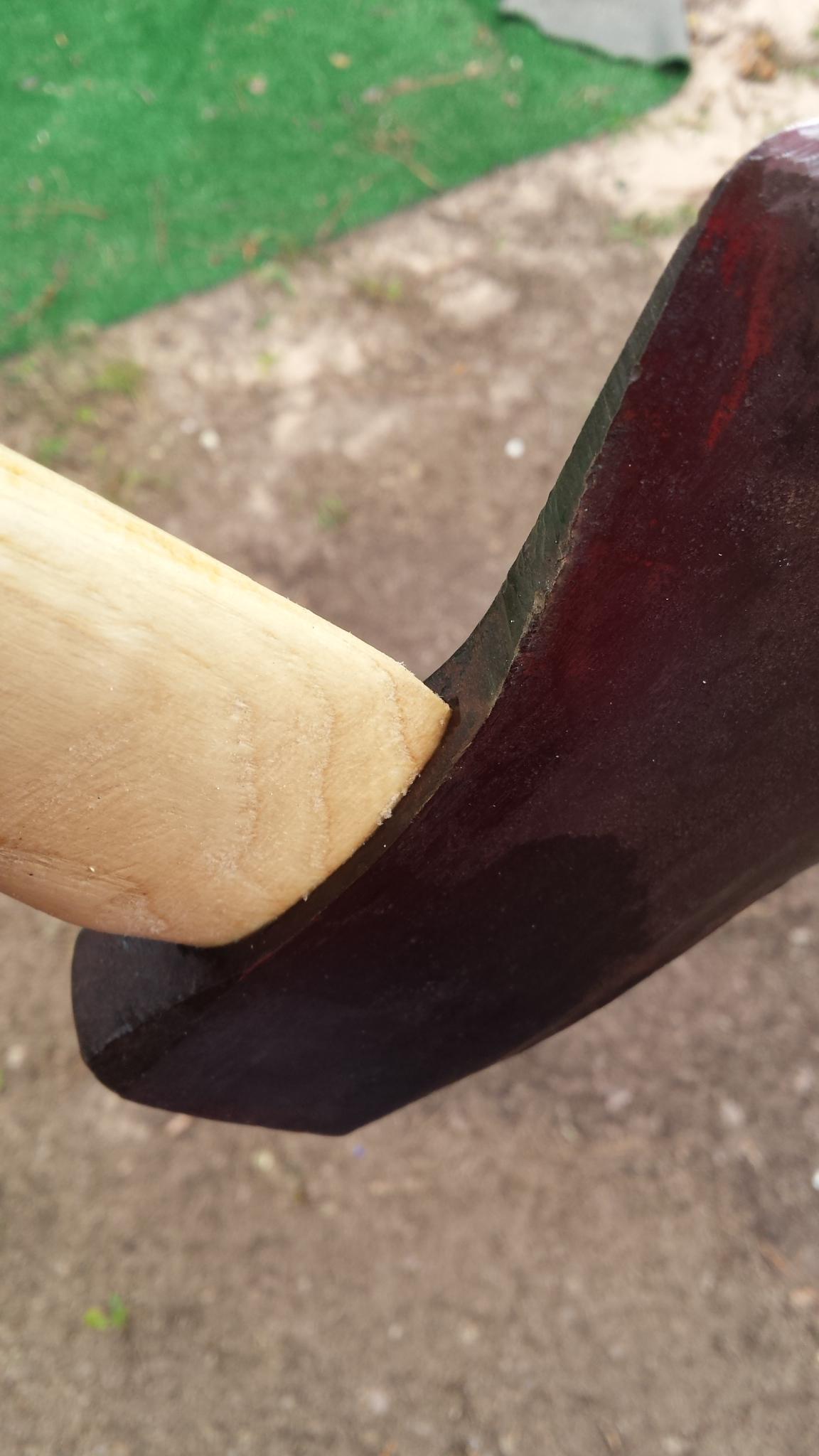

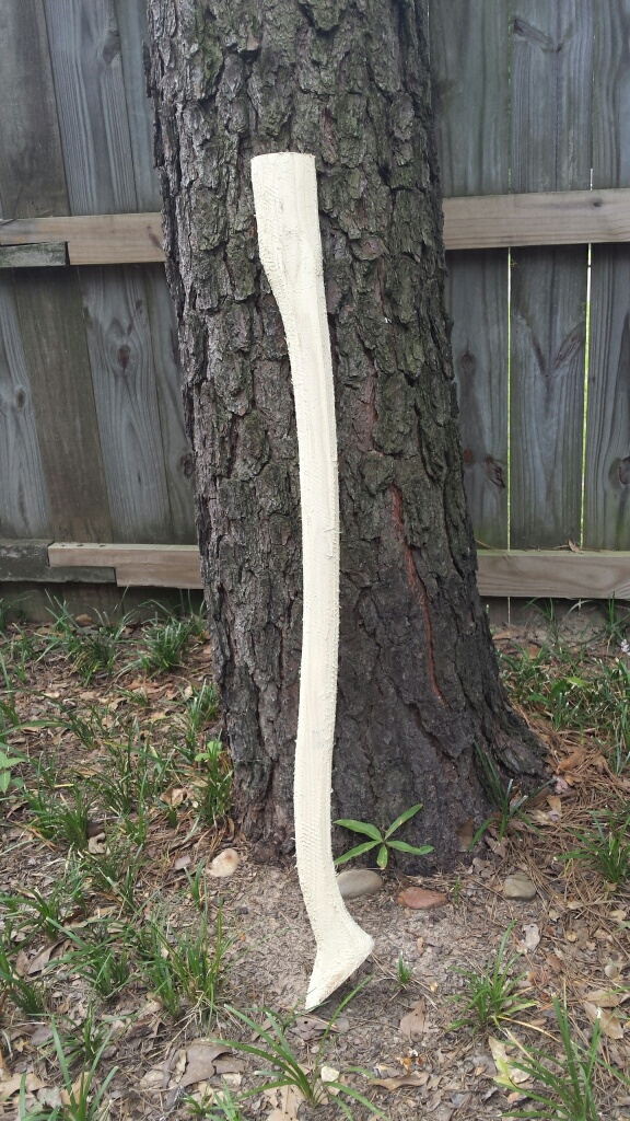

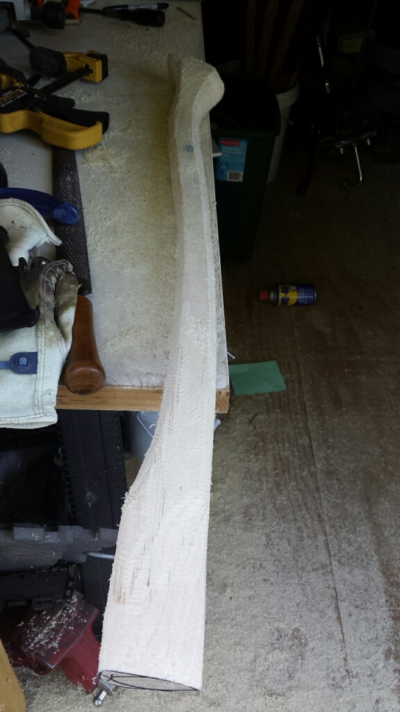

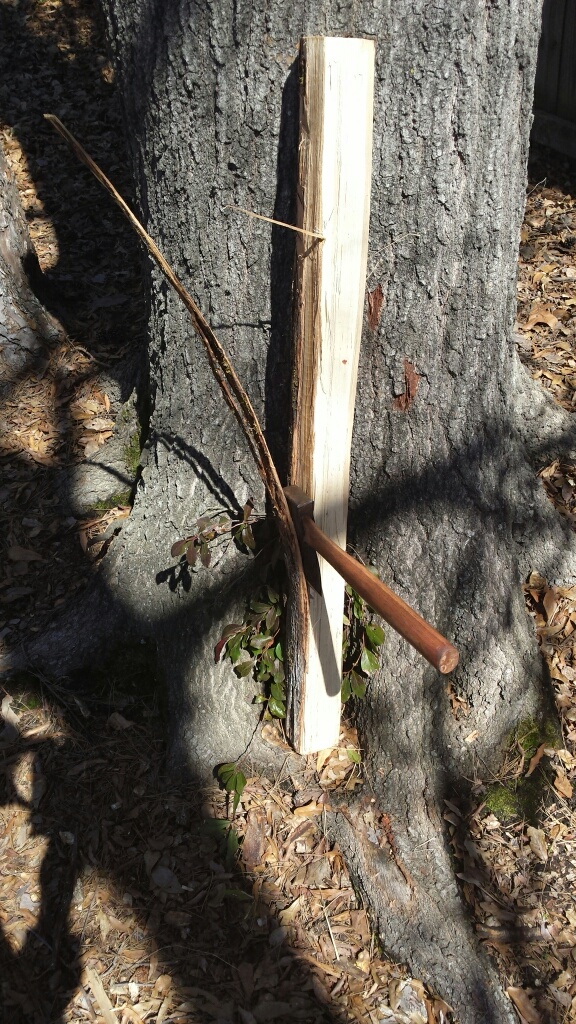

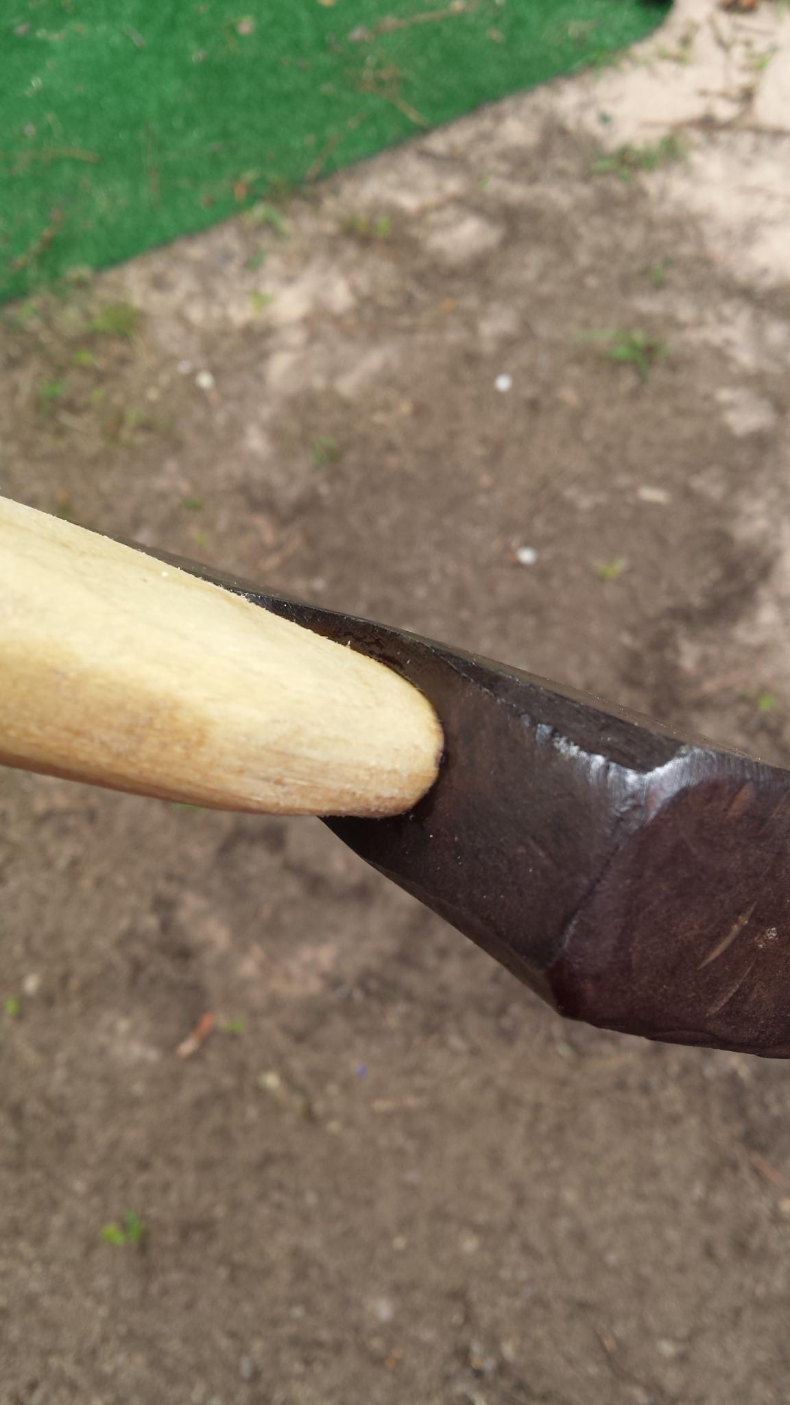

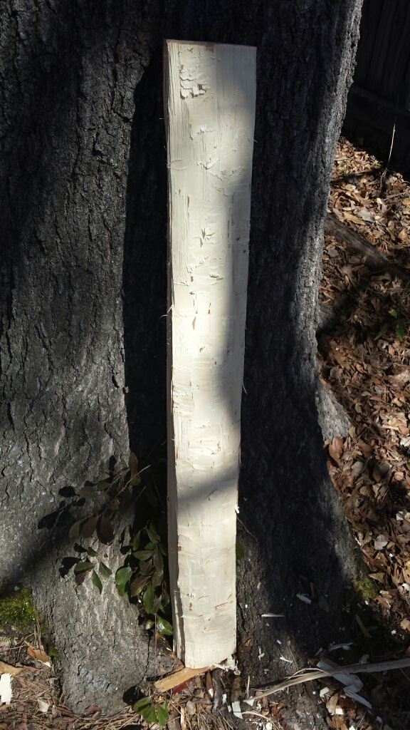

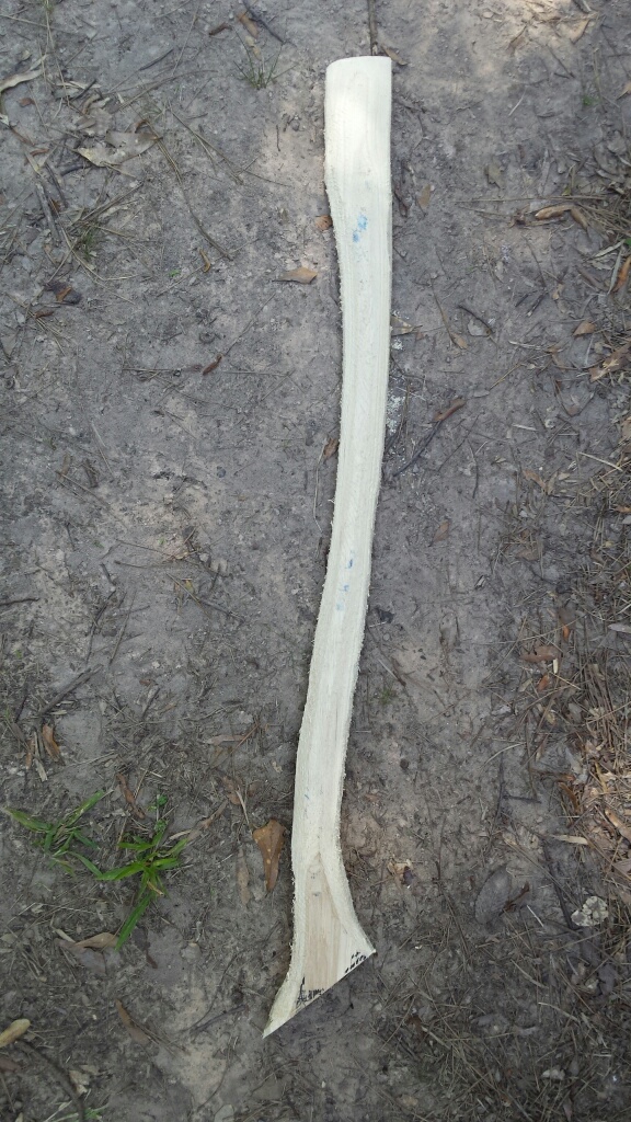

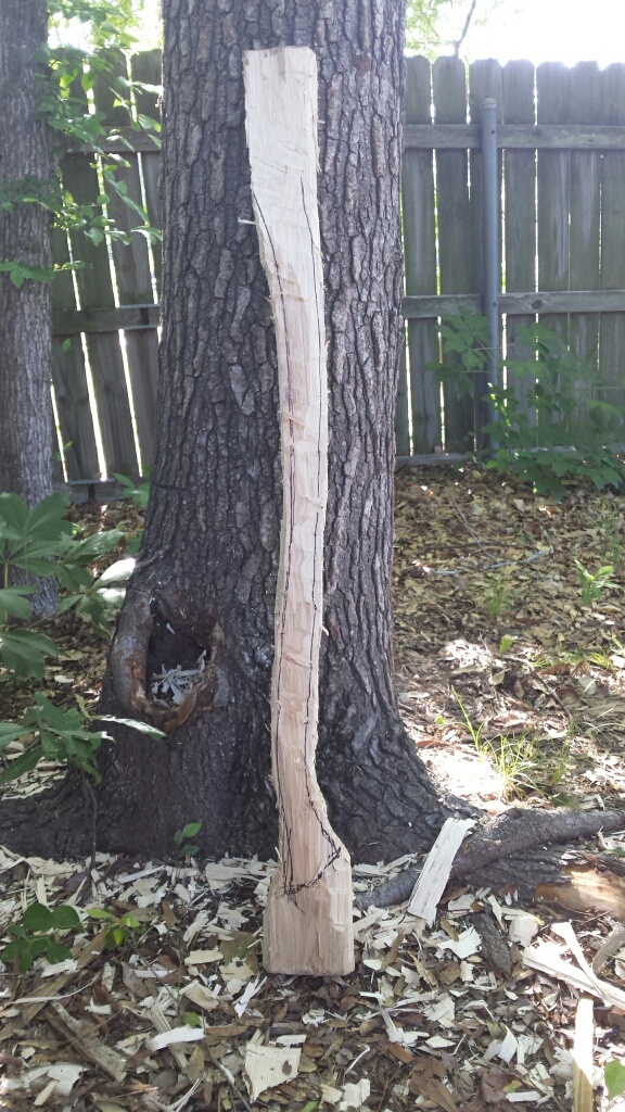

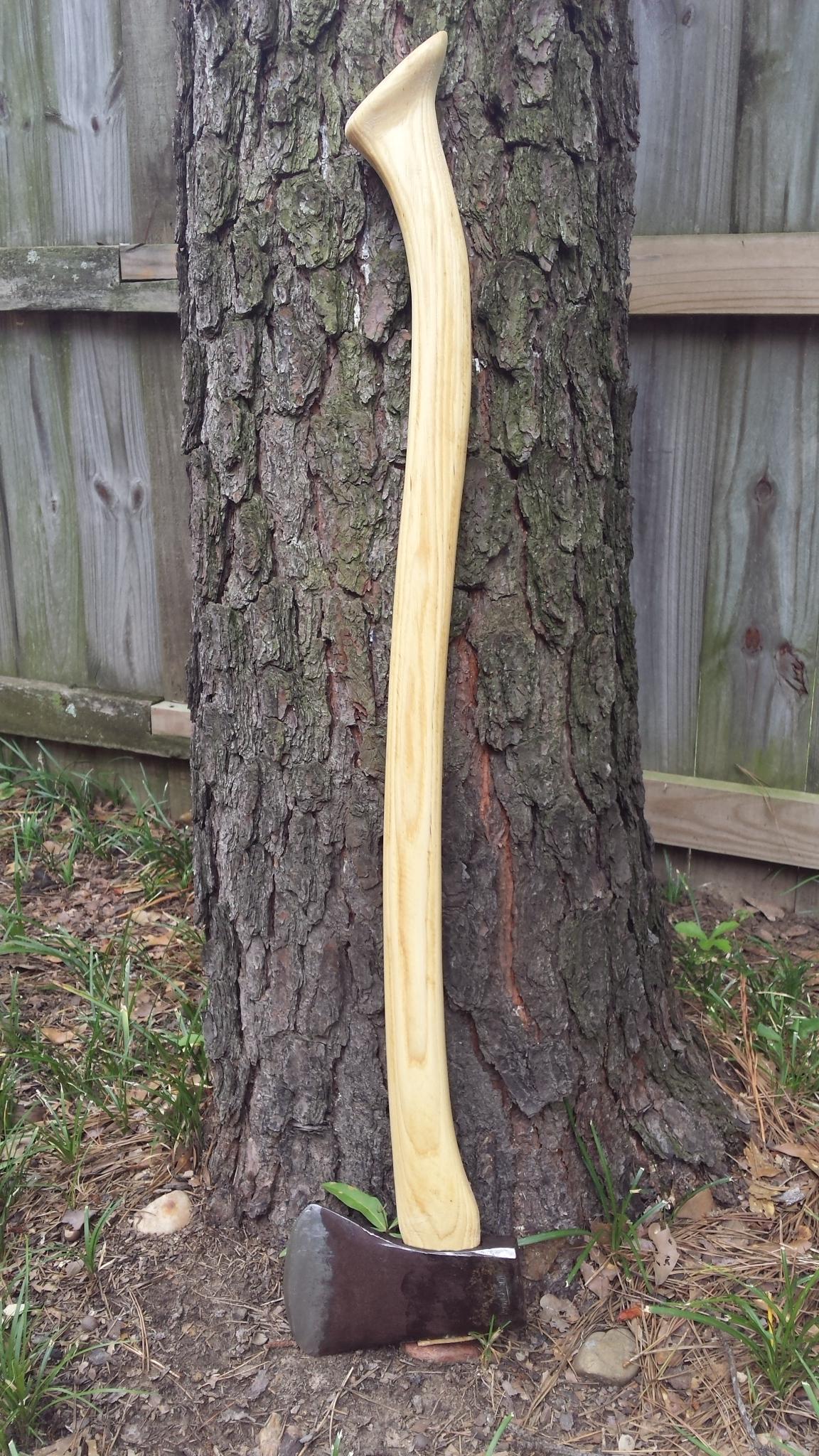

My 2nd using no power tools. Debarked with a hewing hatchet, Shaped with a hatchet, 3 rasps, large, medium, small, sandpaper and a hand saw. Actually 2 saws, mitre saw to cut the kerf and that wraps up the tools used. Hickory stave from the holler in KY, grown, harvested and riven by master carpenter Quinton. He is a stand up guy if there ever was one and best I can tell from past pictures a pretty good griller of pork.

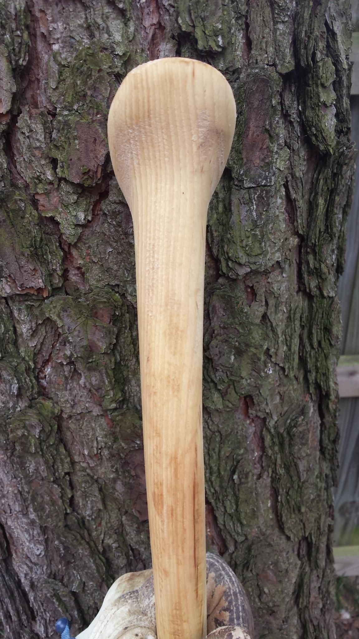

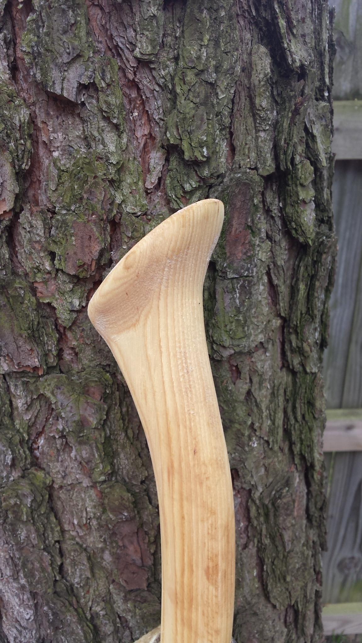

Head is a 2.5 lb Plumb national pattern. Handle is 34" from the end of my unconventional swell but as held in hand it's 32". A 28" haft on a boys axe is just too short for a 6'5" guy with big hands and i really love the feel of this handle.
Thanks for the compliments guys!
It's just an exercise in days gone by axe hanging and shaping to your preferences. I have a hickory tree in my front yard that has my attention but the wife isn't on board yet...
Fantastic work Rockman0! I like the way the swell came out. I prefer a little backsweep on the back of the handle to support your hand. I'm sure it makes for a fantastic chopper. I need to make another handle myself. I've just been too busy lately for much time in the shop.
