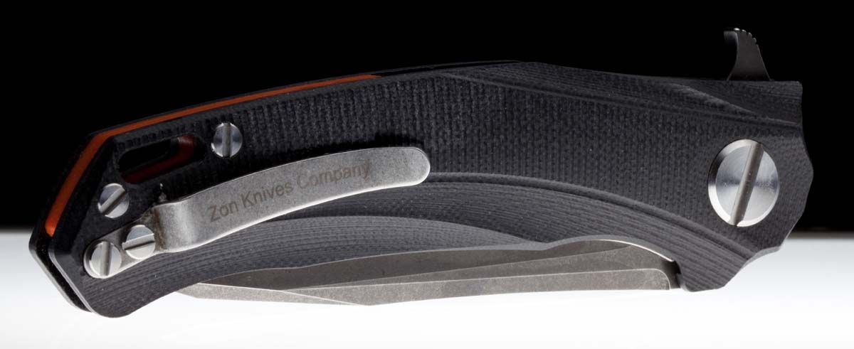

Just got this today, was keen to see how it looked in person as the blade shape as well as the handle contours looked great in the photos and in person it did not let me down, it is pretty great. Albeit a large folder
Closed: 5 1/4" long
Blade: 4" long
Blade steel: 440C
Edge bevel thickness: approx .023" so it's ground fairly thin down to the edge
It arrived moderately sharp, meaning you could certainly cut stuff right out of the box, but it could stand to be sharpened up a tad more and that will be attended to shortly.
I know a lot of people just have to have the newest supersteel on the block, while 440C has been around a long time, it's been able to get a decent edge out of it, as to this one's heat treat, time will tell, but at this price point, below $80 at several locations, it's not such a bad thing.
Opening, WOW this thing has a great detent setup that provides a very positive flipping action, the flipper does have some knurling to help that along.

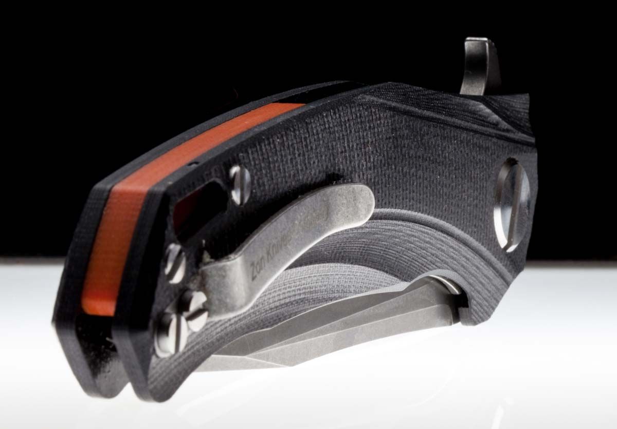

The clip is only right side tip up carry, I'd rather a more deep pocket carry type clip but not sure if anyone will be making something aftermarket as this does have a slight curve to it.
Hardware, all slotted screws, odd to me, my first with such hardware, I may try to locate some replacement screws for the frame and clip, but it's not too bad, the heads of the handle screws are slightly proud of the contoured G10 scales, but not near as much as some photos I've seen on line, so I was happy for that!
Here are some images taken tonight of this one;

Nice knife, glad to have her aboard !

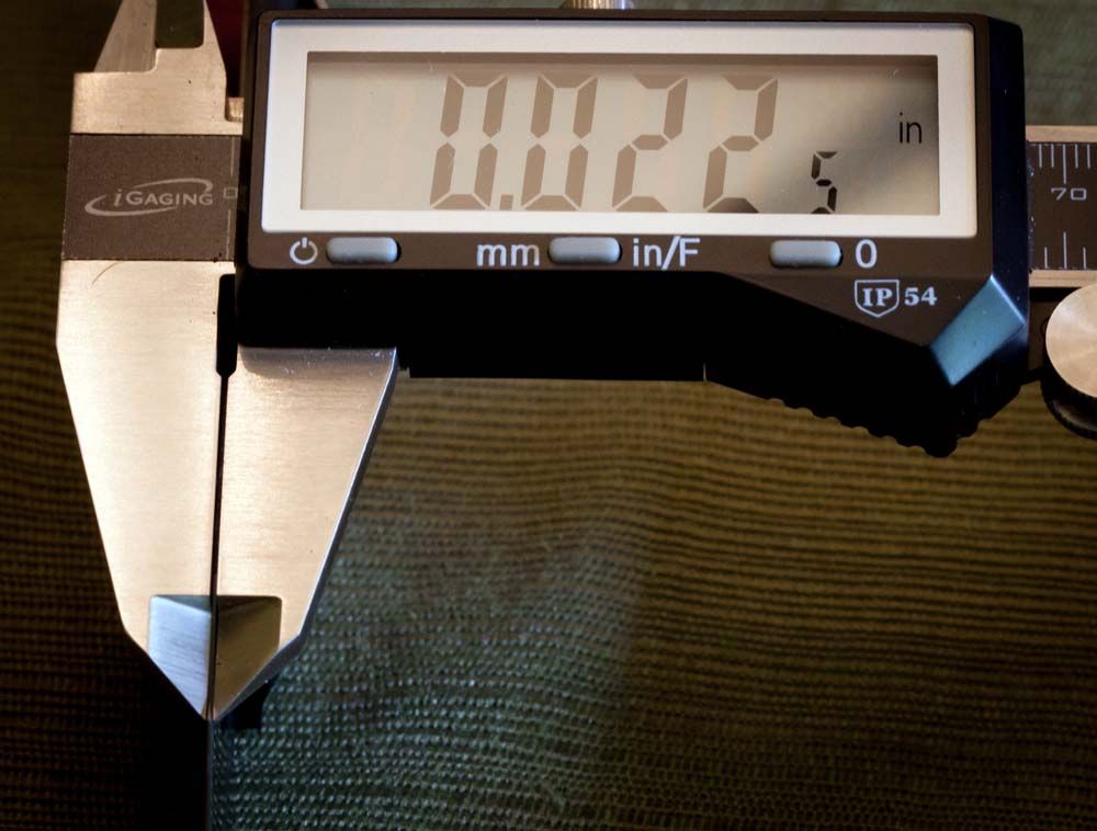

Also just finished sharpening her up a bit, the edge bevels were actually nice and even, no wobbles to remove so sharpening it was fairly easy and it does take a great edge.

Couple of shots showing the calipers measuring the edge bevel shoulder thickness after I had sharpened her up a bit...

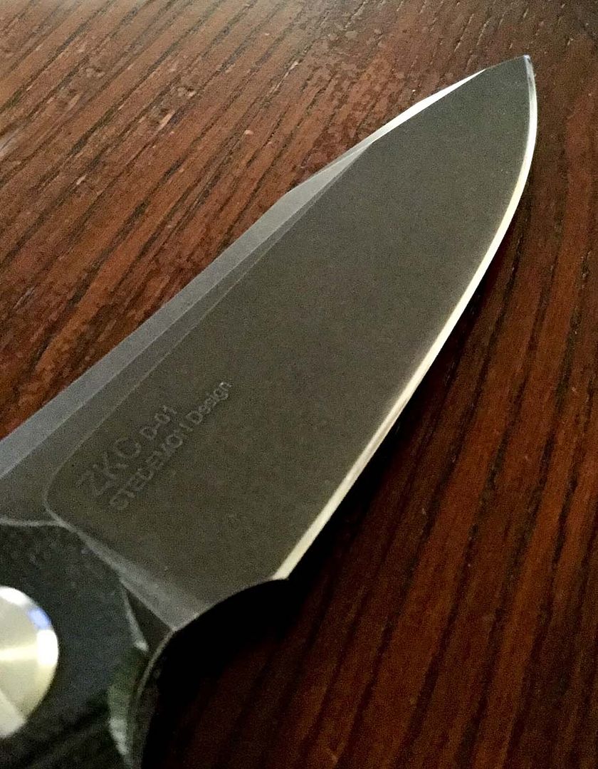

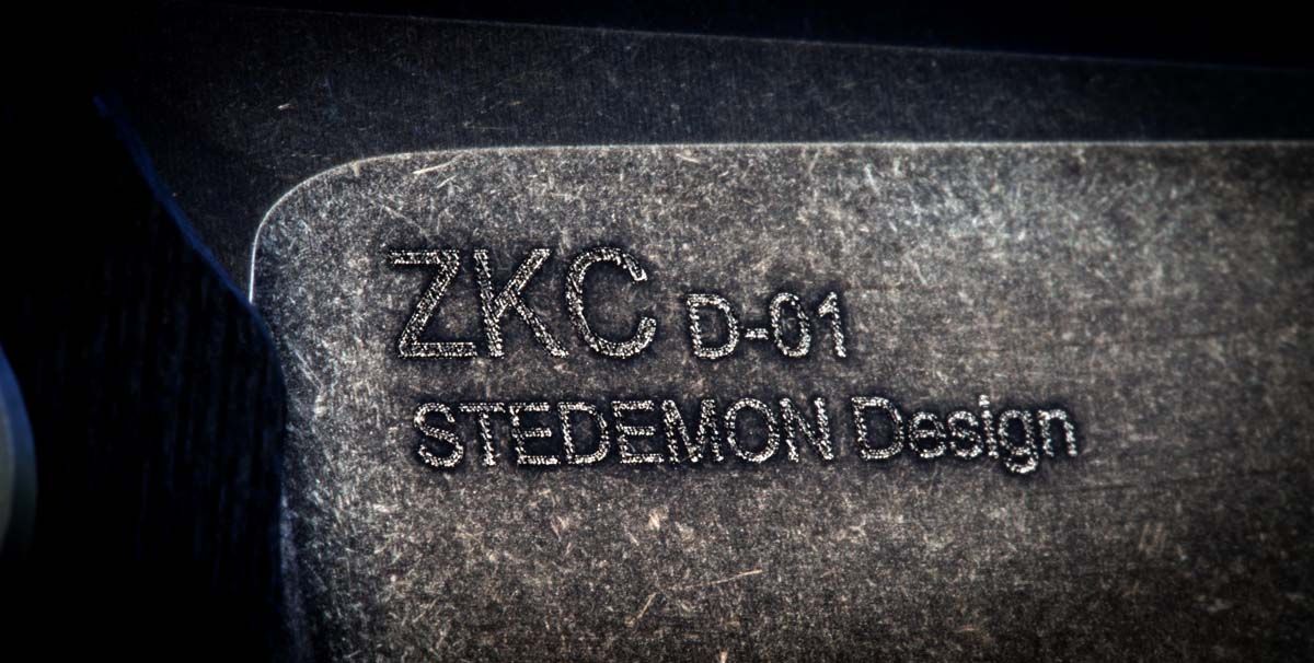

Their markings on the blade are raised above the grind of the blade, where most are etched down into the blade, you can almost feel the texture of the letters from this photo I just took of it;

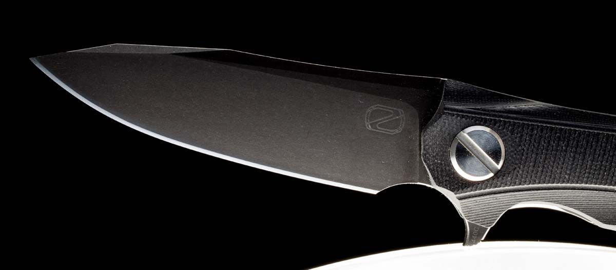

Couple more shots
