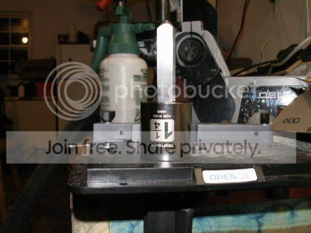

I use an arbor press and one of these. It's a 1/2" drive socket that fits over the ram on the arbor press. Isnt perfect, but it is fairly easy to get it lined up. I hold steady pressure on the handle, and hit the top of the ram with a dead weight hammer a couple times. if you do not keep the steady pressure, the stamp jumps. Ask me how I know...
Gixxer posted that photo a whole back and it got me thinking. The times when I have some problems stamping is when the ricasso is tapered. The stamp won't strike right. I took the plate from my arbor press and ground a slight angle to two of the lobes sticking out on the foot plate. It gives me two slightly different angles to hold the blade so the surface at the stamp is parallel to the stamp. It works perfect.
