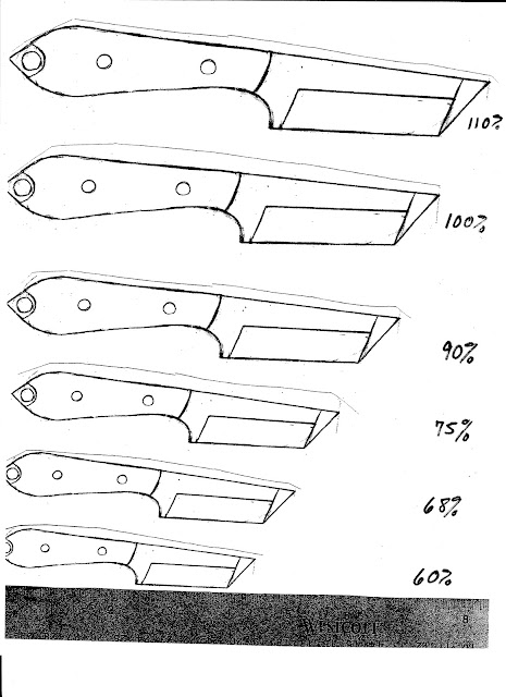

I have to rework the design a bit. It looked good on paper, but the tip was too fragile once I cut it out. I'm going to grab some mild steel today and play with profiles.
The initial prototype will be cut from D2. Like I said, I usually use O1 and A2 for everything and consider A2 a pretty tough steel. If Crucible's graph is true, 3V is going to blow me away.
I flip flopped back and forth over whether I wanted to show the design or not. I'm still not sure it's done yet, but here's what I have so far.
I like somewhere between 100% and 90% for the full size carry. I think 68% would make a sweet little necker.
truly glad you put this thread out there, i have had the same kind of hard use steel in mind for some time, and have came up with 3V myself, but this helps confirm it. nice little design there as well. one question on the pommel... is that pointed on purpose for smashing windows or for asthetics?
RR, it's for a window breaker, but it feels kind of gimmicky, to be honest. I'll do the prototype with it, but I may take it out of the final project. Also, I'm thinking of making the hole an oxygen wrench instead of a round hole. Not sure on that either.

Yeah, that's why I have never carried a window punch. I figure the fire guys will be there if I need to bust a window. Like I said, it's pretty gimmicky. I'm not going to include it, and didn't on the prototypes we are testing.
It's kind of embarrassing actually, as it makes me look like I'm new to EMS, which I'm not, and a little bit mall-ninja-ish, which I'm definitely not.
I had planned on giving a choice of orange or black scales. I'm planning on using the G-10 peel ply, unless someone gives me another option that is better. I'm all for rounded scales on a knife that will be used and in hand a lot (like a skinner), but I honestly think thin flat scales will be better for a mostly carried, less often used knife.
i'm in the same boat with the rounded handle, but i agree for a "mostly carried" as you say. i can't wait to see the finished product... post pics :)
