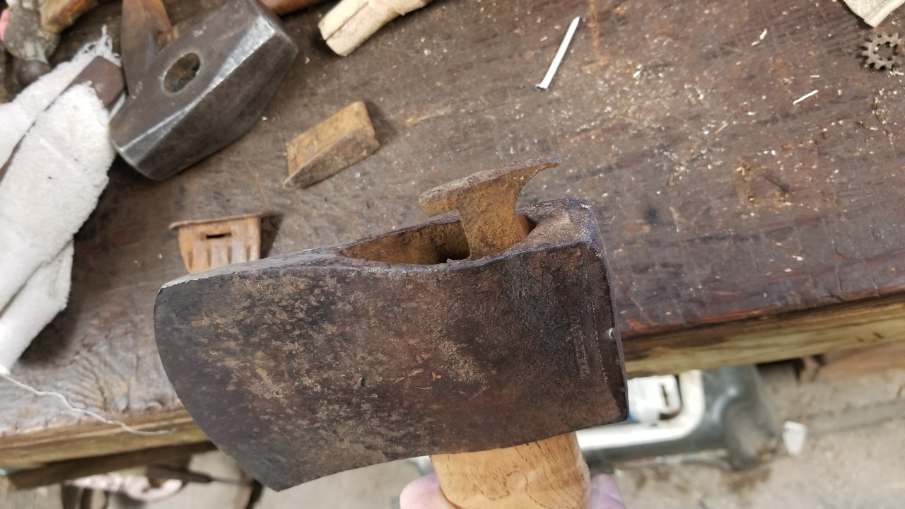

The ones i have used and come across have not been easy at all. I think that is the point because they won't compress or shrink. And having a full cap on it protects the tongue. This old Peavey double bit came with this one on it. It was horrible to remove! 15511571106976100106002603374439.jpg When I re-hung it on this haft I didn't remove enough around the outside of the tongue and i barely was able to smash it in there. This is probably the most secure hang i have because of it. I cannot even imagine how i would go about removing it. I would be interested to know who came up with the idea though. I know that some Snow&Neally axes came with them new. It was a long time ago though i don't know the time period.

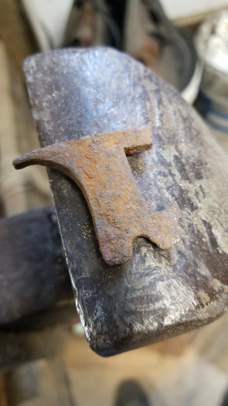

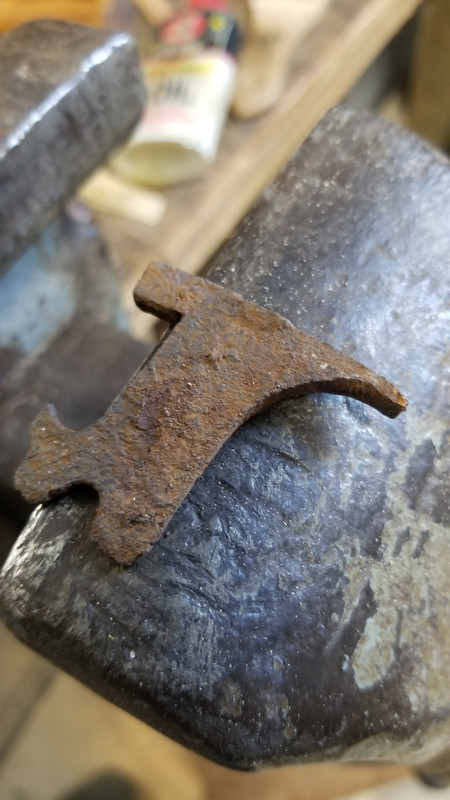

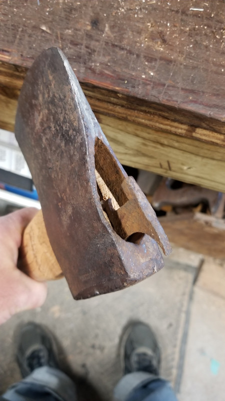

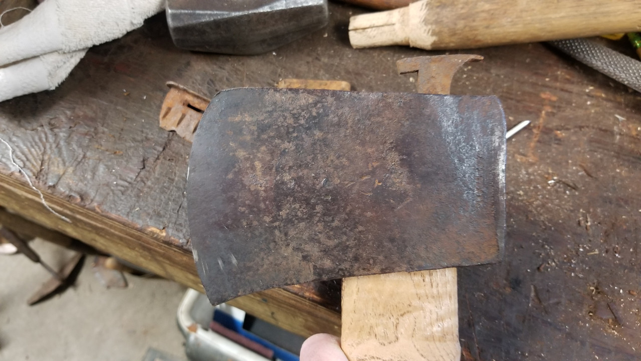

This style, the NO.2000 SAWILCO. This is the most recent style example I just removed a couple weeks back from a badly worn but beautiful boys head, Connecticut. Thanks to JB. As it is still a work in progress I will eventually post up photos when rehung.
I don't have pictures of the wedge but if I return home before nightfall I may be able to post a picture of what's left of it.
So was it seated so you could get something under the wedge to pry it out easier than a normal wedge?
The variety in shapes is really interesting. I've seen some, not others.
It certainly made it easier with all that metal protruding to grab into and get under to start the Wedge Wiggle and then pull out. It was in there pretty good though. Sadly I didnt take any pictures of the head...as usual, I get motivated and just start into something.
