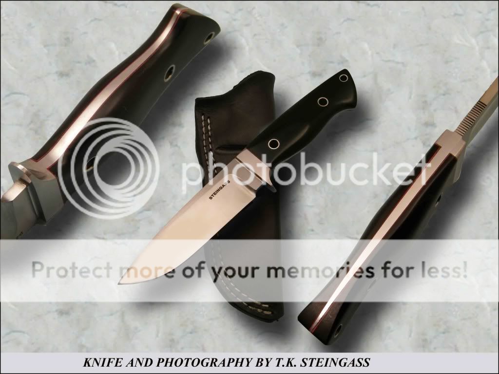

Les Robertson asked me to work up a George Herron influenced design to carry exclusively on his website. Including Les' input, this is the first prototype I came up with. I named the knife the Steingass AK. The AK stands for Ass Kicker ..... my nickname for Les because of his martial arts background. This knife is a substantial handful - the specs are below. Included is photography using some of the techniques that Jim Cooper has graciously shared with us. All comments welcome.
Best regards,
TK
3/16" D-2 stock
HT to Rc 60-61
9" OAL
4 1/2" Blade length
1 1/4' Blade height
Black micarta scales
Red liners on tapered tang
416 SS furniture
400 grit hand rubbed satin flats
400 grit cork belt finish hollow grinds
Thumb serrations on spine
8/9 oz leather sheath
