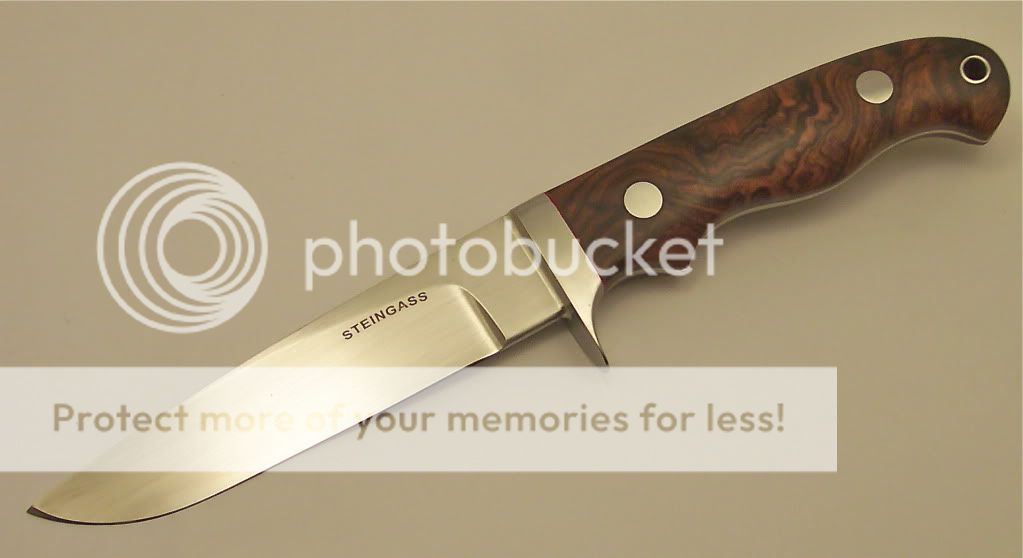

Hi Fellas:
I built this Silent Hunter with a blade profile slightly different based on a customer's request. I hope you like it!
Best regards,
TK

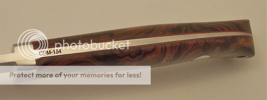

5/32" CPM-154 stock
HT to Rc 60-61
9" OAL
4 1/2" hollow ground blade
hand rubbed satin finish
Presentation grade Desert Ironwood burl scales
Red liners on tapered tang
416 SS furniture

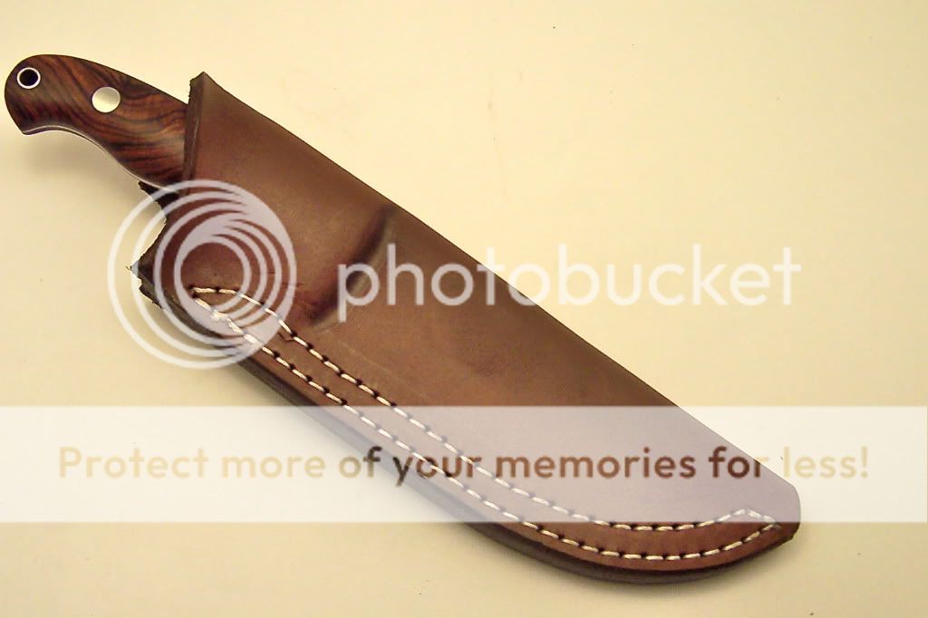

9-10 oz Loveless style sheath

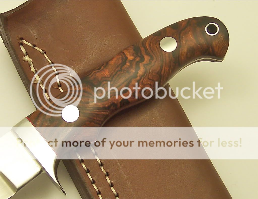

Really beautiful knife and sheath. Nicely figured desert ironwood. I like the use of the stainless furniture. It seems to me that most often you see desert ironwood with brass furniture. I really like the look that you achieved with stainless, and how it seems to balance with the finish on the blade. For me it's one of those knives that I look at and like it a lot right away. Looking at it more closely the reason that it is so immediately pleasing becomes obvious.
Bravo.
