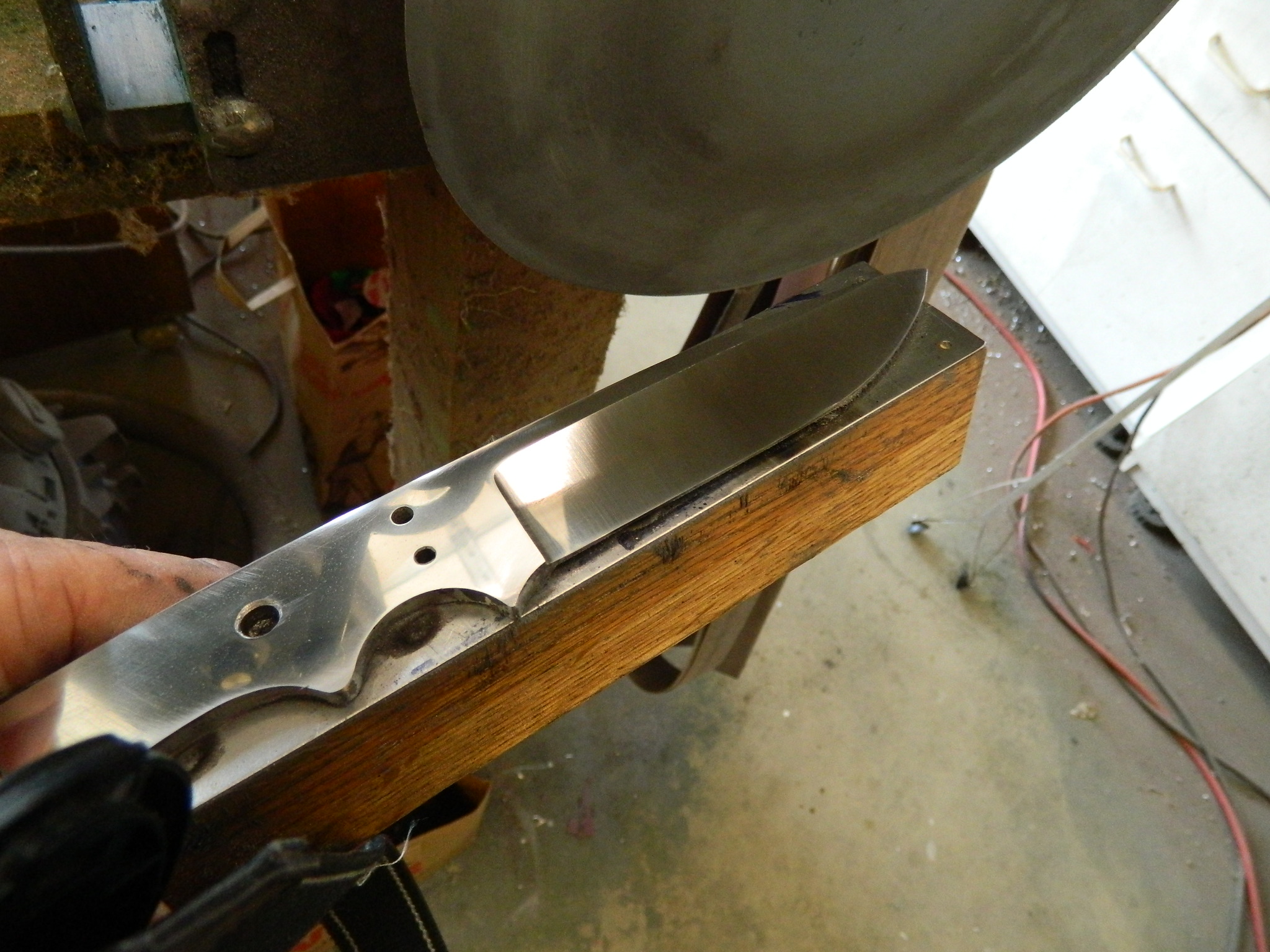

Last night I was excited to grind a few paring/petty blanks. Everything was going well, grind lines were looking nice and I felt like I was really getting how to even up the plunges symmetrically when viewed from the edge etc.
Then I started to get tired. I was also running out of time until my wife and kids showed up and then its supper, baths and stories.
And I started to rush. Dig into the edge of the belt instead of taking my time. Push hard on the disc to try to true up that bevel. Continue to hog instead of taking the time to cut a new sandpaper sheet for the disc.
Things started to go awry but I made myself walk away before there were any catastrophic failures. The grind lines became uneven on 2 of the blades. Not a big deal as I'm taking them to FFG but I was frustrated as keeping them even to advance my grinding skills is a top priority for me now. I was getting cocky because going FFG I believe was hiding mistakes.
Anyway, I'm pretty confident that I can only grind for a couple of hours before I get tired enough to start rushing and messing things up.
How long can you guys crank on the grinder?
