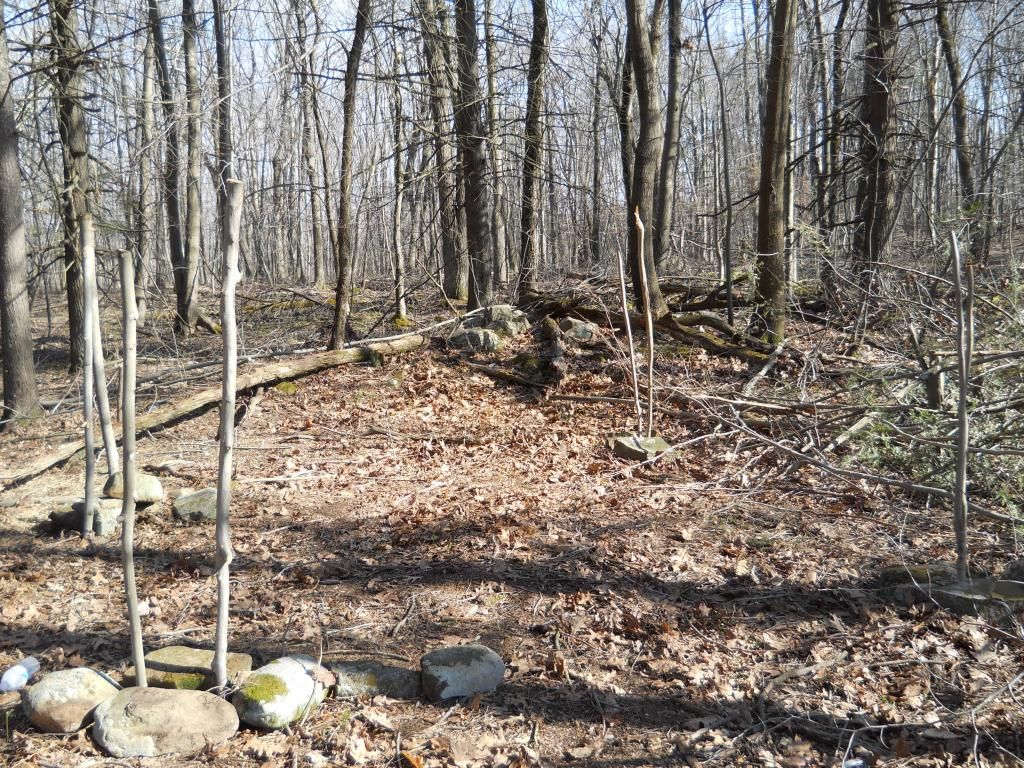

This is the start of our shelter. or rather, the frame. We built this template by hammering stakes in the ground. We also started the foundation here.

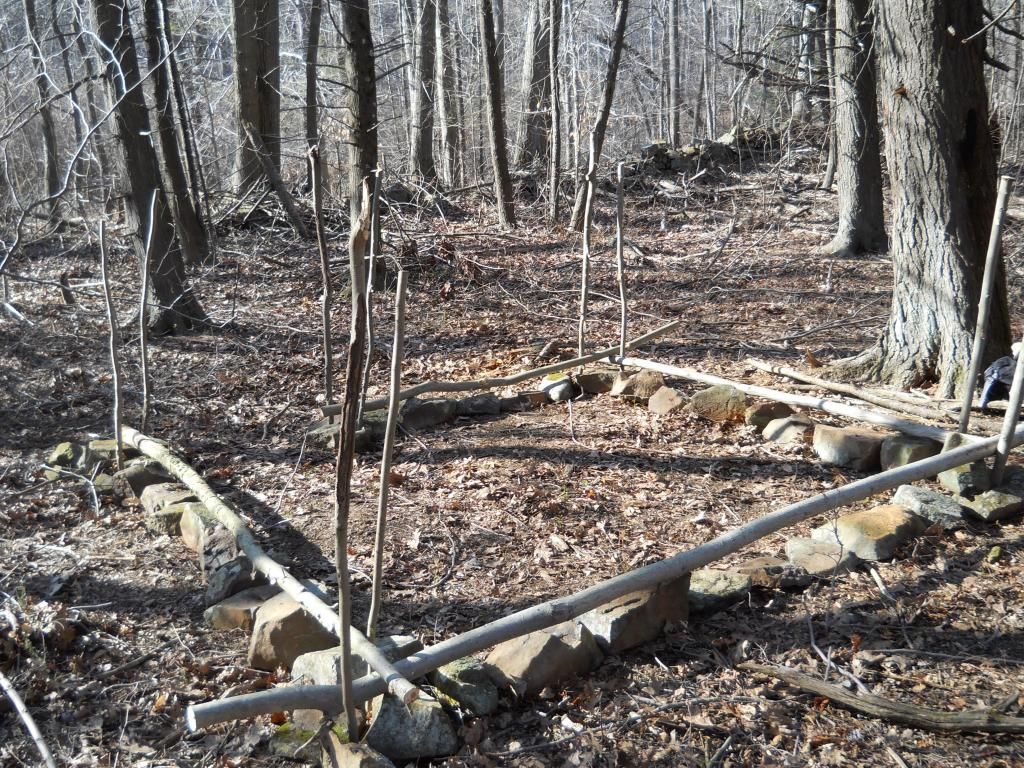

Here we finished off the stone wall, and also added the first layer.

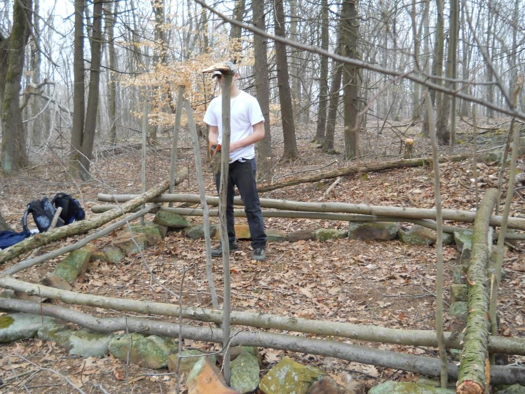

Added some more to it, with my buddy Jacob inside.

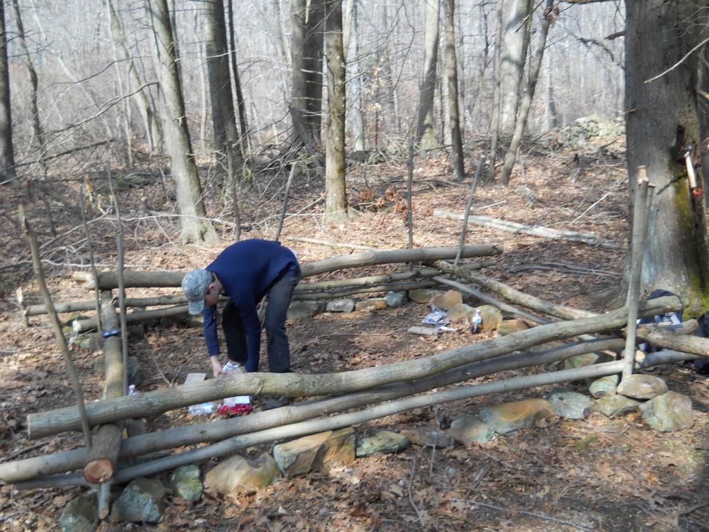

It was a cold morning, as you can tell by the long sleeves. We added another layer, and I took pictures as we finished up lunch.

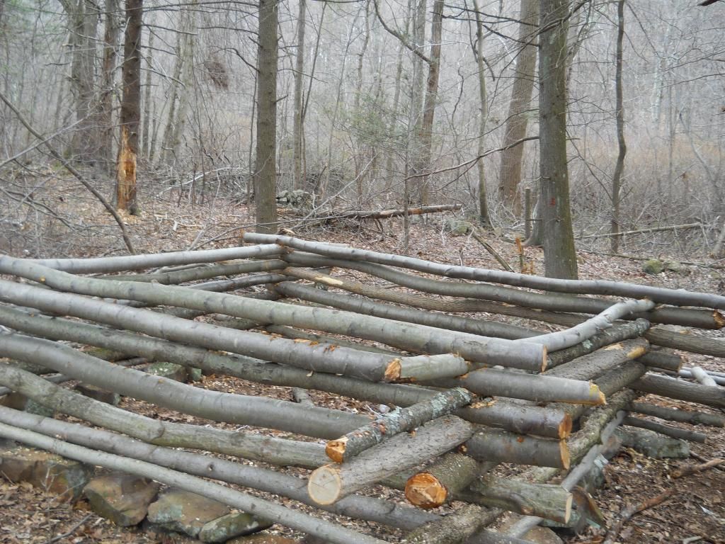

DSCN0172.jpg.html

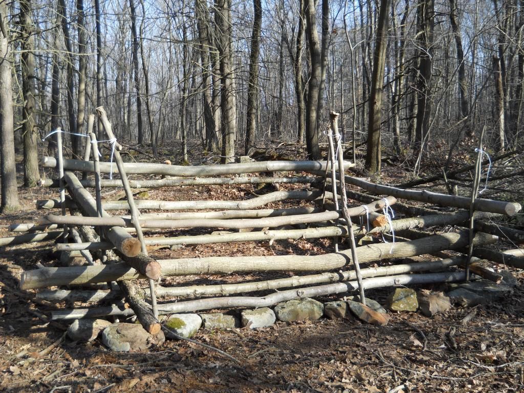

We're done with the walls right? nope. We realized it would be best to notch the logs, it would be more stable. So, off all the logs went and we started notching away at every log. Eventually we came up with this...
DSCN0246.jpg.html
Ah, much better. It was very stable at this point, we actually ran into the walls to make sure they were sturdy, and needless to say it felt like a brick wall.

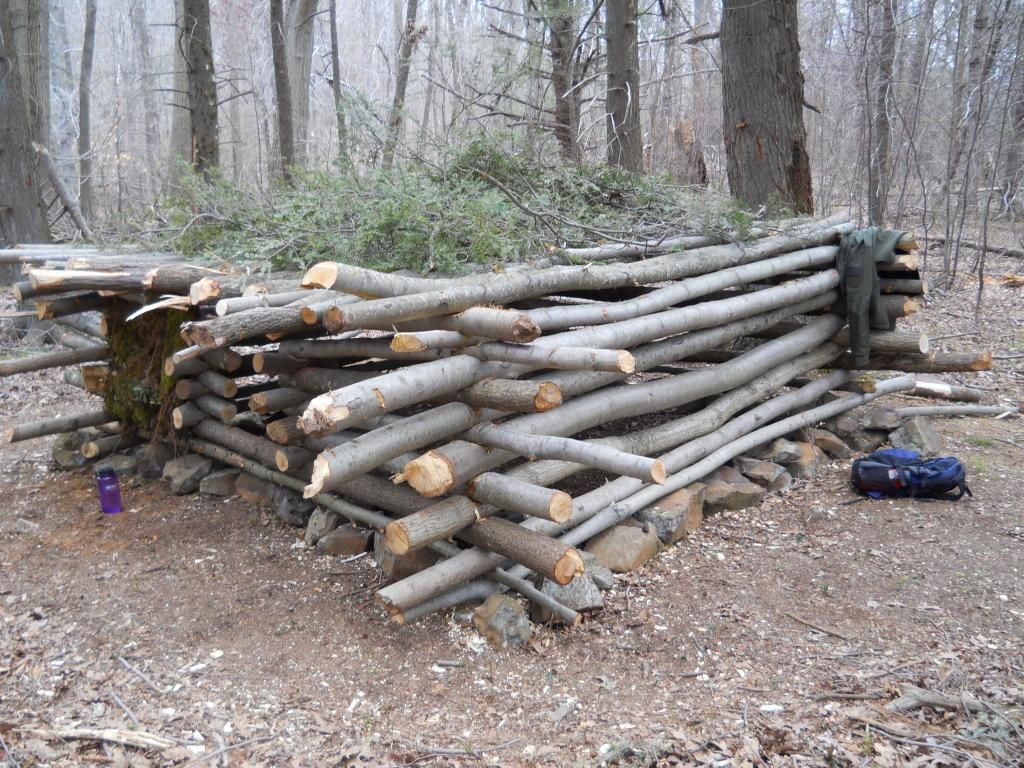

DSCN0257.jpg.html

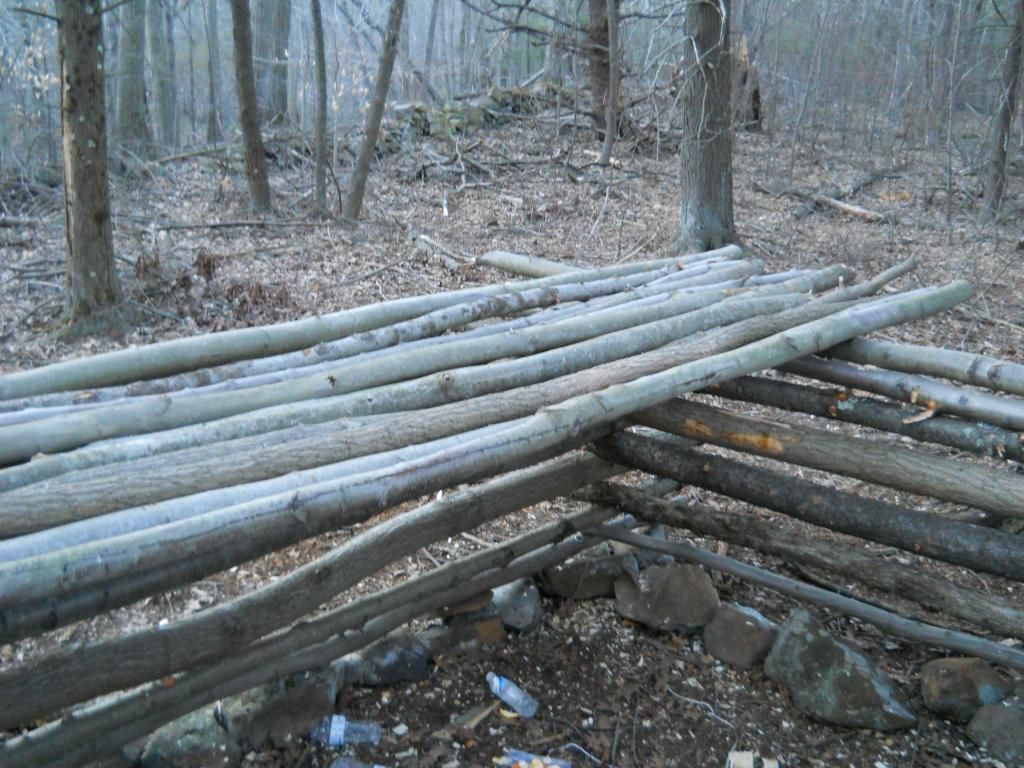

We used the tops of the trees for the roof, and did this all the way across. We also cut the door with a saw, and braced the frame with small wooden blocks that we notched. Here is a picture of it looking more complete.
DSCN0293.jpg.html
You can see the door partially, but it doesn't go all the way to the ground. We didn't need it to go all the way to the ground, and It started getting difficult to cut, so we left it how it was. We finished off the roof with more beams, and added some pine boughs to the top. This is the last picture I have of it, but we added about 2 feet of leaves to the top, which made it very close to waterproof in the rain. We left the walls as-is, but could be finished at any time. I built a fireplace inside, it was like a modified dakota pit. I dug down and made a square hole for the shape of the fireplace. i lined the sides with rocks and a big one for the top. I then dug a trench out of the shelter, and covered most of it with rocks and sealed it with mud until the end, so we had a chimney. I built a small wall out of rocks around the chimney to block the wind from pushing smoke into the inside. I then dug out the front of the fireplace so that you could put wood in, and so it could get enough oxygen. We tested it out, and it worked like a dream. This was now the fall, and it was starting to get cold out. We slept out one night that got below 30 degrees, and we stayed warm with the fire going and a sleeping bag.
