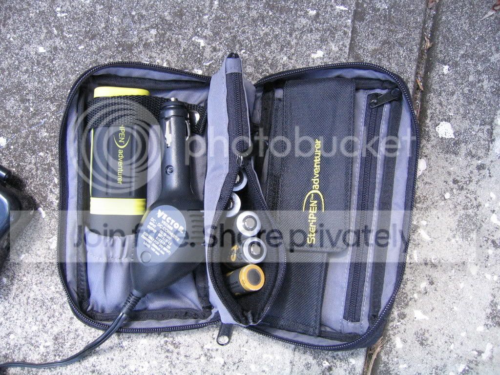

I use one, I have the adventure model and use solar cells in the field to recharge the batteries. If the water is really dirty I use a Katadyn combi water filter or a bandanna (which ever I'm carrying) to filter out the mud. The main thing is you want to let the heavy sediments fall to the bottom so the light can kill them. There is one guy in India drinking raw sewage from a river using the thing and didn't get sick but used several doses before he drank it. UV has been around for a long time and has it's merits. I never got sick with mine but I've never tested it drinking fro a sewer either. Just lakes and such. Take a look at these threads, some are positive as well as negative, but in the end if you do some googeling you'll find out it does work. The earlier models a long time ago (years back) had problems with lamp breakage and have been dramatically improved. It's all in what you want. You can carry salt (Miox) or batteries (steripen) or tablets or pay an outrageous price for this http://www.lifesaversystems.com/techinfo.html . Oh and if you did decide to get one, don't waste your money on their solar recharger, get a 20W or greater solar cell to charge your batteries, power GPS and other things. Their recharger is extremely slow.

For anyone out there who has used one of these critters, what is the advantage over a good filter in terms of speed, cost per ltr., safety, and weight? Were those 123 batteries I saw in the picture?

Yes they are CR123 batteries, that is what the adventure uses. And Turbid not Turbulent, I used the spell checker too fast. I haven't got sick yet from using it yet, I like it because it's quicker than boiling and no filter clogging. Yes you could say what about the lamp breaking or batteries, but everything has something that could happen to it. You just have to field yest the heck out of things to see if they fail.
By the time you pack all of those batteries, solar cells, and everything else, you can take a katadyn pocket filter and 2 hand fulls of micropur tablets and still weigh less than all that. I didn't realize it required all of the "extras" - neat concept but maybe not as practical as it could be.

Relying on batteries is never the first and best option of course - but if you can recharge and have the means of resupplying oneself with spares later on then it isn't that big of an issue - besides we all need batteries for other tools - lights, radios, etc. I'm not sure why the need for all the batteries...according to the literature and other sources two sets of rechargeables is all one needs and one could suffice with only one set. I believe it good for several hundred zaps before needing a recharge...one could recharge when doing other tasks or while on the move. Once settled in a secure area you have the luxuary of being time rich and could religate back to a primative method of filtering or purifying depending upon the circumstances saving battery life.

You don't have to pack all that stuff up, the kit is designed for a unlimited travel plan. It's designed to keep all the electronics and equipment running until something fails. For a normal run, just carry the amount of batteries you need. The cells power my GPS up without batteries as well as charging lights, radio, cell phone unlimited as long as you have a sun. It's extremely overkill but it's set where I'm not Dependant on anything. You could carry a General Ecology or what have you and pull your pump out and pump away or fill your bottle from a stream and push a little button and wave a magic wand and wala drinking water. It's up to you how you set your rig up, I'd carry the same rig even with a Miox or a regular filter for what I use it for.
