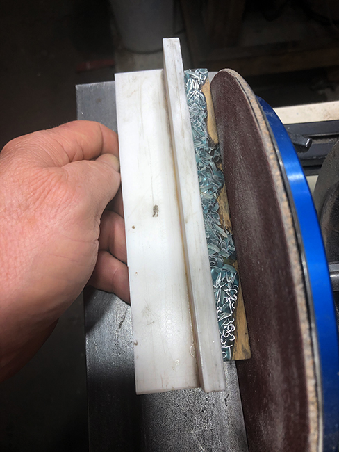

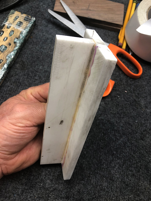

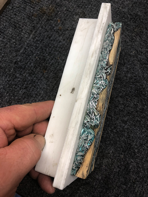

A couple of reasons. I really didn't like having my fingers around a sharp spinning object even with a push stick. It can also be quite messy especially with resin based scales. I much prefer the way I'm dong it now.
Made a jig from HDPE.
A couple of pieces of double-sided carpet tape to mount the scale.
And thinning with the disk sander.
Before you mount the scale you can scribe a line around it with a height gauge and sand to the line. You can get a very accurate thickness that requires very little sanding on a granite plate. The 9" disk sander is a wonderful addition to a knife shop. I have the magnetic disk system and three disks. Usually 80, 220, and 400. Change out the disks in about five seconds. A 9" allows you to use standard size sandpaper sheets. Using feathering adhesive, when the sandpaper wears out peel it off and cut another sheet. If you don't have a disk sander you really should consider getting one.
