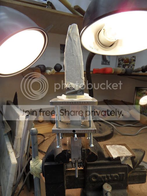

here is a clamp I made to make sure the guard (your face plate) is glued on straight.
I check it with a triangle and adjust by turning the screws. When it is straight in all directions I let the epoxy set
