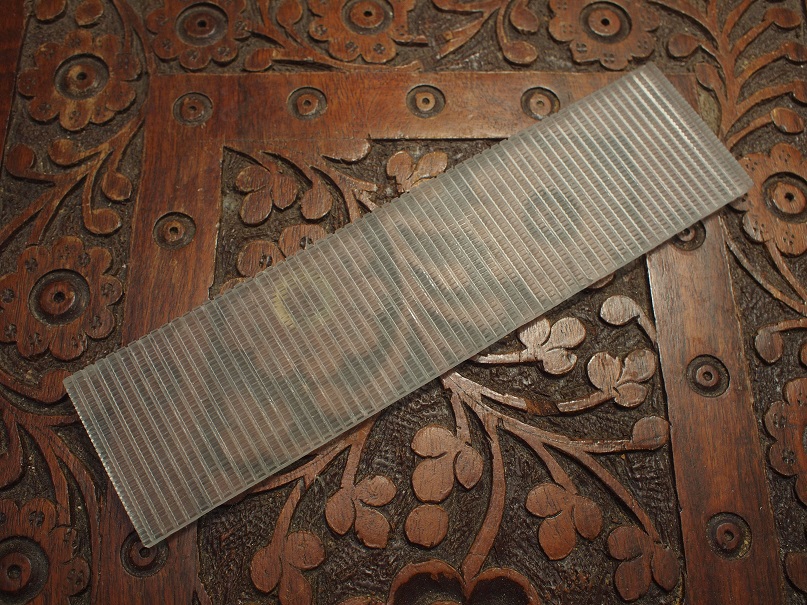

Hey there, HH. :) Glad to see you're still here. Dang, son, you haven't been idle! I took a peak at the new washboard. I had to order me one. Folks, if you don't know what the original washboard looked like, check this out. This one is mine; I took the pic just now:
And here's the new and improved version!
They've come a ways since the earliest proof-of-concept plates, that's for sure!
I keep my prototype near the workbench and use it from time to time, still works great. But the new ones are pretty slick - I think you'll like the improvements.
