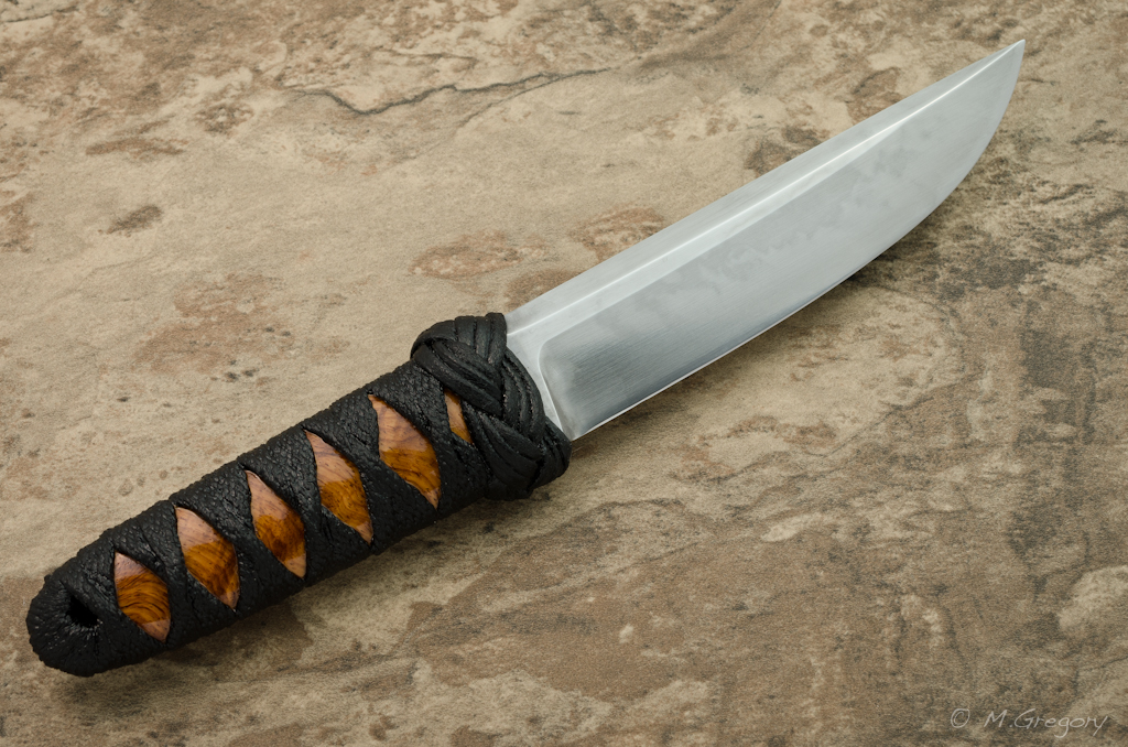

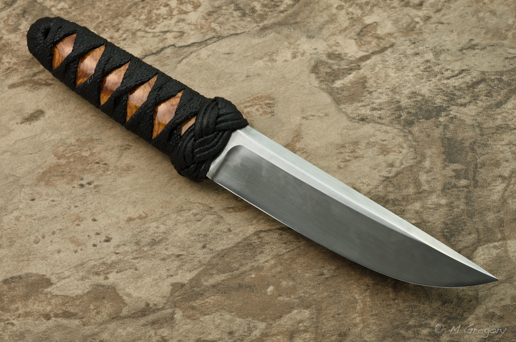

This one's awfully different, though. As much as I love the 'traditional' stingray and Japanese style wrap, I crave the warmth and beauty of fine wood.

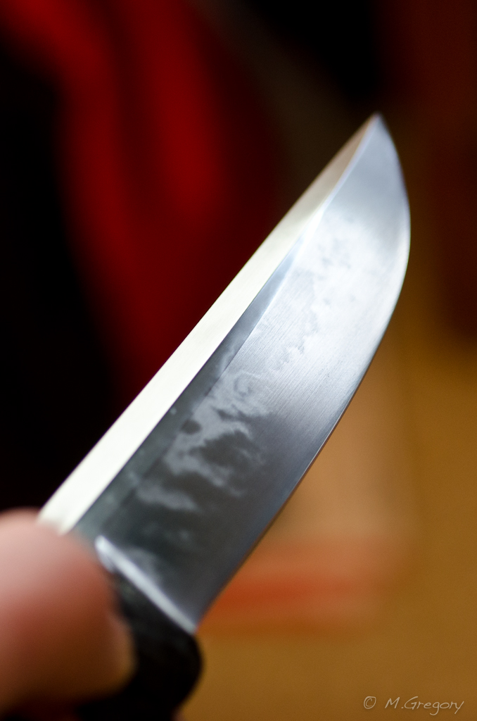

I almost abandoned this blade, as the spine detail I had played with didn't seem right to me. It sat on my bench for months, until I started making the others I showed in a previous thread. For some reason, I grabbed this blade and commenced putting a nearly sharp bevel on the spine (which I've since flattened a bit). Lo and behold, when I continued up the progressively finer grits I noticed a hint or wisp of hamon scattered randomly over the flats. I'd shot for a fully hardened blade, but 1095 usually has other ideas when it comes to this. This time it really worked out, as it adds a really different detail, I think.
The tang is fully tapered, and yet again just a pinch longer than most like this knife to help with wider hands, however it feels completely different due to the ovoid-shaped Amboyna scales under the Japanese style wrap. Fills the hand very nicely, without adding so much mass that it feels slow or heavy. Plus, it's gorgeous to look at (well, I think so, as does at least one other gent I know!).
Pardon the horrible shots of the hamon - no matter how I try, I just can't capture that elusive trick of the light properly with my camera.
Thanks for looking, and all comments welcome.
I think it's gorgeous to look at, too.
Great grinds,good idea with the scales under wrap, and that 1095 hamon's so delicate.

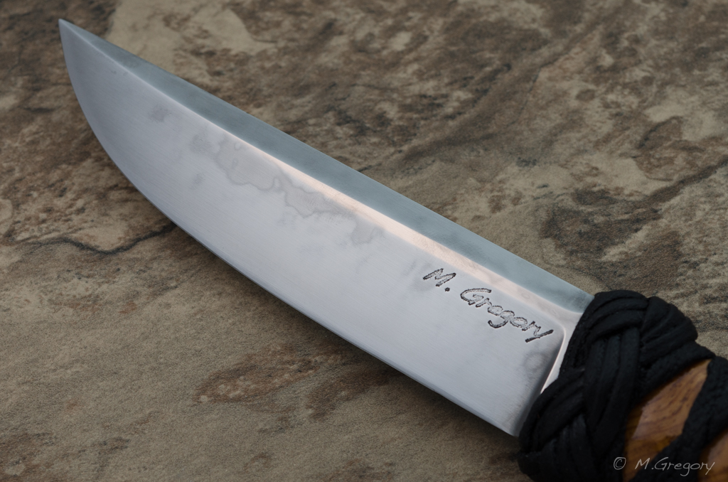

I really like this one. Graceful but also very strong looking. Am I mistaken that the grinds are different on either side? I looks like there's no flats on the signed side.

Tapered handle looks great with the wood.
Very nice
I like the other one you posted, but I like this one more. It seems to me a more traditional blade shape which I find appealing. Nice work.
A chiseled grind shobu-zukuri?
Hey Stuart! Trick of focus - they're identical on both sides - I've got the aperture on my macro lens pretty wide open as I'm trying to hand-hold the subject and need as much shutter speed as I can eke out. If you look really closely above the 'y' in my last name you can see the start of the flat. If I get a chance I'll snap a shot of that side so you can see it better.

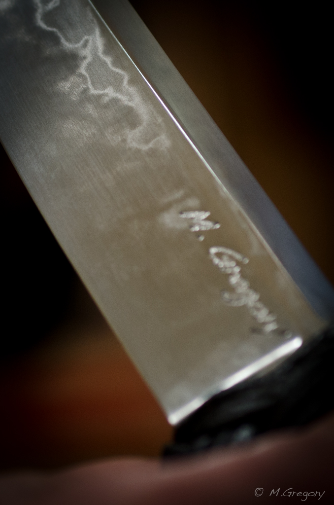

This look better, Stuart? I tried to catch it's reflection as best as I could to highlight it - it really does disappear, as the bevels for it are nice n' soft.
