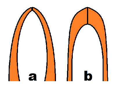

One thing I've noticed going over a bunch of pictures of commercially and amateur built ponies is that the thickness of the clamping surface seems to vary greatly.
My newbie guess would be that larger, lumpier projects would be better held in clamps like "a" picured bellow; and thiner, flatter projects would be better held with "b" pictured below.
For the folks with a lot of experience, is there one thickness you prefer?
You may be right about lumpier projects and clamp A. I think most of the one's I've seen tend to use the wider clamping surfaces because it spreads the clamping force over a wider area. I would think this makes it less likely to leave clamp impressions in the workpiece. Also with a wider grip it makes the workpiece less likely to shift in the clamp and possibly marring or marking the work. Just about all the ponies/horses I've seen have the clamp blocks glued and/or screwed to the upright arms. I suppose you could make a set of wide clamps and narrow clamps that attach to the vertical pieces by screws or other removable means so you could swap them when necessary.
