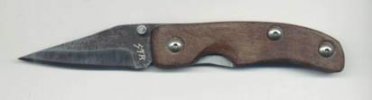

I made a knife for my brother years ago when he was still very young. My dad told me to make it so it was a working knife but nothing too awful serious that he could actually hurt himself bad with which was tall order in hindsight.
I used an old cross cut saw blade that I actually had tested and it came back to be 48 Rc so it was pretty soft for a blade. It looked like a knife, worked like a knife and could sharpen a pencil but it wasn't good for much else, maybe opening mail. It had walnut scales and for all practical purposes was nothing more than a mock up or prototype of sorts but he loved that thing and carried it for years until it disappeared one day never to be seen again.
STR
