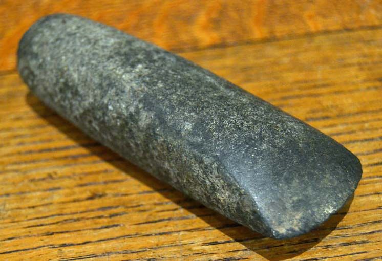

The axe head from dad's collection was at my best guess from recall - 1" thick at head, tapering over 5 1/4 " to rough point, blade 1 3/4"
Ebony. Looked hand hewn.
I can ask for pics, ruler included, if helpful. Don't care if my remembrance is shattered by reality! Humble![]()

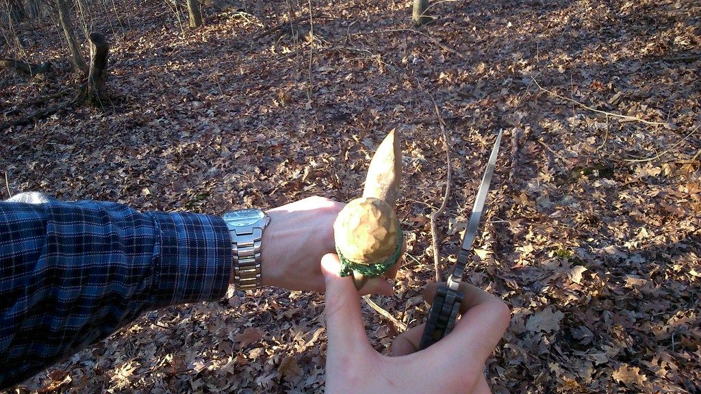

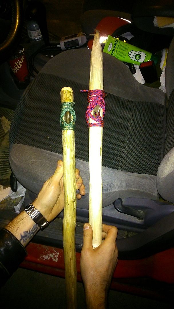

Looking to buy some stone in a bit to make some more...I think agate would look really nice. :thumbup:
Dude, an agate made into an axe head would look awesome!
I tumble and polish rocks regularly and have seen some pretty outstanding agates, and their pretty hard to.
It takes much longer to grind away an agate than say, some old parking lot rock.
Pics are always good.
I'd definitely like to see however many examples people can provide.

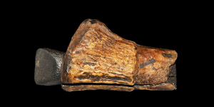

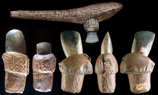

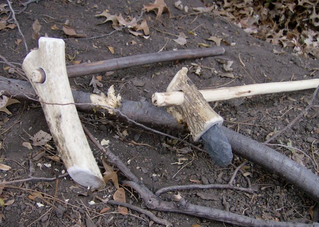

The haft, i.e. the handle of the axe, was carved from the split wood of a yew tree. A nearly right-angled branch growing out of the trunk was used. The axe blade is held in a slit in the haft with birch tar. It was then bound in place with narrow strips of leather.
Using a replica of the axe, it took just over half an hour to fell a yew tree.
Good looking dino choppers stabman! :thumbup::thumbup:
