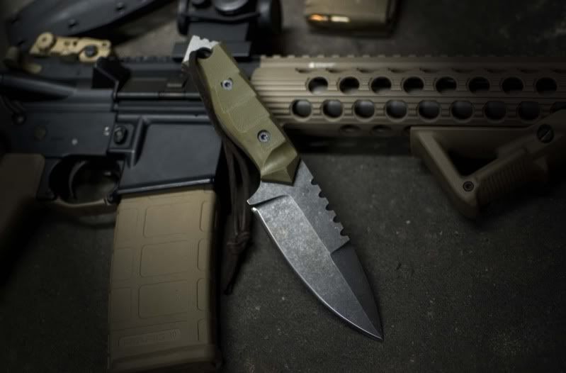

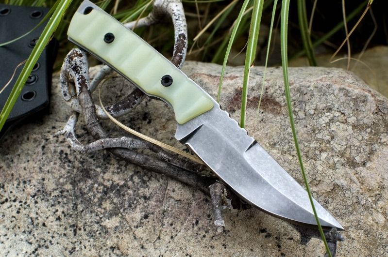

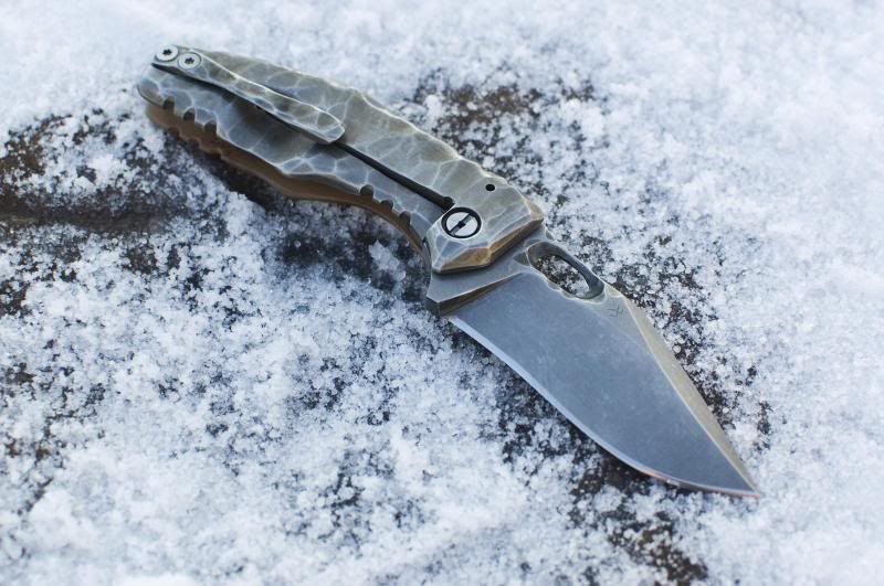

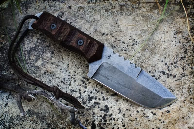

This is my process. I grind with blaze 60 grit, trizact 160, trizact 100, trizact 45, then medium scotchbrite belt. I soak in boiling vinegar or a quick acid etch then into the tumbler for 10-20 minutes for more texture or around an hour for a fine stone washed texture. I use the 20 lb harbor freight tumbler with ceramic media from McMaster Carr. This is a few pics of my results. Good luck.
What media do you use from McMaster Carr? There’s three types and different sizes for each. I’m just wondering because yours looks relatively aggressive and I really like it. I’m also really new so help would be appreciated.
