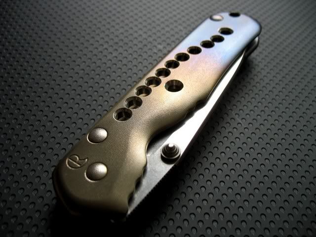

agree 100%:thumbup:, but one way out of the total uniformity is to anodize the handle to a different colour.
personally I prefer to "melt" the handles, apply an orange peel finish and anodize it to a grey-brown.....
or my favourite...to texturise it.
