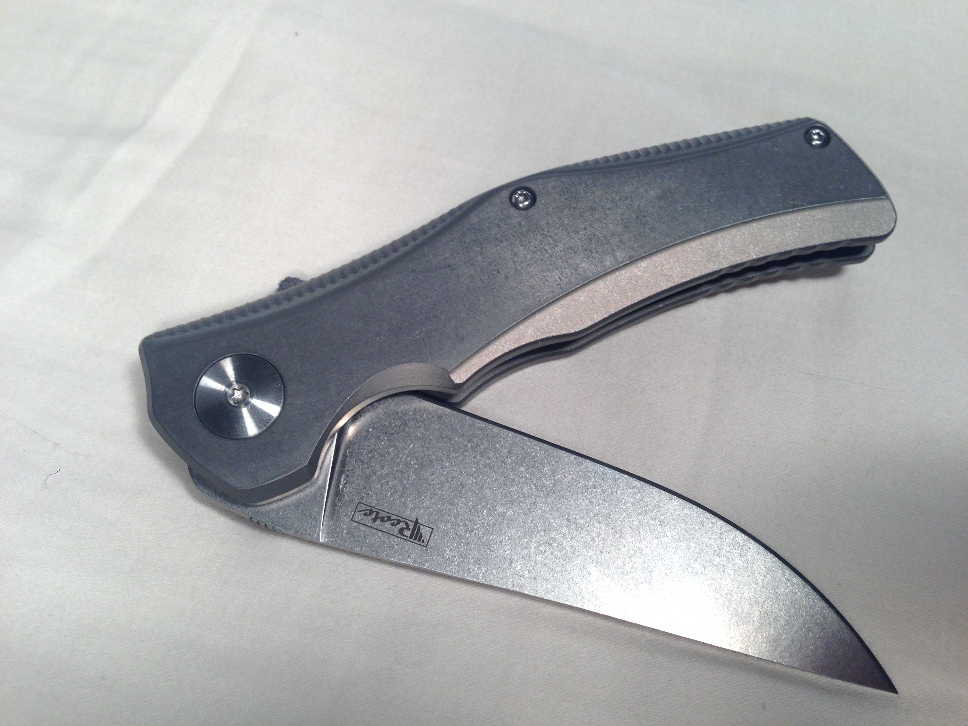

So I picked up a vibratory tumbler and some ceramic media, and figured I'd have some fun with my Reate Franken-Hills. I thought you guys might like to see the process and results.

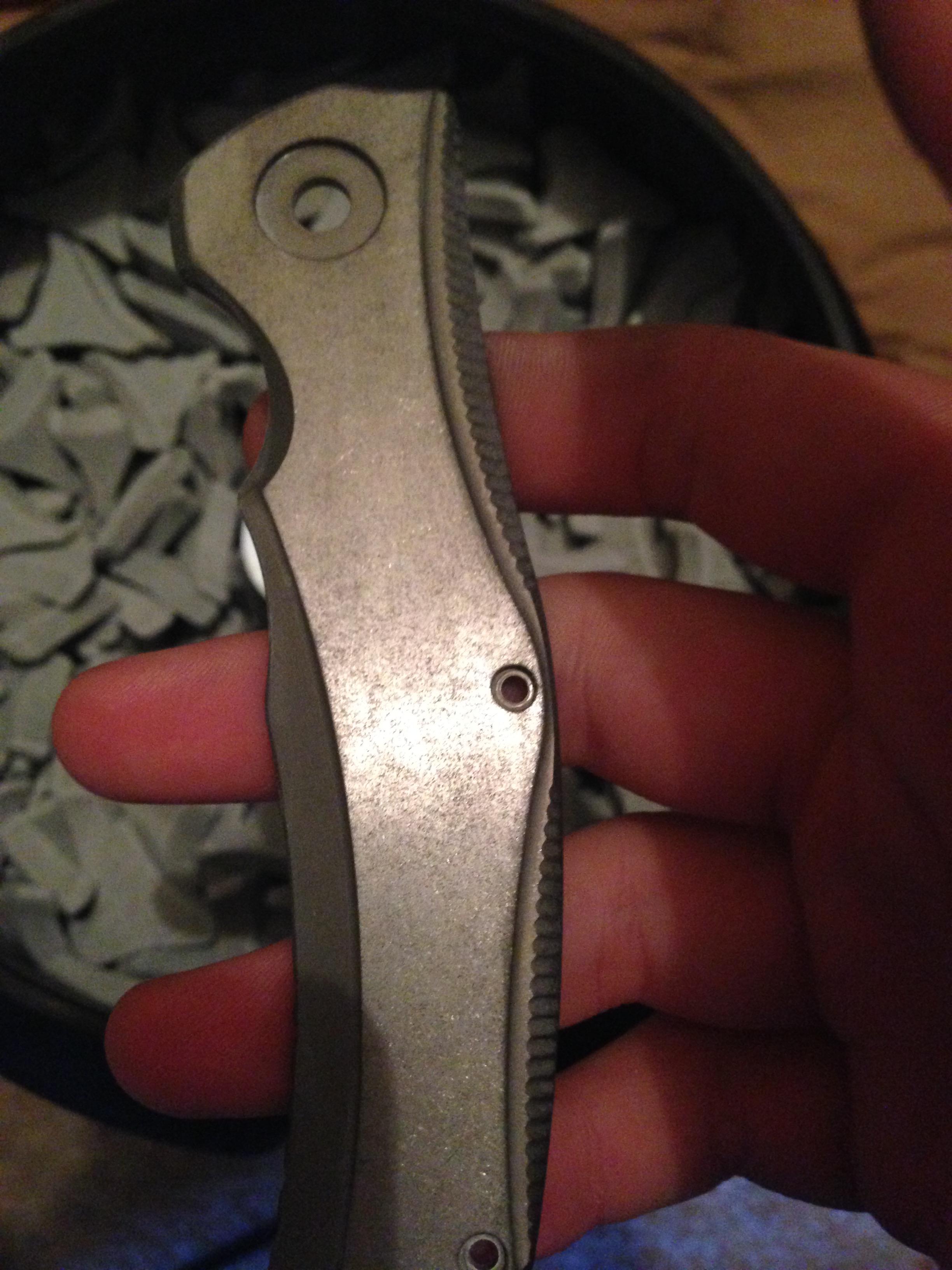

I started out by giving the flats a hand rubbed satin finish, and then sticking the handles in the tumbler for 1 hour.

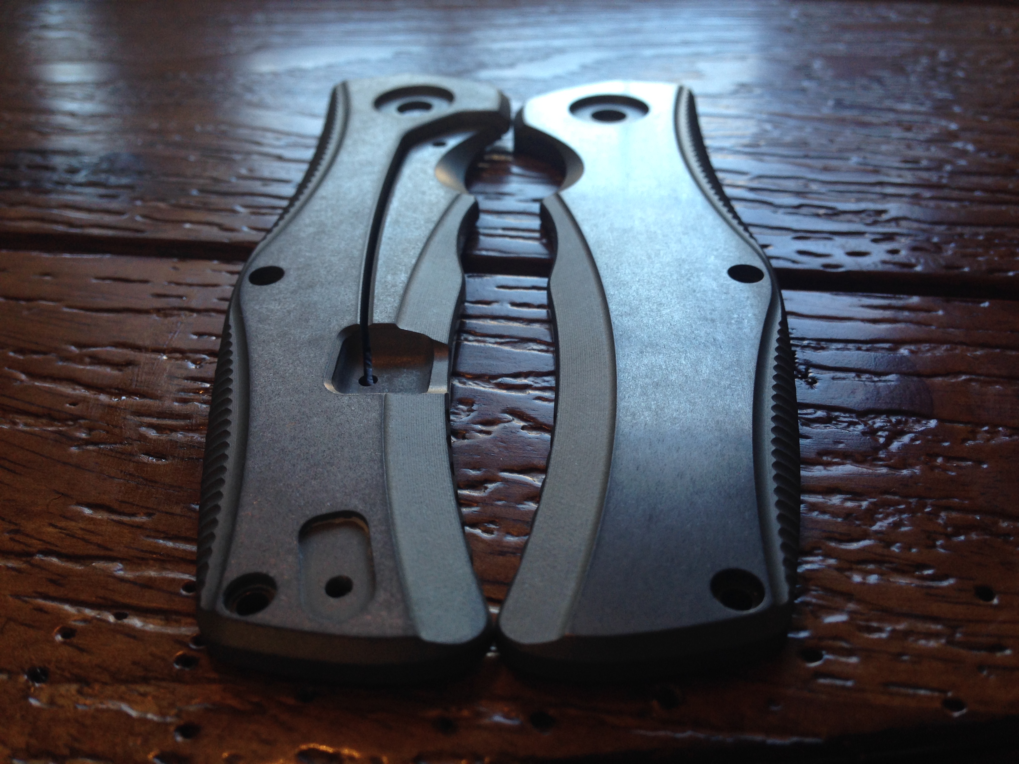

You can see the finish is a little rough, so I figured I'd polish it gently to brighten the finish a little. Here I have the scales side by side, one rough and one with a bit of a glossy finish.

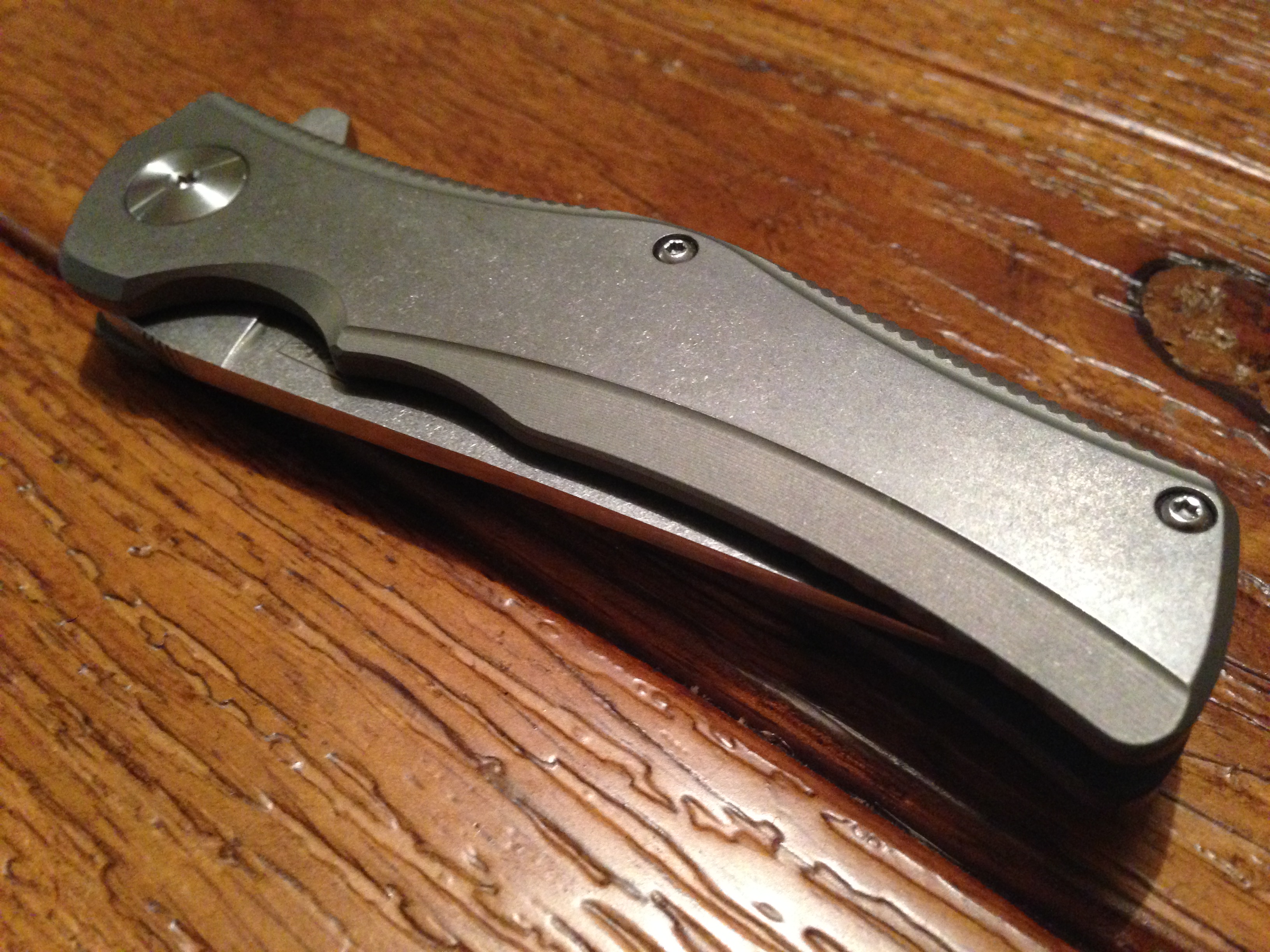

The glossy finish caught the light much better, and feels smoother as well. Overall, I'm very happy with the finished product (but not that happy with my photography skills )

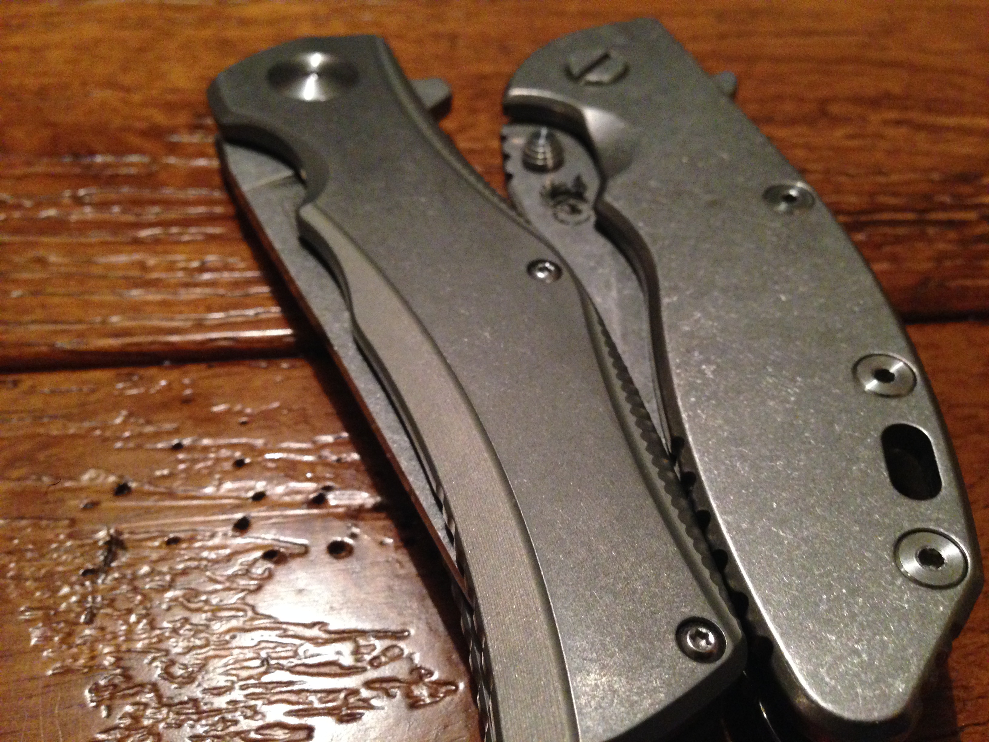

I do have a question for the more experienced stonewashers out there! My favorite stonewash to date is Rick Hinderer's. I have a side by side here with my full ti Hinderer - does anyone have suggestions for media/process changes that might yield this type of finish? You can see the Hills has a slightly darker, more uniform appearance.
