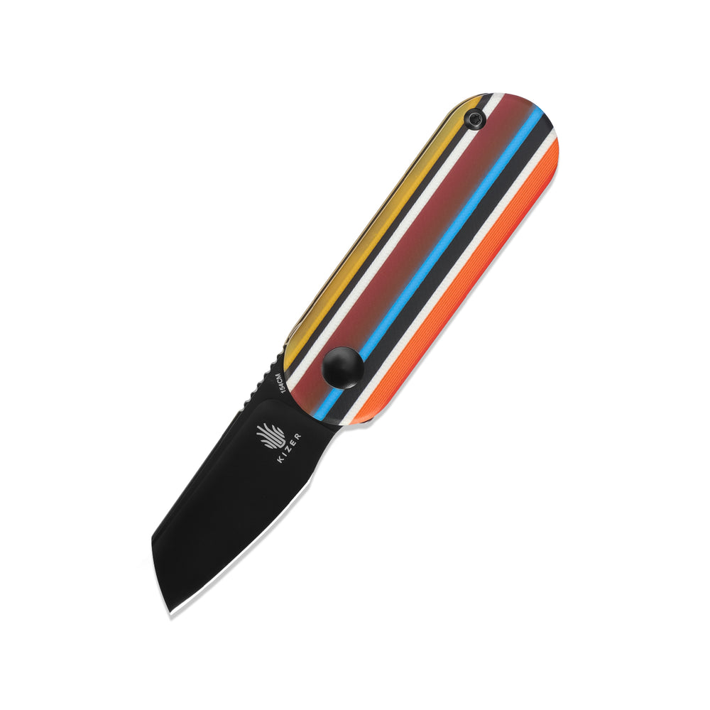

So I was eyeballing a very simply designed folder for purchase the other day and watching a disassembly on youtube when I noticed that it only had a steel liner on one side (linerlock) and that the stop pin seated directly into the G10 on the "linerless" side. Basically the stop pin was only secured by steel on a single side.
Now I'm sure it's perfectly strong enough for normal cutting use, but one of the reasons I carry a 3.4"-3.6" folder is the ability to stab if need be (yes, however unlikely).
My question is, does G10 really have that kind of strength? I know linerless knives exist, (hell I think spyderco even has stop pins directly into micarta)... or should I pass in lieu of no stabby?
G10 and other composites are "really strong".
But the real key is what effort the maker has put in. Not naming them and the knife model makes it impossible to say.
And of course obligatory "if you're stabbin' stuff get a fixed blade".
Kizer... and I was waiting for that obligatory.

My problem is specifically with 2) and stop pins, pivots, etc. We all know how only a minor reduction in stop pin diameter can affect a frame lock. So I remain uncomfortable with a stop pin sitting directly in G10 for frame locks in particular. With hard use, the G10 hole will open up.
Get this one. It's a slip joint so if you're stabbing stuff you're already in the bad books.
Many cold steels use linerless g10 and seem plenty strong.
Yep, and not many people are killing a CS by blowing out a stop pin unless they are trying to break it.
