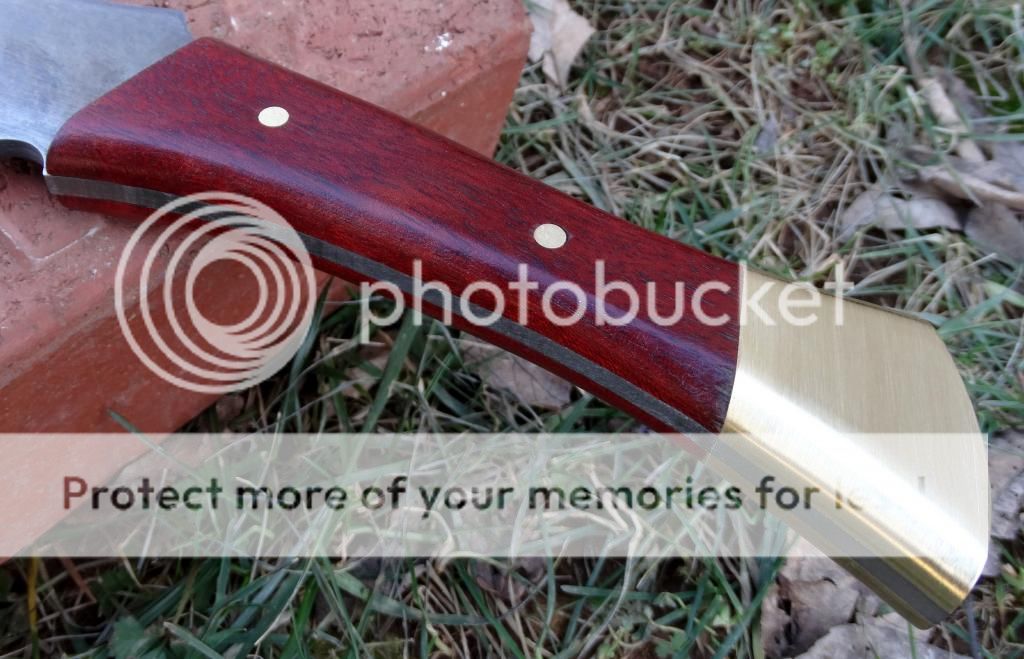

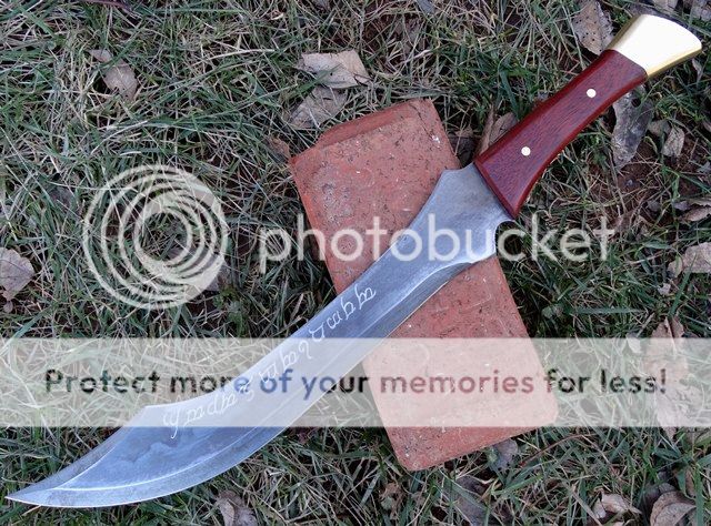

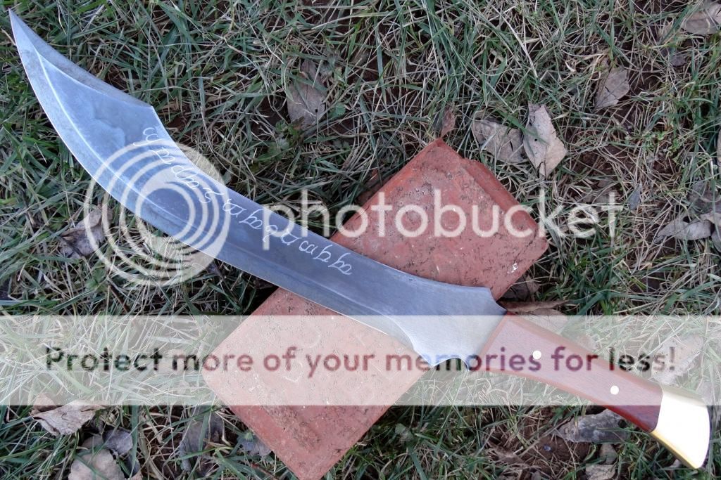

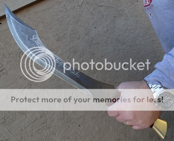

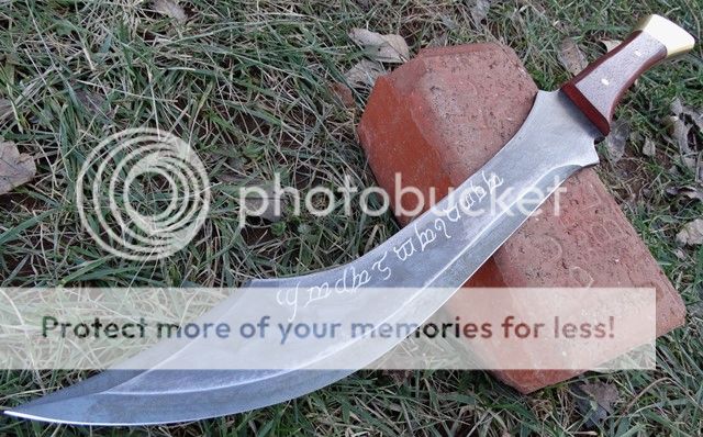

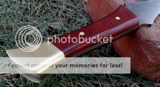

Hi all. Just completed this one. Will be adding to the website soon and doing a video on it. It’s influenced from the knife Aragorn used in Lord of the Rings and similar to our Strider Knife.
Shop Details:
1095 High Carbon Spring Steel. Steel is Heat Hardened & quenched in oil. Heat Tempered @ 500 degrees for 2 hours, and letting it air cool.
Stormbringer Aragorn Knife – LOTR Influence
Measurements:
Total Length = 20 “
Blade Length = 13 ½ “
Blade Width = 2 1/8 “ widest
Blade Thickness = 3/16 “
Handle Length = 6 ½ “
Handle Width = 1 1/8 “ center
Handle: Brass and Bloodwood
Weight = 2 lbs
Pictures below. Thanks.
