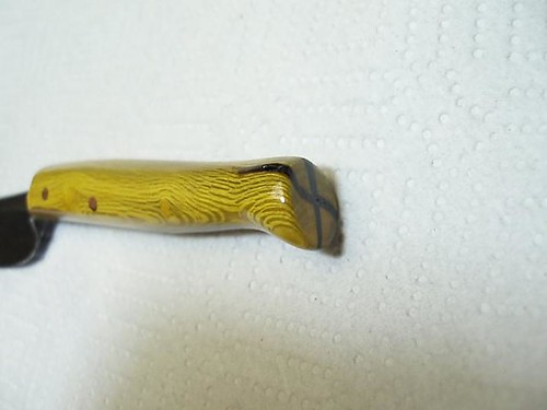

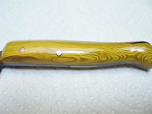

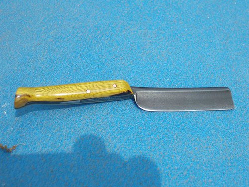

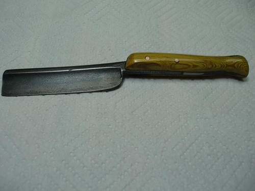

I have had a factory second, double stamped, never finished, Solingen straight razor in my stash for years.
Finally I got an idea of what to do with it. Fixed blade neck/back pocket knife.
Smoothed out and acid etched the whole thing.
Put it through a semi polishing and blued the blade.
Made the handle and attached it using copper for the pins.
I think it came out pretty nice for my first neck knife.
Now I need to make a sheath...

all kidding aside its really nicely done, you may want to make a kydex sheath with a felt lining in it for that particular steel so it wont rust while sheathed

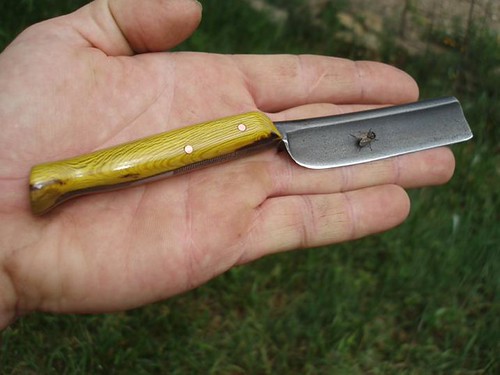

I tried to get some natural light, contrasting shots to show just how vibrant the color is...
The fly liked it too... didn't see him till I looked at the pics on the computer.
Nice work! Very unique and unconventional method. I like this, it's kinda like a broader sheepsfoot blade. Nice work using an old razor to make something awesome!

Nice bit of work, how'd you fill the space for the partial tang & curved tail? Looks complicated.
Also, how thin is the blade?
The handle is a two piece that has a carved interior to fit the tang shape with some grey spacer material at the edges.
The blade is razor thin as was originally intended.
I thought about taking it back a way so the edge would be thicker, but then the whole idea and the visual aspect would have been lost.
