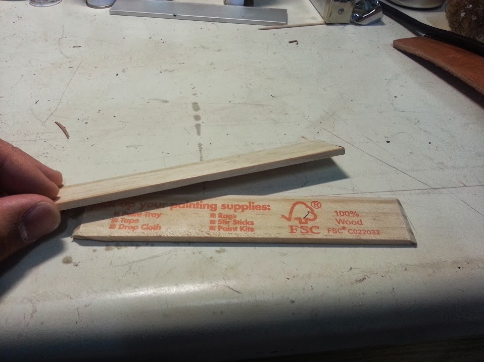

In my ever continuing quest for straight razor nirvana, I have a low-cost strop alternative that I would like to share with everyone here.
Low-cost you say? How low can you go?
I present to you the Home Depot paint stick EP balsa strop.
Here are some of the intricate build photos that were taken while I was in the garage.
Paint stir sticks:
Cut and ready for a test fit:
Looks like it is ready for glue and grip.
Under pressure:
For comparison. From left to right:
Homemade Leather EP strop, EP 1k stone, Home Depot EP balsa strop.
HDEP Balsa strop selfie. This strop was sanded down with 1k sandpaper, checked for flatness with the angle cube, and sprayed with some 0.125 diamond spray:

Just an FYI. I was just informed that the wood I am using is not balsa, but some sort of pine. I will get some balsa and other materials that I can get my hands on.
This journey continues. *Teaser: Using laminate wood?...
