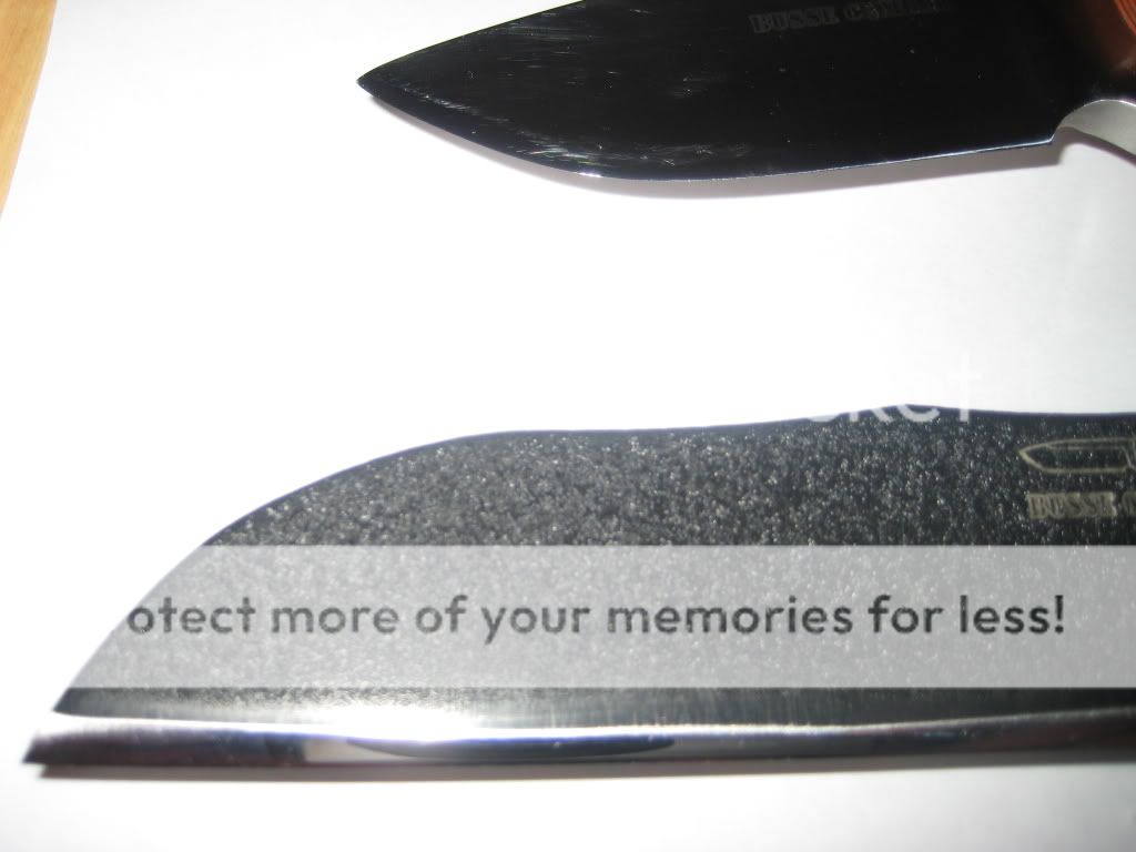

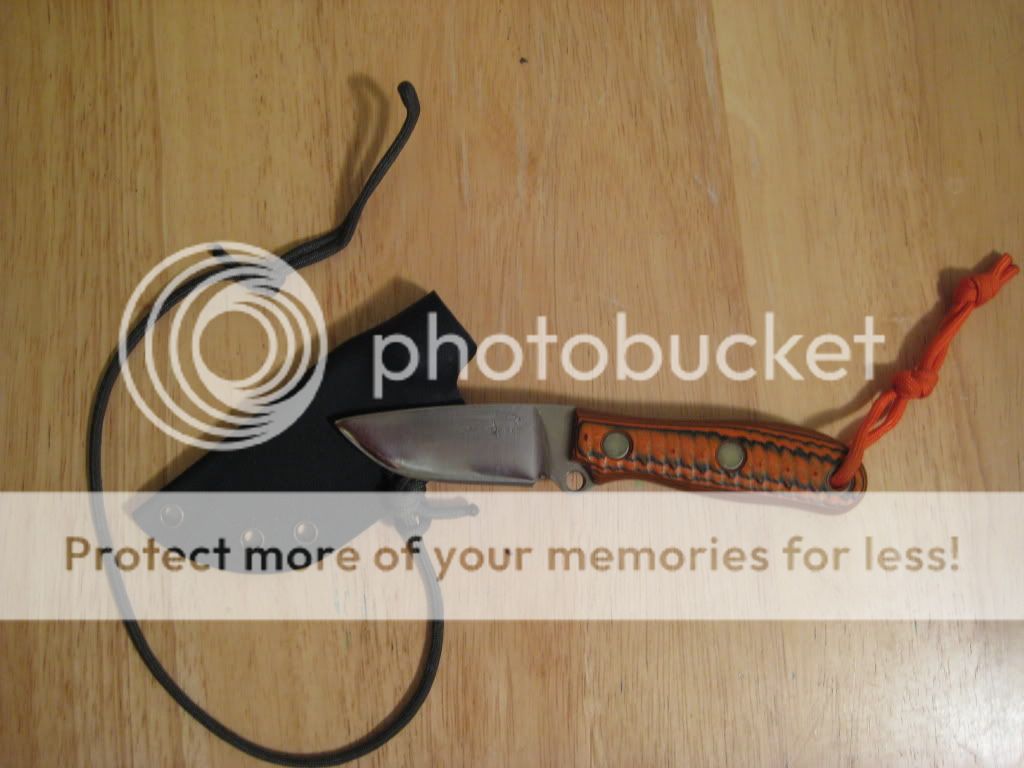

I picked the wife up from the airport today. She has been gone for a month, and had the camera with her (visiting her folks while I studied for the bar). I have not posted any pics of my GW, or the SS after I took the curve out of it, and convexed the edge. They both push cut paper, and make hair jump off the arm. I still need to strip the SS, I Might wait till the finish is even more beat up from use, then strip it to match the satin GW.
I used a piece of glass, and sand paper to take the curve out, then convexed it on mouse pad with sand paper.

The before shot.
I forgot to say, the green in the first two holes, is glow in the dark epoxy. (the hog I bought it from did it, and convexed the edge also). Hit them with a flash light, they glow for a couple hours. I really like the idea, especially if I had it out in the woods at night. Nothing like dropping a very sharp knife, and hoping you find it before you step on it or kick it.
I have been carrying it front pocket, tied off on the belt, so I won't loose it. Recently carrying it with the tech lock, horizontal, on the front.

for the hardness level, it sure seems to sharpen easy. Once convexed, just a few strokes on the strop and it pops hair.

What is the SusScrofa like to cut with? I look at that weird inside curve edge and have no idea how it would work.
It is a very very efficient slicer. I have really liked using it. For opening packages, mail, cutting rope, hard heavy duty packaging bands cut much easier with the reverse curve. The point control is very good. It is an extremely useful design. It would make a great river knife, boat knife, rescue knife (good for cutting seat belts without cutting the person stuck in the belt). The skull crusher on the back will make a great window breaker.
The reason I decided to take it straight, I made some hard contact with a sink. The dent was too big to strop out. I tried to steel it for a few minutes, then decided it was the perfect reason to do some modding. The SS was only the 2nd attempt at convexing an edge. It sure is sharp now.
