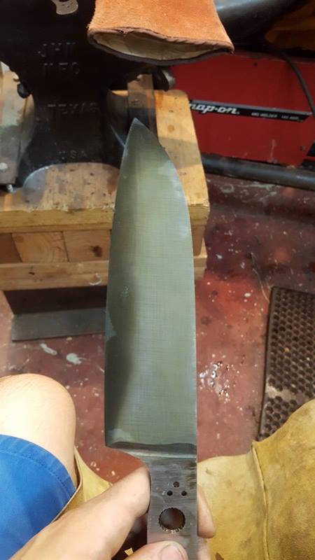

Hey guys, so im working on a new hamoned kitchen knife. Steel is W2, I quenched it in oil. The clay was applied pretty well "I did a similar one a day ago but it cracked in the water quench and the hamon was exactly were I applied the clay"
I just ground it down with 60 grit to near the final thickness and did an etch just to text. This is what I got

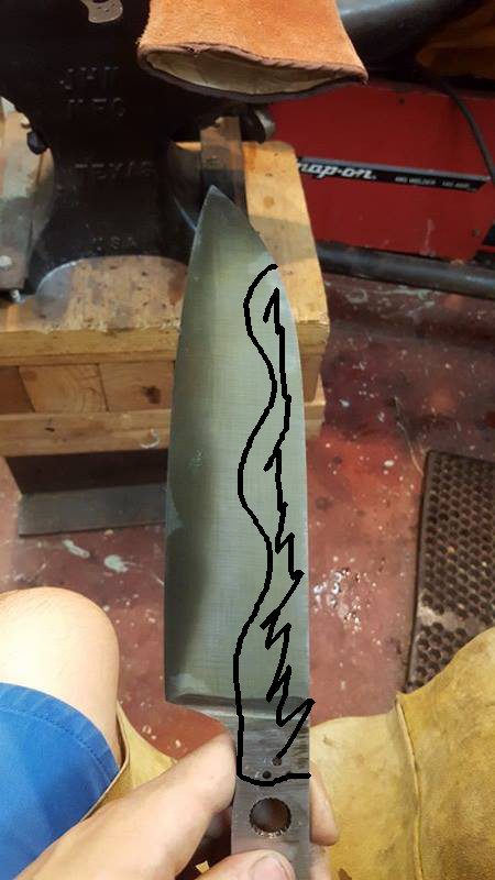

The issue is thats not where I put the clay at all.
This is how I applied it and how the other hamon showed up
This is only at 60 grit, and Im going to polish it all the way up. Any ideas?
In my experience with W2 and hamons, this was one of three things or a combination.
Either your clay was too thick, your soak time wasn't long enough, or your temperature wasn't high enough.

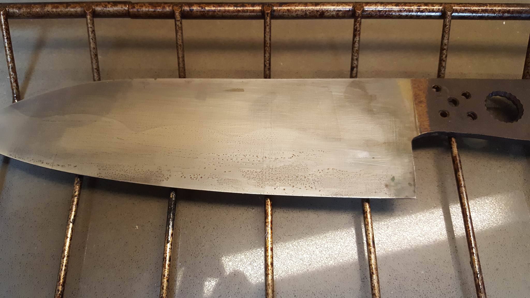

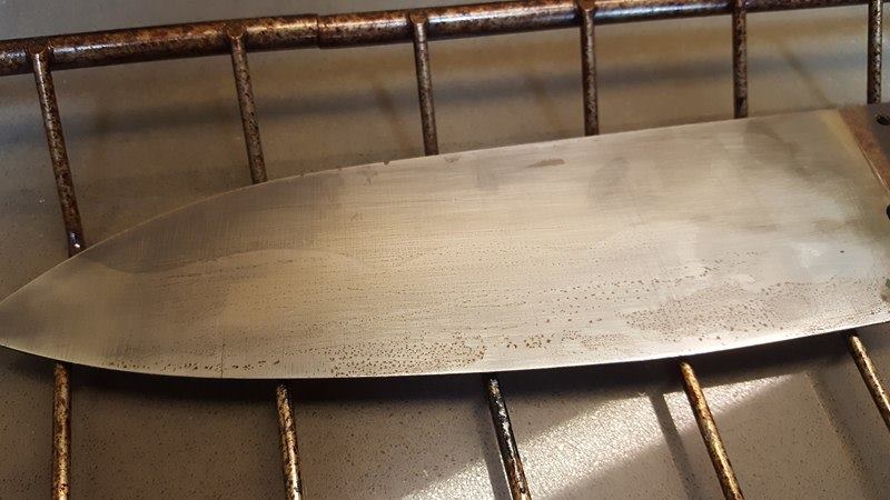

The soak was not very long. But I have another piece I water quenched and it had some crtacks, I ll take some photos. The hamon went quite well on the piece.
What I was wondering was How it moved so far down when the clay was applied rather high on the blade.
Did you quench this blade after the cracked one? Did it have time to get back up to temp before you quenched it? That is assuming that you are using a kiln...
I ran into the problem of losing heat when the kiln door was open, when quenching 3 blades one after another. By the time I quenched the 3rd blade, the oven had lost too much heat, and I didn't give it time to rebound to aus temp. The hamon ended up looking like yours, so I did the HT again.

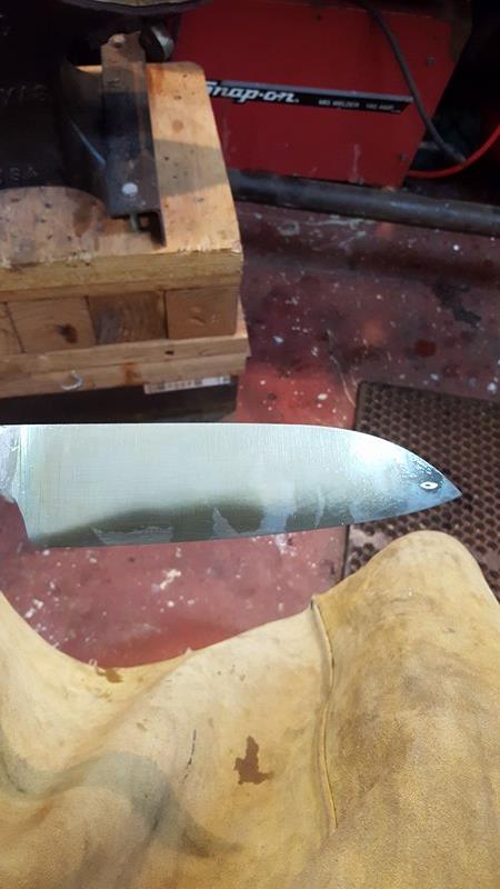

Here is the one that was water quenched. As you can see, the tip part has a very well devolped hamon that followed the clay, but towards the tang it lost all detail
I also get that weird Hamon with to thick of clay because I have a tendency to glob it on.
Its strange. The one I did before showed some great detail in the tip.

Use very thin clay with W2. Make sure you have your whole blade up to critical. It's possible that only the edge was up to critical and the rest didn't harden because of it.
Did you take off enough decarb on photo #1 ?

Yes. There was zero Decarb left.
I will hand sand, just wanted to check the pattern. And wondering why my first piece had so much more precise of a hamon
