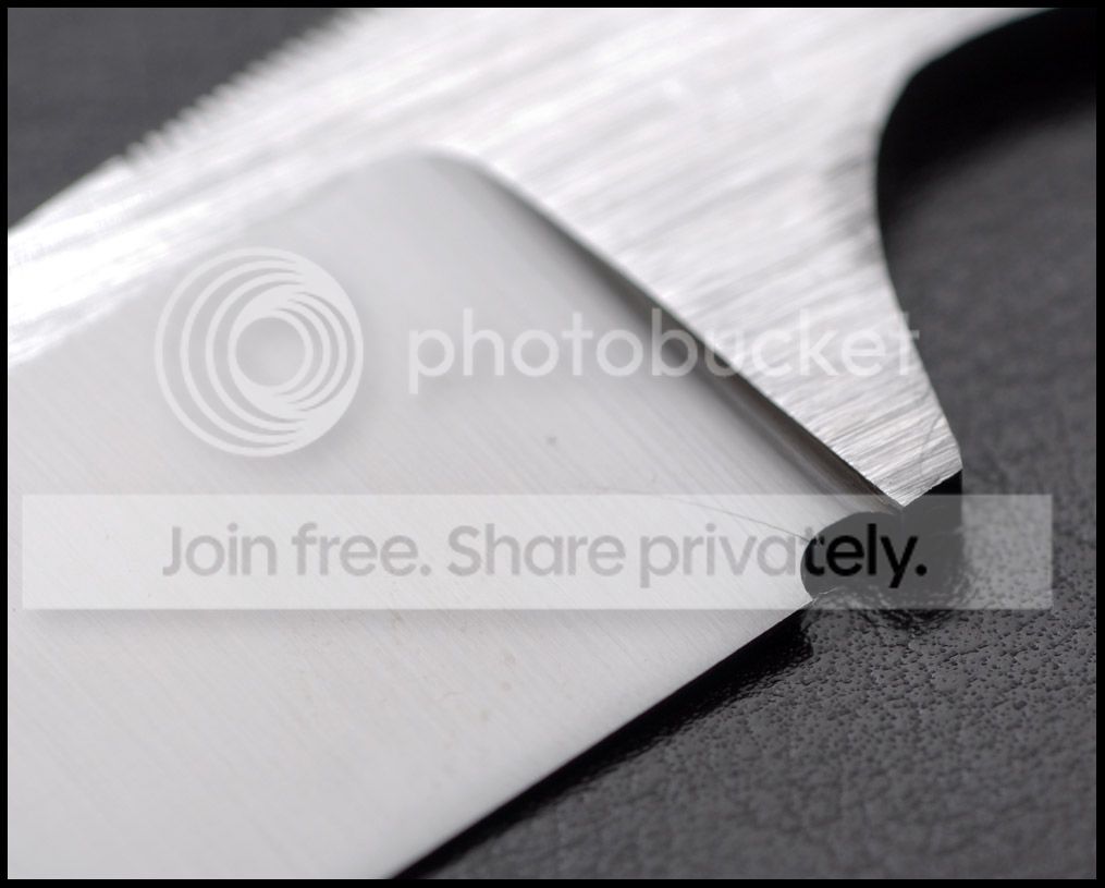

I had a differentially heat treated knife I was diligently working on develop a Stress Fracture, I was machine finishing it when I noticed. As usual my heart dropped, thinking of the time involved to this point.
It is a little hard to see in the photo. It is right above the Choil Notch

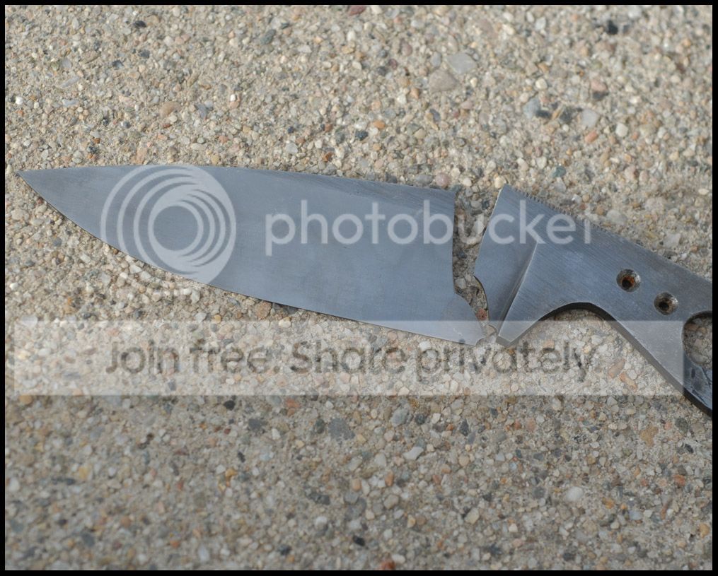

I wanted to etch the blade to darken the steel inside the fracture so I could see where and how far it ran. I then put it in the vice and she snapped. The break followed the fracture then went straight up to the spine.

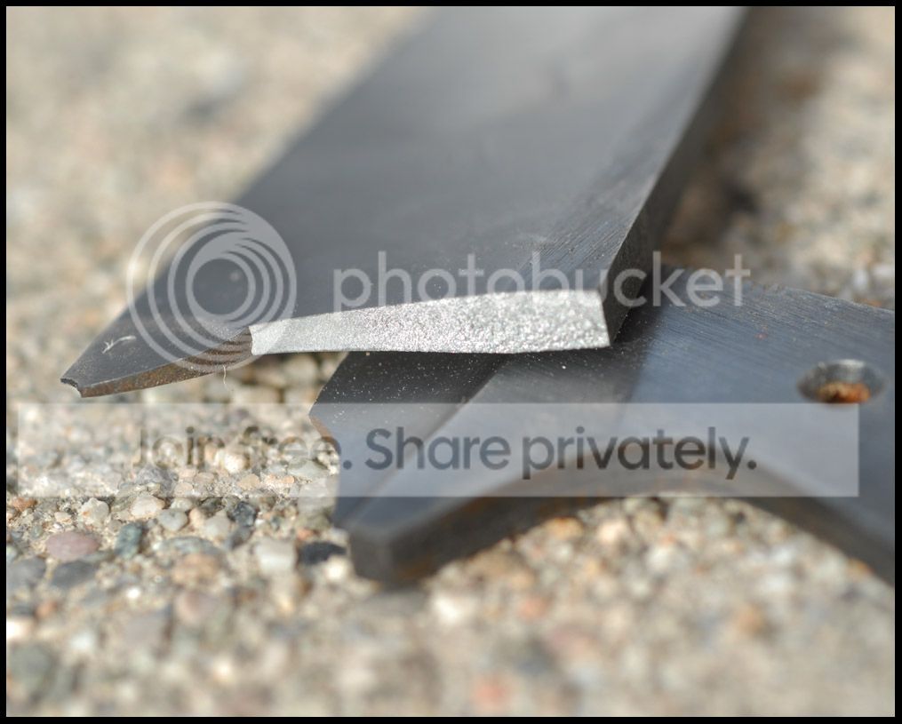

You can see in the photo where the dark/rust colored section is the fracture then the fine powdery grain of the hardened steel, followed by the sparkly coarse grain of the clay coated spine.
Time to start over on this knife order!!
That sucks man! What grit did you stop at prior to HT?
I always hate seeing those, sorry man. I have been getting those a lot, in the same spot. I found that it was because I have been grinding to a thin .015" - .020" before I heat treated. I bumped the edges back up to .040" and I had no more problems.

Well Hoss, welcome to the world of metal. Speaking of metal, what was it and how did you baby it prior to heat treat?
Pretty coarse grain on the spine. Since I see a hint of a "Clay-Induced-Line", I will assume it was something in the 10XX-ish through perhaps 1095 or W-1-or-W-2.
Just from an "Old-Mans" perspective, judged only by the photos, I would suspect that, either you lost control of your heat and over heated the blade prior to quench, OR, you didn't do any normalizing cycles prior to quench.

The steel is 3/16" 1095 from Aldo. I rough ground and tapered the tang, the edge was right at .030" and the grind was even. on both sides.
I finished it to 400 grit then ran it through the following thermal cycles in my Evenheat OVEN:
1600F hold for 15 Cool to black
1475F hold for 15 Cool to black
1425F hold for 15 Cool to room temp
Cleaned up to 400 Grit applied clay (Rutlands) and did my usual HT that has worked for hundreds of blades... I quench in Parks 50.

The coarse grain concerns me, Ryan. Have you calibrated your kiln recently? Do you let your kiln equalize before puting the blade in?
Personally, I would use 1600F, 1500F(oil quench below 900F), then 1450F with a full quench, followed by a few heats to 1100F or so. I also wouldn't soak during the normalization.
The "Coarse Grain" is where the clay was. Is that not the purpose of a Differential Heat Treat? This knife does have a hamon. I agree that the Grain over all could be more refined.

Thanks Cody, I will be doing some test HT's next week and break them to check the grain structure I will be using some of the suggestions here as the test subjects, I am sure it has been done in the past, but I am getting a new shipment of steel and want to know what I have when It arrives this week.
1/8" 1095:
Sample #1
No Clay, No Normalizing Cycles, Heat to 1450F Hold for 6 minutes quench in Parks 50
Sample #2
My Past Process (Which may change after this)
Sample #3
Rick M.'s Suggestion
i am open to any other suggestions for test pieces at this point.
