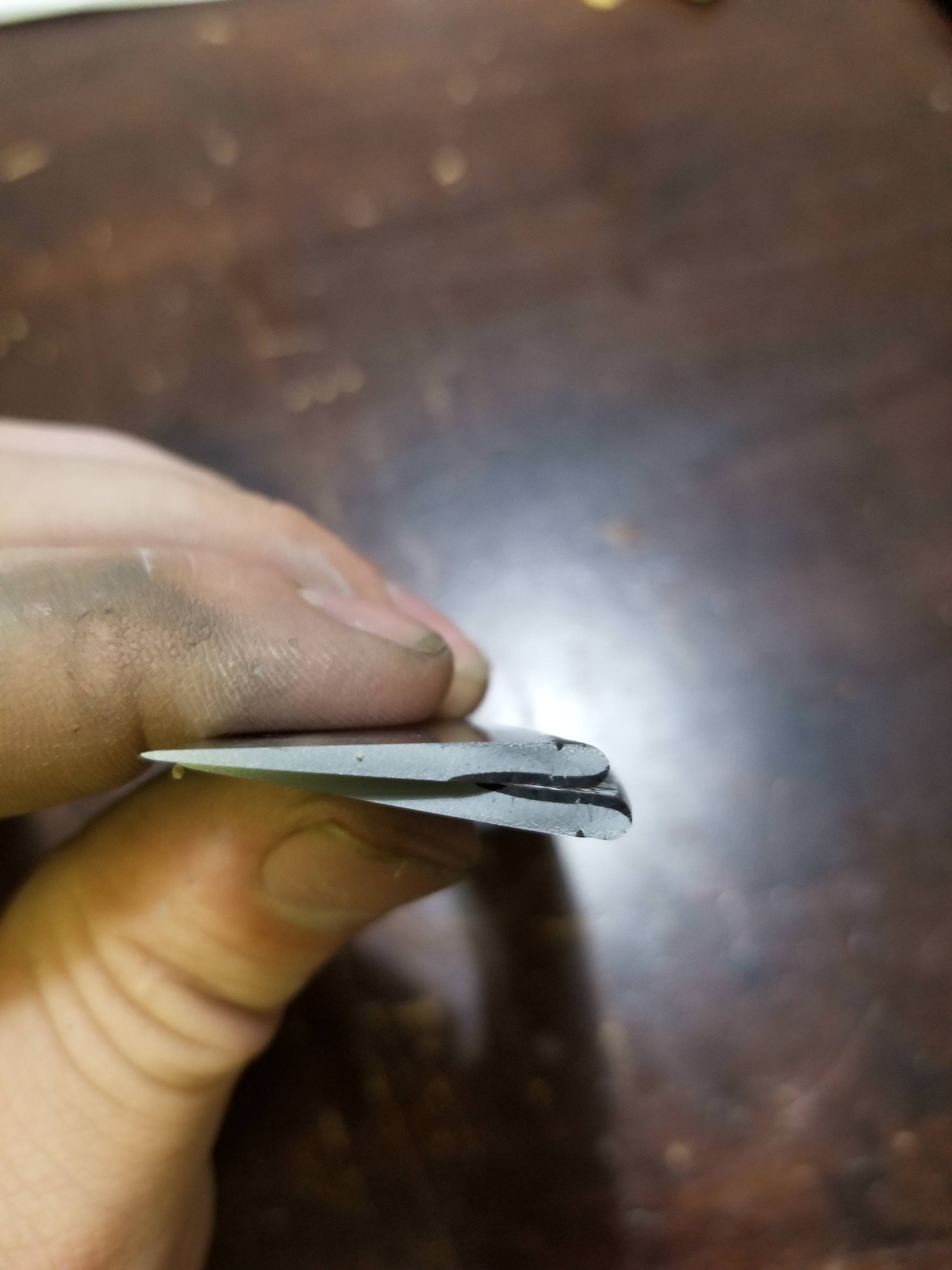

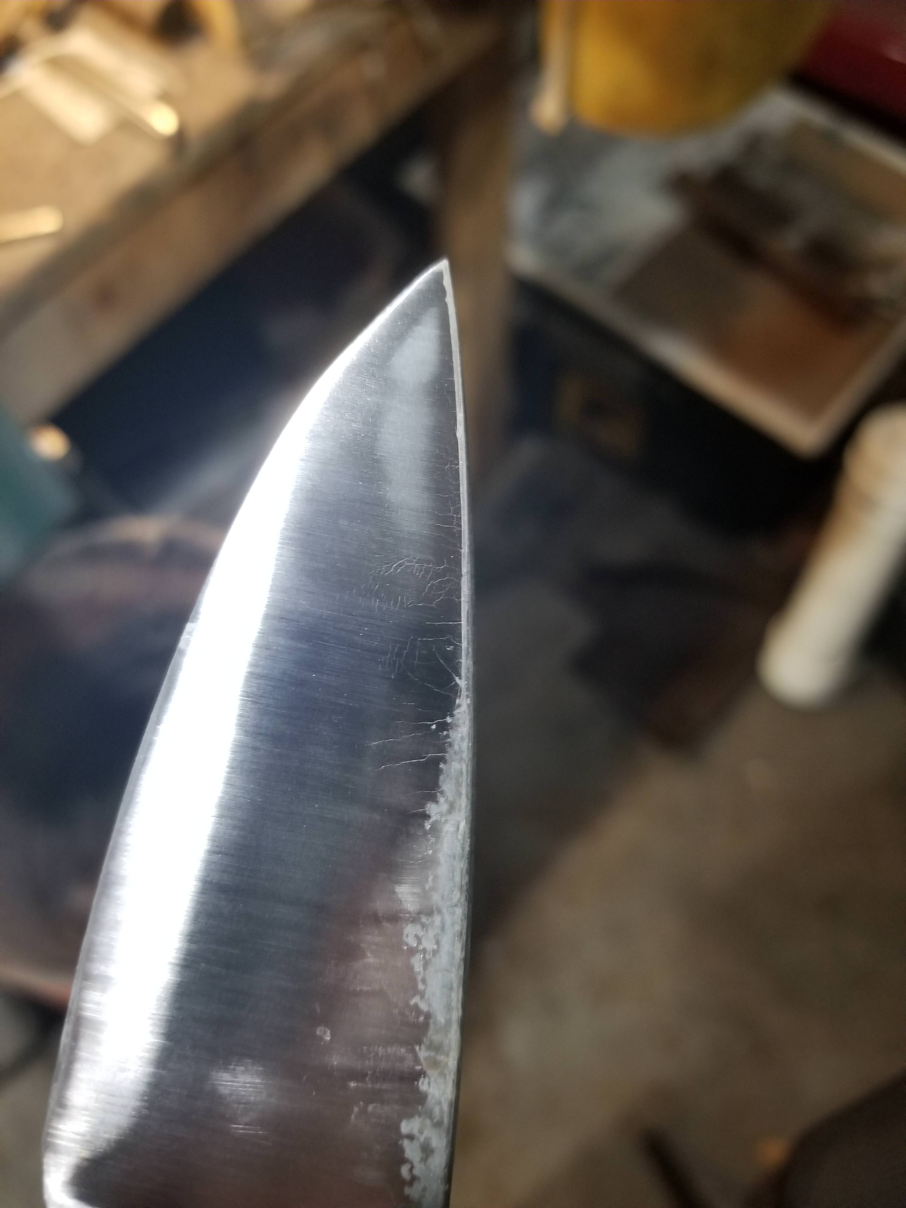

Been trying to learn 1095. I have a pid set up in my forge. I'm waiting on the solenoid and omega TC to get here. So I've just been using the TC that came with the pid. I can get it to hold within 10deg on the blown burner.
Normalized 3x 1800,1600,1475. Waited then applied satanite om the edge. Nothing crazy just some lines. Waited for it to dry then back in the forge. Soaked at 1475 for 8 min quenched in 7% brine. I know I know. But I just dont have the money for p50 right now. I had it set aside and stuff just came up.
Anyway, should I break it and check the grain?
I ended up just breaking it because i wanted to see the grain. Grain looks great but I can see the fractures through the steel. Live and learn and invest in parks 50 :D
Only time I have seen water/brine work on blades of high carbon is with interrupted quenches. I have not done it so I’m not much help. But I goes somthing like in for a count of x and out for a count of Y then back in for a count of z. Thoes times are dependent on steel type, geometry and experance. But I do know there are people that do it.
Yes, that is stress cracking.
Brine quench is a best and timing of the IN and OUT are critical. It is hard to learn and will break/crack a lot of blades.

I actually used your 7% brine recipe you posted in another thread. Blade was sanded to 220 and I rounded all the corners also to 220. After talking with some people I'm pretty sure those are from cold forging.
I will definitely do your interrupted quench procedure and sand up to 400 this time. Yeah i ment put satanite on the spine it was late when i wrote that lol
1800f? 1095 is normalized at 1600f.
Your second “thermal cycle” was a normalizing heat. For 1095 that was forged or heavily annealed, my procedure would be to normalize at 1600-1650f, thermal cycle 1525f 1475f 1425f (I quench on last thermal cycle). 1475f 10 minute soak, P50 quench, temper.
130f canola hardens 1095, especially in 1/8” and under cross sections. You can even try 3 seconds into brine, then immediately into canola until ambient.
it does and will work just fine, and I'd be happy to hardness test your blades for you so you can feel comfortable using the warm canola.
