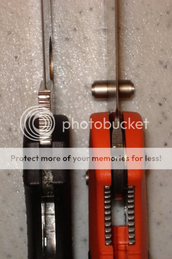

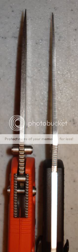

Another good point. The Stretch's blade is 0.08mm thicker than the Ritter's near the handle, but it tapers much more abruptly.

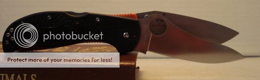

The knives aren't perfectly aligned in this picture. The Stretch's blade is actually slightly longer than the Ritter's.
One other thing I didn't mention before is the angle of the blade relative to the handle. The tip of the Ritter's blade is almost on the center line of the handle while the tip of the Stretch's blade is significantly below center line.

There are two Omega springs. One on each side. They provide the resistance to the thumb studs/lock bar thingy. If both of them broke then there would be nothing holding the lockbar in place over the tang when the knife is open, but like others said you cold wedge a small stick in there to keep it open. You can look at the picture above where I showed the blade thickness and see the sliding thumb bolt lock thing on the Ritter.
