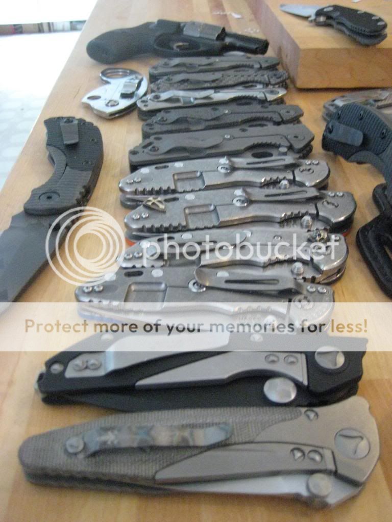

That's a fake strider TAD Dauntless. The give away (other than where it came from/price) is that AFAIK every one of them in individually numbered.
That's a TAD Dauntless or at least it's supposed to be. That initial bottom Hinderer looks good to me, too. Yikes!!
I knew she wouldn't pay 100's of dollars on a gift for me, so I knew it had to be a fake, even though it's got really good fit and finish, no blade play and it's very sharp. I did tell her not to buy anything from the vendor again and she admitted it only cost 60 dollars.

Jill, It is the TAD Dauntless version. It may be real - I don't know - because TAD authorizes various makes to produce TAD Dauntless versions for sale from the TAD website. PM me if you want details. Their are people who collect the TAD versions of the various makers. They are recognizable from the fuller grooves, and the three spoked gizmo that is the TAD symbol. But I'm not smart enough to tell if yours is real or fake. The TAD website people would know in a heartbeat.

It's not real it's from Aliexpress. The Strider and Tad stamps are not hammered they are printed on the surface. The pocket clip hole is in the wrong place and the clip is straight. The real ones have angled clips. It's still a nice knife I've handled one before. The one I saw had rock solid lockup, it was razor sharp and had great F&F. The clones are getting really good as far as quality, but they still have differences. As far as Ebay goes it's easy for me to know. None of the Strider clones have the same flamed TI. None of the GG's have blasted TI side like real ones. All of the SMF/SNG clones have a BOS heat treat and USA stamp but no Steel id stamp, like they don't have the s30v. The high priced clones, like the new line of RC's have Kevin John Knives on one side and a Scorpion on the other. Someone could still put a real pic on a listing and send a different knife, but Ebay buyer protection is really good. I've ordered 3 striders from ebay. 1 SMF CC, a standard flamed SMF, and a DDC custom RC Tanto w/Razorwire and I'm positive they are real. I traded the SMF to Arizona Custom Knives for my Microtech Custom Socom Bravo. They have it listed now for $475. (I always find it to be cool when I see one of my old knives for sale on a retailers site) I was able to see the tiny variences that made it mine. Anyway ther are sellers you know you can trust. Saltcity on Ebay is a power Plus seller that deals in many high end customs. When I order from a new seller I open the package in the post office in front of the Mail person. I do this so there's a witness, I can take pics of the opened package w/my phone for documentation if I need to open a case. If a case is opened the funds are frozen until it's resolved so you don't have to worry about losing your money. I've seen fakes being sold here on BF also. I called a guy on a fake SNG about 3 weeks ago, check my posts to see it. Never send Money Orders or wires, never send funds as gift. It's not worth the risk for 6 bucks or 12 or 15 right? You'd feel real dumb if you get a fake because a gift means NO RECOURSE! May as well send cash.
This "strider dauntless" is most definitely fake. While TAD does outsource their base dauntless to an unknown manufacturer, the strider dauntless were made by, duh, strider knives. Real strider dauntless were individually serialized, and did not have a skeletonized clip, and the clip position is different. I also don't think the thumb stud was shiny, and the TAD and strider logos weren't so bright and pronounced.
