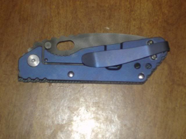

I have received a Strider PT recently and I am considering either passing it on as is or doing some changes to make it a better knife for me.
So I would like to discuss the following items:
First is anodizing the the existing clip and you have already answered this but I 'd like to know what it will take to ano the lock side in addition to the clip. It is that flame stripe finish. It needs the edges rounded to make it a more pocket friendly, but this something I can take care of, it is only a matter of files and sandpaper, but it will take a sand blast (or?) to get in all the nooks and crannies. Let me know the best tools to do this and if it makes sense for me to do it before sending it to you.
Also, can you do different colors when anodizing? For instance, can you do the outside blue and the inside yellow?
Next is blasting the blade. It has the heat treat bead blast stripes just now, I think some other finish would be preferable. Let me know what you can do, Should I go at with the dremel or send it to you? I have no problem hand rubbing a blade, it is just the grooves that look tricky.
I'll be making a new scale for it too. Not sure about materials, except I want to try one in denim.
Let me know thoughts regarding this.

Everything but the new scale is a go. I'd be hardpressed to make a solid scale like that all one piece with the spacer.
I would have to cover the detent ball to anodize the lock side to keep it from corroding in the bath. That could lead to some gritty feeling action if not done right.
No guarantee my blasting will remove all the stripes from the blade but most will. I've run into some that for whatever reason I didn't even hardly dent removing them. It was a Zero Tolerance 302 though.

For just a quick blast and anodizing I'd just need a donation to the refreshment fund so long as it covers shipping back to you and something for me. ;) If its involving blasting the blade and having to resharpen it afterwards it would be more time so then I'd have to add that.

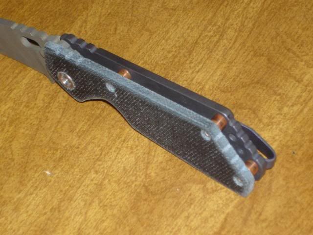

Here is what I made of it when I got the frame and clip back from you

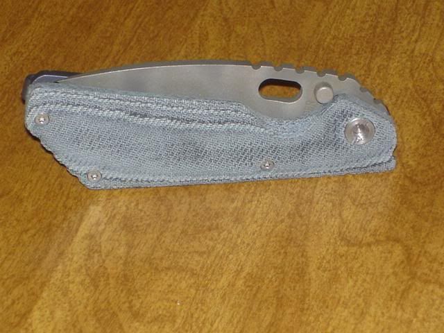

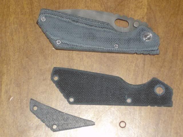

I made some denim scales for it, from my own handmade laminate (same stuff I sent you Steve). They are a two piece design copying the factory scales except for forward screw set has a copper standoff to provide for the blade stop. It is just to difficult to copy the factory scale exactly in this area. It is a great idea and a real work saver.
Actually I made two sets, one left flat like the factory scale and the other lightly rounded.
Rounded set installed, the other flat 2 part set with copper standoff below the knife:
I also made up some extra copper standoffs so the option of replacing the denim spacer is available. This is nice because the most rearward standoff, screw set allows for a nice place to attach a lanyard, correcting about the only shortcoming of this knife.
Shown with the flat scale and copper standoffs:
