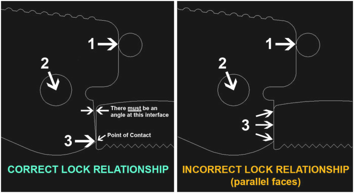

Yeah. A ti frame lock with a small locking surface:rolleyes:
If you are referring to what I think you are referring, that is a generally accepted way to design the point of contact on a liner/framelock.
My sources are Bob Terzuola's book "Tactical Folding Knife: A Study of the Anatomy and Construction of the Liner-Locked Folder" and Emerson's website.
Terzuola says the contact patch should be 0.090-0.125 inches.
Here is an image from http://emersonknives.com/blog/emerson-knife-anatomy/
Some knifemakers say that a small contact patch is not ideal, but it is definitely not wrong.
Of course, you may be more knowledgeable than these two knifemakers, I am just relaying what I have read.

more about tiframe locks in general. They aren't as strong and durable as some of the proprietary locks out there now. I remember andrew demko said that the strongest ti frame locks he tested could only take a reaction kf the weight a triad lock can take. I'd imagine the same is true for axis lock and ball bearing locks given most of them have a steel on steel on steel lockup that is less likely to deform and will wear better against each other. My whole loint is that it seeems people really kid themselves with how strong all of these are when something like a benchmade contego would laugh off things that would break a strider or hinderer.
True. A folder is all about trade-offs. I have personally tested my SnG by wedging the blade and leaning on the handle. The knife withstood much more pressure than I could ever accidentally put it through. I owned a Benchmade mini-Barrage and it did not pass my tests.
The Tri-Ad lock is stronger, but it is less convenient for me to operate than a liner/framelock. Since a framelock is strong enough for my uses and the most convenient, it is my choice. Pretty much any well-made lock is strong enough for 99% of people. It is just preference.
