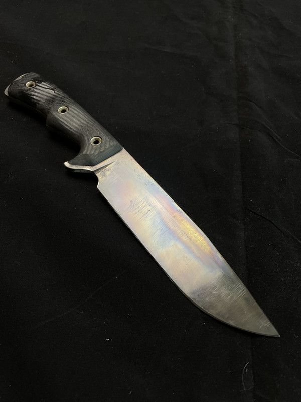

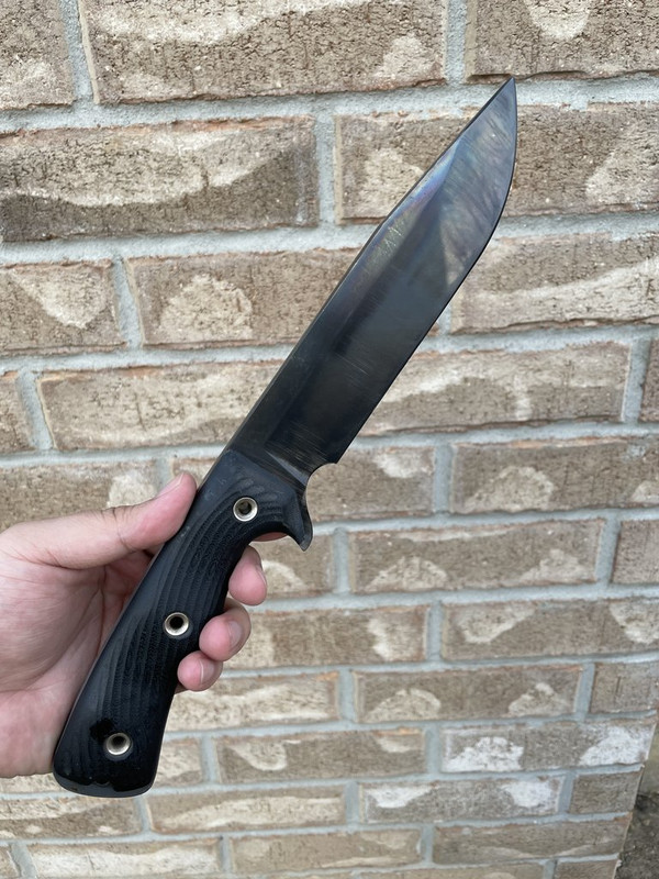

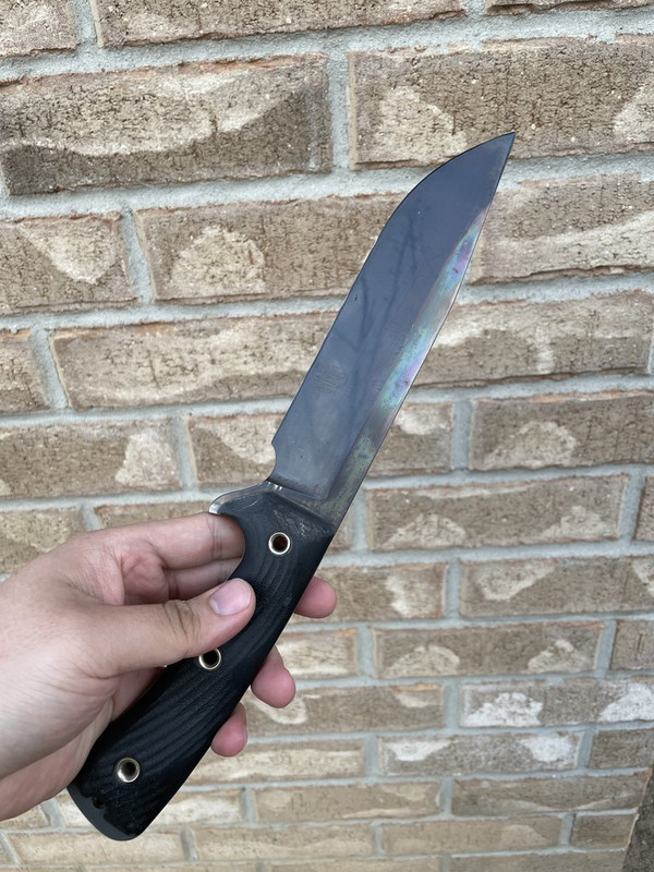

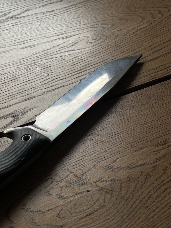

Just wanted to share with you guys this user Rodent 7's before and after.
I used EZ strip to get rid of the tanker grey coating, then used my Shapton Glass whetstones #1000 and #4000 to get a ghetto mirror polish, then submerged the blade in some Nestle instant coffee for 3 hours.
Surprisingly, the finish turned out to be almost jet black!!
I think it has the potential to look really cool if I had cleaned the blade more thrououly and make the finish more even.
Haven't decided yet if I want to go through with another step of stone washing the blade, since I was hoping to retain as much of the rust resistance properties from coffee darkening as possible.
