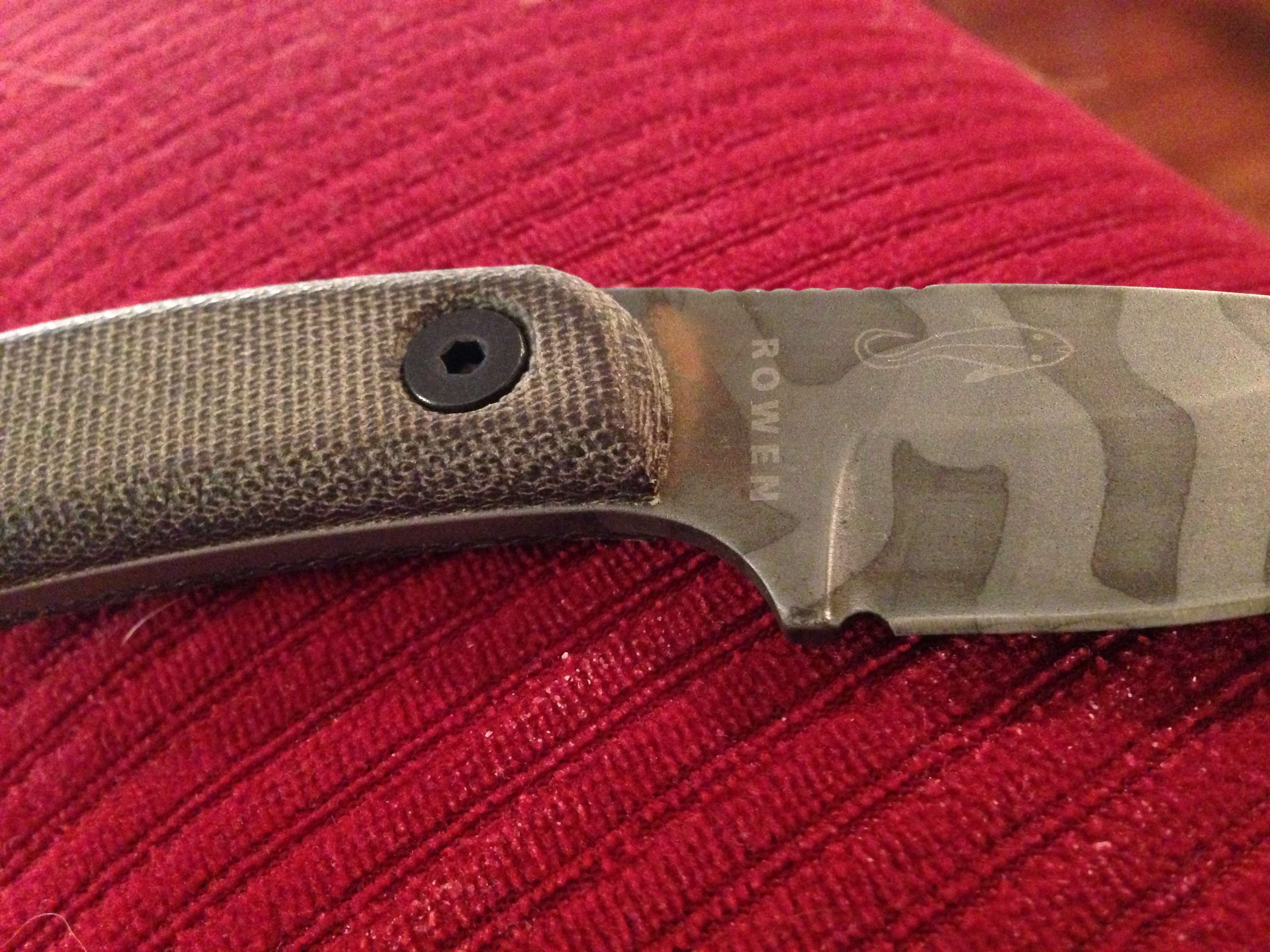

Here is my stripped Candiru... the do and will rust...
