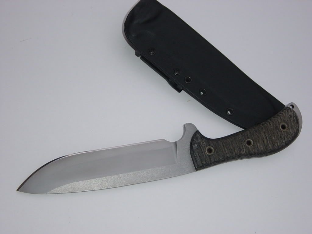

I got a good deal from a forum member on a Chopweiler user, & decided to strip and blast it!!:eek: I really like the raw, kind of industrial look of the steel. Been keeping a real light coat of oil on it to protect the blade. Here's some pics along w/ the sheath Dave made for me.
Looks great.
And look at the heat treat line :eek: awesome.
ya done good!
chicken plucker, that ratweiler looks insane.if you decide ever to ditch it- call me! :)
That's really good looking. :thumbup:

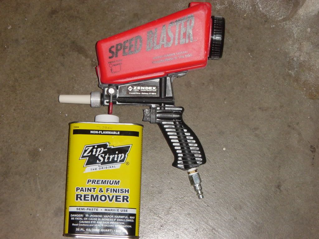

Can you give us the details on the blast process you used?
Here's what I used. I stripped it twice w/ the chemical stripper, then went to blasting with fine glass bead blast media (Grainger #2W766).
AFAIK, the Busse shop process uses an abrasive grit first, followed by the glass bead blast to smooth/seal the surface.
Looking good! I forced a mustard patina on my M9LE and it seems to slow, or at least hide, any rusting.
