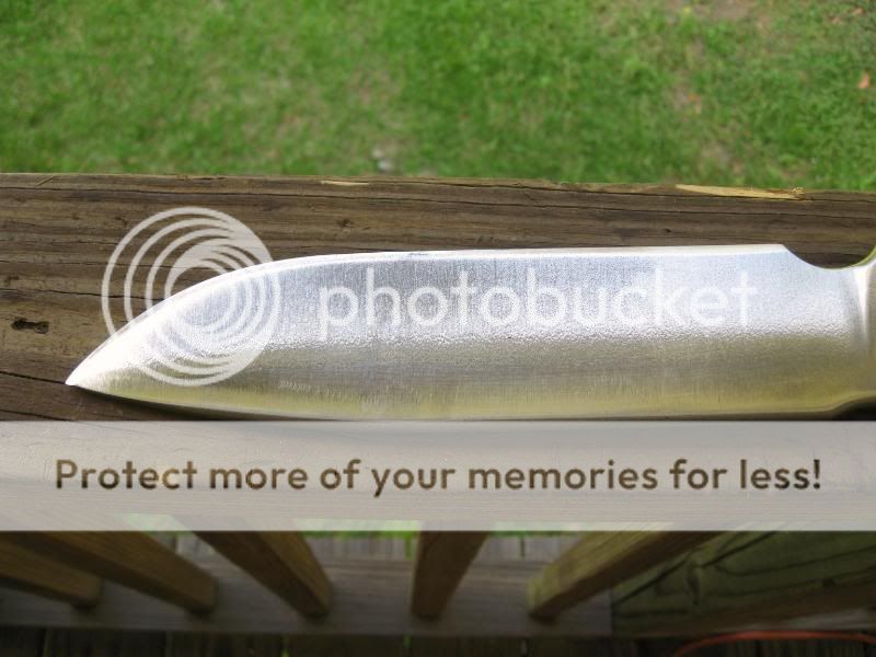

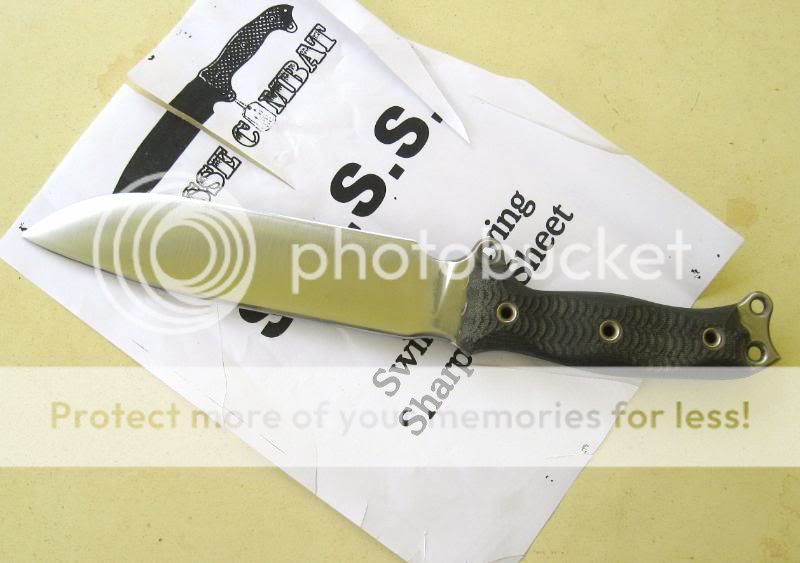

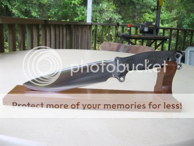

I really wanted the LE version, but it cost like twice as much. After 8 hrs of sanding and three worn out belts on my little 1" x 42" sander, I know why. I really should get the proper tools to remove the scales so I can sand the flats, but all my stripped Busses are like this, so it will do for now. The coating Jerry is using now is superb, unless you want to remove it. My usual stripper only softened it a bit after two applications, so there are still bits of sage in the hard to reach places.
The steel under the paint has an orange peel texture and machine grind lines with decarb, much like the competition finish without the convex edge.
It is a far cry from one of Horton's or Ban's or even the LE, but I can live with it.
It IS Swine Shaving Sharp, though.

Thanks, guys. One of these days I'll get around to getting a drill press and whatever tools I need to remove and reattach the scales so I can do it right.

Very nice Horn Dog! As one who's never attempted anything like that before, could you answer a couple questions for me? What stripper do you use, and how do you keep it from damaging the grips? Also, once you have the orange peel texture what did you do to it to get it shiny like the last picture? Sanding?

I have been using Klean-Strip, but it doesn't seem to work well on the sage. Maybe Jerry has a new coating. It worked fine on the black coatings. The stripper does not affect the scales. It took probably over a hundred passes on my little 1" x 42" sander to sand off the rough surface. I wore out my 40 grit and 80 grit belts, and my 80 micron is slick now (that is the final finish). It is not an easy job, for me, at least.

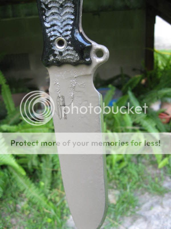

Oh, I forgot to add: So the little Busse Combat logo and knife on the blade (and the "Embrace The Suck" on my SJTAC), are they only in the coating or are they actually stamped into the metal of the blade?

They are laser engraved.

But to get to the pretty INFI you must take off quite a bit of dimpled steel and decarb. I'm afraid the Busse logo is long gone. It is mixed in with the pile INFI dust beneath my sander. Anybody who knows knives can just look at the NMSFNO and tell it's a Busse! :D
