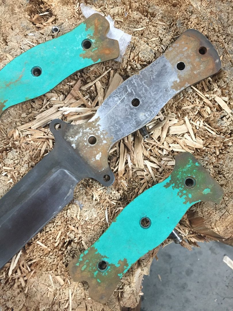

The liners definitely are NOT G10, they are the above listed material, and they will absorb some things. I recently repaired for a friend a set on a knife that was soaked in Ferric Chloride with the scales on, and the FC soaked most of the way through the liners. I had to remove and toss the scales and liners as the FC had ruined the liners and stained the micarta, but it is pretty nasty stuff and I don't know how the stripper would affect the liners or the steel over time under the scales if it did soak in. For that reason I prefer to remove the scales to strip, or only strip the blade where it will wear, though on whole knives I've stripped without liners there was no ill effect that I had noticed even when removing the scales years later.
Pic of FC damaged liners
citristrip is pretty safe stuff, but the liners may have an issue. Do not use JAsco stripper, that will melt the liners for sure. It melted the gloves I was using.

Tyrade..wow, what a mess... FC is nasty stuff...any pics after the repair, would love to see what scales and fasteners you used.

Here ya go. I used some 3/8" black micarta that I shaped to be sort of magnums, but a bit beefier and more comfortable IMO. I installed them with brass tube.
What a great job..beautiful work. Thanks for posting the pics.
I would love to swap scales (or have new set) on a few of mine, the tube fasteners always kept me from fooling w/ them.
