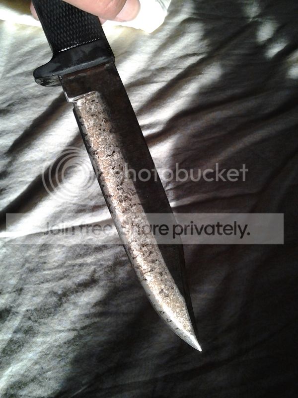

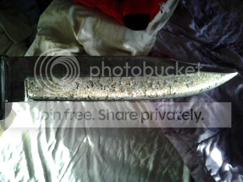

I apologize if this is in the wrong place. I have an older Cold Steel Carbon 5 SRK that I recently unearthed from my collection. I was thinking I'd like to strip the black finish off the blade and maybe polish it up a bit. Trick is, I don't know the first thing about how to do something like this so I figured I'd better ask.
My thinking is I should be able to walk into Home Depot or something similar and buy some sort of stripping solution to dunk the blade in, and maybe some sort of polish or something to buff it up afters.
Can someone either point me to a video, or a well written tutorial for a project like this?

If the finish is paint, just use spray on paint stripper. If it's something like a titanium nitride surface finish, the only way I could think of to strip it would be with sandpaper, which you'll have to use anyways if you plan on polishing.
Dads easy strip is the best over the counter stripper i have found. Most hardware stores have it. Its the only one that will take off arsenal refinish coatings on M16/ar15s. That stuff is TOUGH.
I've stripped them before---let me warn you in advance that if you don't have the requisite grinder/belts, polishing the steel once the finish is gone is going to be a long, long process. They leave it fairly rough underneath, both because it saves costs, and also because a rougher finish actually helps the coating adhere better. Personally, I kind of like the "stippled" look that exists on the flats, and the primary grind has a scotch-brite finish that will polish into a sort of streaky satin finish easily enough. If you want true satin, or mirror, you're in for actual metal removal. I don't have one without a forced patina on it that won't photograph particularly well, otherwise I'd show you.
Keep in mind, many of the chemicals that will attack the finish will also destroy the Kraton handle. Seeing as how I despise Kraton with a vengeance and step one is ALWAYS to slice it off, this has never been a problem for me. If you want to keep the factory handle, though, you'll need to do a very careful wrapping/taping job before the chemicals come out.

Nice video (I'm going to have to get some of that stuff). Something to make a serious point of, however, is that while--if he decides to do anything--he absolutely can drill/slip the handle off, I highly recommend not removing the coating from the tang if the kraton is going back on. Nine times out of ten, if you pull a rubber grip off of a stainless handgun, you'll see rust where they made contact, and the stainless steels used to make guns tend to be a good deal more rust-resistant than most stainlesses in the knife world. Rubber, be it Kraton or Neoprene or Santoprene or Resiprine (although this last one is far superior to the others) holds moisture next to the steel and doesn't let it evaporate away. Even the AUS-8A version of the SRK in that video would likely rust if he'd saved the handle to put back on. The Carbon V (0170-6C) SRK's tang would very likely begin to pit deeply beneath the kraton handle without any coating.
I realize, OP, that you may have decided to not pursue this any further but here's an option for you if you decide to proceed. Go ahead and drill that lanyard tube out of the handle--don't take what looks like the outside diameter of the tube as your guide because it's flared bigger on the ends than it is in the middle. Start with a drill bit that's just slightly larger than the hole in the center of the brass itself and drill through. Move up to the next drill bit and repeat--eventually you'll run out of brass walls. Don't worry in the slightest about widening the hole in the steel--the tang is just as hard as the blade and without carbide bits you're barely going to make a dent in the steel.
Go down to an ACE hardware or hobby/craft store and pick up a very thin (they'll probably have 0.064" or even thinner) brass or copper rectangular piece, and some heavy duty carpet tape. The brass/copper is there to provide a straight edge that's very tough and won't sand away. Carpet tape is some of the most versatile of the double-sided tapes that exists in terms of what it will stick to. Now, having drilled out the brass tube and slipped the handle off, pick a spot that's in front of the handle but still on the flat ricasso area--maybe 1/4" ahead of the handle, or maybe all the way out to the edge of the ricasso right where it plunges down to the primary grind just to make things easy. Pick a side, lay the blade down and then tape the brass/copper down to protect the coating you don't want to remove. Now, use either a dremel with a brass wire wheel or 220 grit sandpaper on a narrow block to cut yourself a narrow channel in the coating, probably half an inch. This channel doesn't have to be especially neat, the brass/copper piece is providing a nice, clean edge on the one side and that's what matters. Now...
1) If you use a dremel with a brass wire wheel, you want to watch for heat buildup on the blade as they spin their wheels extremely fast, so just use it for a few seconds at a time and then back off for a few seconds. Even better, have a wet washcloth handy to hold against the blade for a few seconds in between swipes for the dremel, this will cool things down very quickly. You actually have to heat the steel to hundreds of degrees to affect the temper, and the SRK is fairly thick so it won't happen all that quickly, but there's nothing wrong with erring on the side of caution.
2. Using more of that carpet tape to stick a strip of sandpaper to a 1/2" wide piece of wood would be a quick/easy option too. The nice thing is you don't need to worry about heat buildup, but the bad thing is that where a brass wire wheel will not change the finish of the steel underneath beyond leaving some brass behind that you can clean off, sandpaper absolutely will scratch the steel to some extent, so you want to be careful how hard you're baring down. As you're nearly through the coating, switching to a higher grit of paper would be an option too. I really think brass wheel on dremel is the better option, just be proactive in keeping the blade cool.
Anyway, regardless of how you got there, you now have a "fire break" in the finish. Flip the knife over, re-tape your thin metal strip and do it again on the same spot. You'll also need to do the top/spine of the knife; if you decide to use the edge of the ricasso as your terminator line, you're now done as there's no coating to strip from the edge. So, now that your knife looks like it has an extremely weird tanning line around its waist, you can go at it with the stripper chemical. The bare patch you've created is the edge of where you want the chemical to go. Just be careful and go slow--if you use the painting-on method like in the video, start in the middle of the blade and push stripper out to your "fire break" rather than starting on the fire break and going the other way, where some chemical may squeeze out behind your spatula and ruin that nice clean coating edge you just worked at creating. If I were you, I'd actually have the tang and ricasso hanging off the edge of the cardboard so that no chemical that spills around the edges managed to work underneath the area I'm trying to protect. Just hold it with your hand and spread with the other hand.
Thus, your stripper has done most of the work for you and you now have a bare blade with an extremely professional looking straight edge where the coating stops. Now, just measure the hole in your tang (I'm assuming the old tube was destroyed entirely when you removed it) and replace with the appropriate diameter of brass tube (also available at most hardware stores) and flare the ends with a flaring tool--any kind of steel punch with a fairly thick taper will do this well enough for a rubber handle, if you don't have a flaring tool per say.

I have SRK Carbon V like yours. Actually had 4 but now have 2. one is a user with Convexed edge and the other is Nib. I stripped it years ago but only after almost all the coating was worn off. Keep in mind that Carbon V is rust aggressive and I know this from experience! I used a paint stripping gel to take off thecoating then sanded it with 320, 400, 600, 800 and 1500. Then coated it ith old blue looked great. I recently put a mustard patina on it and it looks pretty good!
