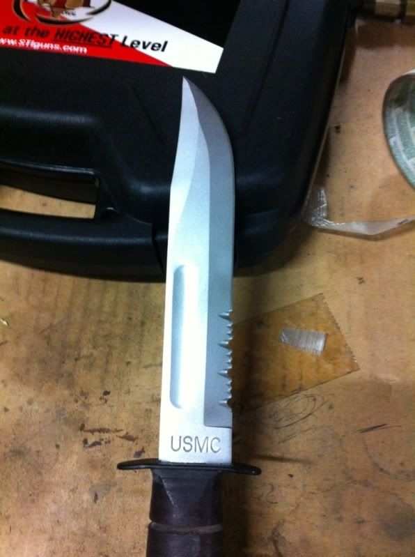

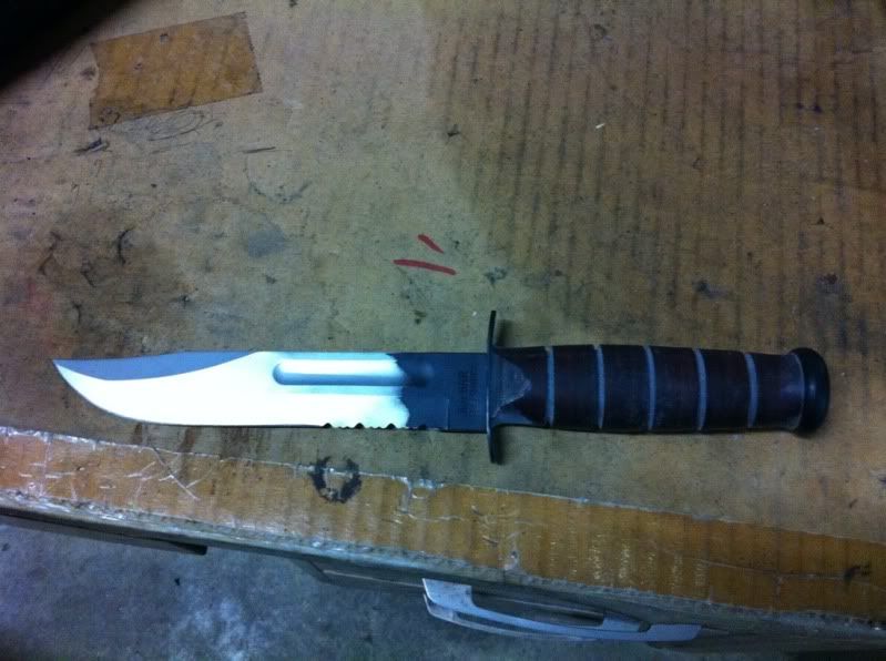

Has anyone done it? I'm interested in doing it to mine and was just wondering if anyone had any tips. Thanks in advance!

I have done it two ways, method one, use the shit outta it until most of it falls off from use, then sand the rest out of the fuller. This method takes about a year. :D
Method two- Lowe's sells some epoxy paint stripper called Jasco (pure evil in a can), tape up the quillions (cross guard) and handle with BLUE painters tape. Hang the knife upside down, and spray the blade liberally with the Jasco. Avoid the handle as much as possible. Wait 10-15 minutes, and the paint should be bubbled up and some might be falling off already. Don't breath any fumes or come into contact with with the Jasco or the paint, you will regret it.
Scrape off the loosened paint with a plastic/metal putty knife and wash in COLD WATER. After that, you should be good to go.

"Aircraft paint stripper" - this is a gel sold at auto parts stores. Very similar to Jasco above, but non-spray.
I grabbed some zip strip last week in preparation for this lol without really thinking about it. Do you think if i poured it onto the blade, would that work? Btw moose that knife is beautiful!
I have used zip strip plenty of times. It has worked great for me. I would avoid skin contact as it starts to burn about 10 seconds after contact with skin. I left it on for about 20 minutes in each application (paint started to come off within minutes every-time I used it).

Remember that he used Jasco to remove the finish on that knife. I find that the citrus stuff will usually do the job but will probably take longer. If your interested in forming a patinated finish on the stripped blade see if your local hardware or paint store carries a rust treatment called Osopho you might try it on the cleaned metal. A little different result than NavalJelly although both products use phosphoric acid in their formulas.

Garandimal and the Three Bares...
- Snowseal or wax coat the leather.
- mask the leather w/ tape.
- Citristrip® jell (brush/Q-tip)
- utility razor-blade.
- repeat if needed.
- brass brush for the cracks/crevices.
- hose off.
- Vinegar patina (finger applied) (5 min.)
- repeat for desired results
GR
Citristrip always works for me and is a lot less obnoxious than others imo.
