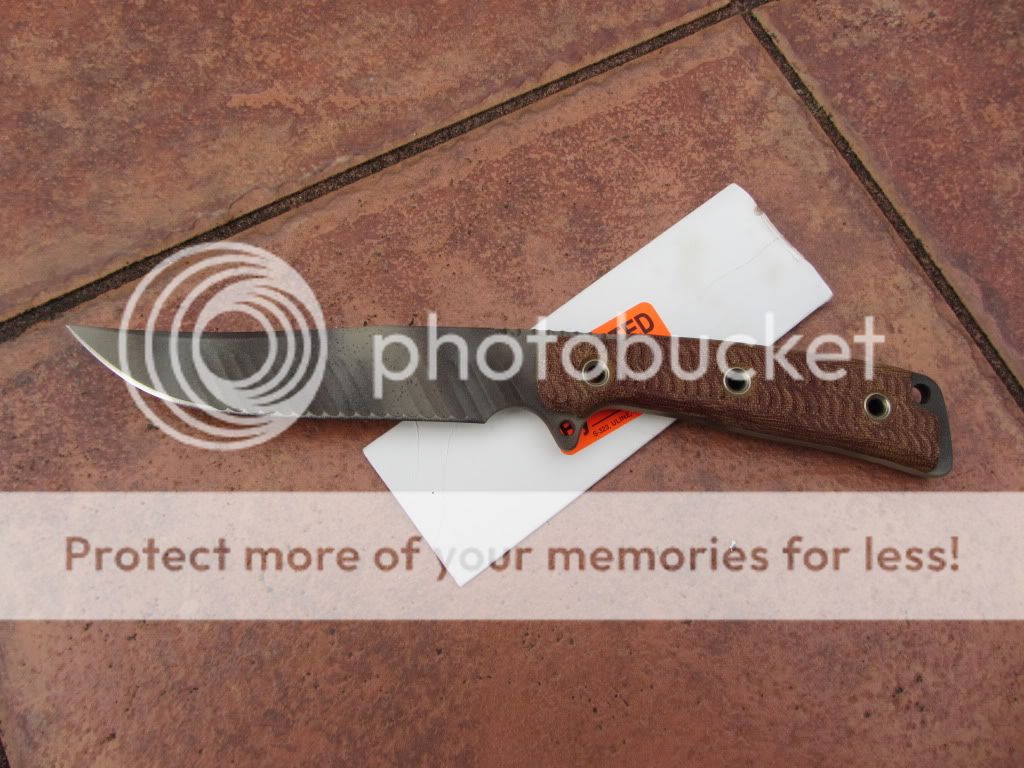

While we are on the stripping and scales subject. Will the chemicals damage micarta scales? I want to strip all the visible coating off an HG55 without removing the scales.
BTW. I did google this and didn't find much. :D
It won't hurt it any, but it might give them a dried out look the same as using carb cleaner, starting fluid to clean them or prolonged exposure to drying sunlight, but it is just the outermost layer and applying oil from your skin or any other source will make them look like new again. I actually much prefer the dried out look on all of the micartas, especially linen, tigerhide or snakeskin, but try to avoid it on the G10.
Here is an example of my Team Gemini with tigerhide (linen) micarta, dry followed by skin oil on the same handle from holding it in the second pic.
