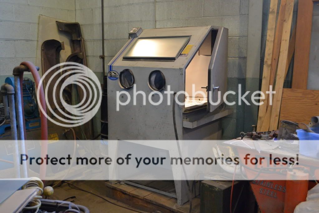

Sandblast cabinet. Will do a BK7 in 45 seconds total, and leave a nice, even matte finish besides! :D
yeah buddy! I know a guy with one of them, he owns a shop that makes tombstones...think my next Becker will pay him a visit!
Lacking a sandblast cabinet, I use the Klean-strip in a can. Spray on foam, let sit 15 minutes and scrape it off with a plastic scraper or cheap knife. Gloves and ventilation are a must. That stuff gets to stinging without.
