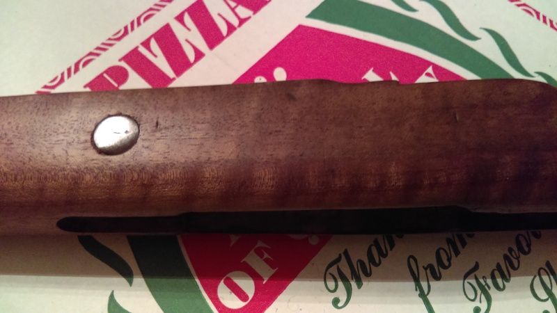

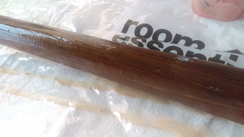

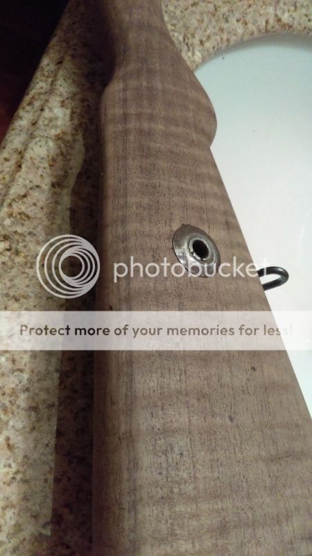

I got this old Turkish 8mm Mauser a while back. It is a deer slayer. One of my favorite guns. When I got it -it was smothered in grease and the wood was so dark from grime and dirt. I wanted to make it look better so I decided to strip the old finish off the stock. I just applied the first coat of Citristrip Let's see what comes off.
I was told to use boiled linseed oil to refinish after I strip it. Does that sound right? Any advice is welcome.
Grease and oil are a tough one to remove from wood. Using a blow dryer or heat gun will draw the oil from the wood, and you can wipe it off with paper towels. Careful with the heat gun and don't burn the wood. Boiled linseed oil will work, and is probably what was used initially.

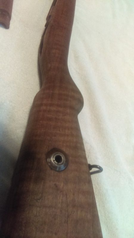

After stripping with Citrastrip and then steam cleaning with my wife's Bissel steam cleaner I got most of the gunk out of the wood. Good lord there was a ton of crap in that wood..... Letting it dry now to see what I missed.
When applying linseed oil - apply a coat then after about 1/2 hour vigorously rub with burlap to remove excess.Let dryat least 24 hrs. Repeat to get the finish you want.Use at least three coats.
I find closer to 10 thin coats being best with sanding with a brown paper bag between coats.
And it really looks like that stock's grain will display some beautiful figure. I'd remove the furniture prior to oiling the stock, but I'd just mask/tape the bolt takedown disc.
Yeah, I want to use about 7-10 coats. i might start with natural linseed oil before I use the boiled.

You really need to heat up the stock now to be sure you've gotten all the crap out of it. Doesn't sound like you've done that yet? (I don't think a steam cleaner will heat it nearly enough.) Otherwise, at some point while you're shooting it and it heats up, all your hard work will be ruined when stuff starts coming up out of the wood under the nice, new finish.

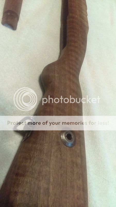

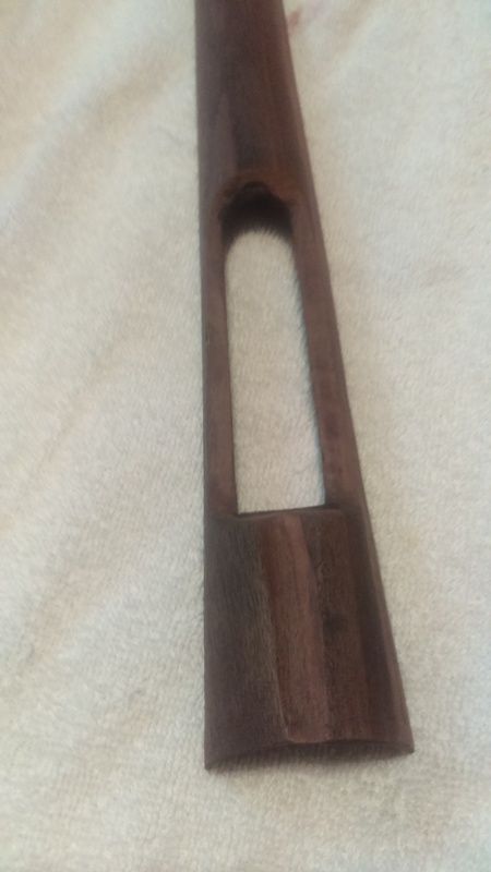

Another gun guy suggested to use Krud Kutter and boiling water to get the crap out. Holy crap that worked great. I'll post pics in a bit. The wood looks new!
Don't use raw boiled linseed oil. Raw linseed oil takes FOREVER to dry, and the oil finish will be no better. Stick with boiled linseed oil as each coat of linseed oil must be completely dry before moving on in a finishing project. Consider also using rotten stone for a hand rubbed finish.

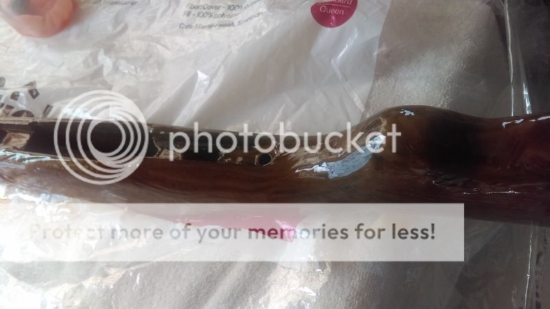

Here is the first coat of linseed oil.... it's going to look good! I was instructed to apply it with my finger in about 10 super thin coats...
What you do between coats once each coat is dry, is just as important, if not more so, than the coats themselves.
Yes, I was instructed to use rotten stone, but since I don't have it I am using 1000 auto paper and 00 steel wool to lightly sand. What do you suggest?
