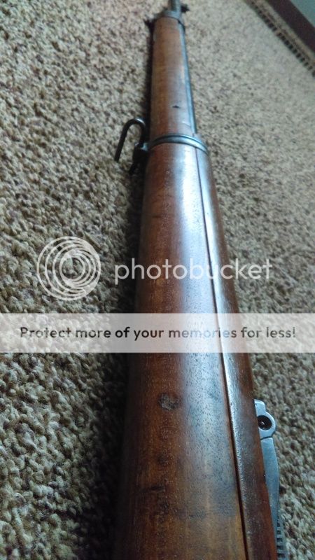

Stripping my Mauser stock.....
I would have personally left all that grease... It would have waterproofed the wood and been better for the gun... I would have applied two coats of a product called Atsko Sno Seal to the Stock and buffed with a clean non linty rag (preferably a new bath cloth) The product is made of beeswax and silicon and will waterproof leather and wood. Good for both. It will slightly darken the wood though, and from the sounds of it, you want the wood brighter and cleaner..
Looking good so far, I advise over applying that Oil for finish...

I finally have 8 coats of linseed oil on this stock. when it cures I will post some pics of the finished product.
I finally had a chance to finish my 8mm Mauser stock. It was really easy. Linseed oil and floor wax! It did take several days (10) for the 10 coats of linseed oil, but it looks 1000 X better than it did before!! I used Citri-strip and Krud Kutter to get the oil out of the wood. 800 and 1000 wet sand and 000 steel wool before the wax job.
