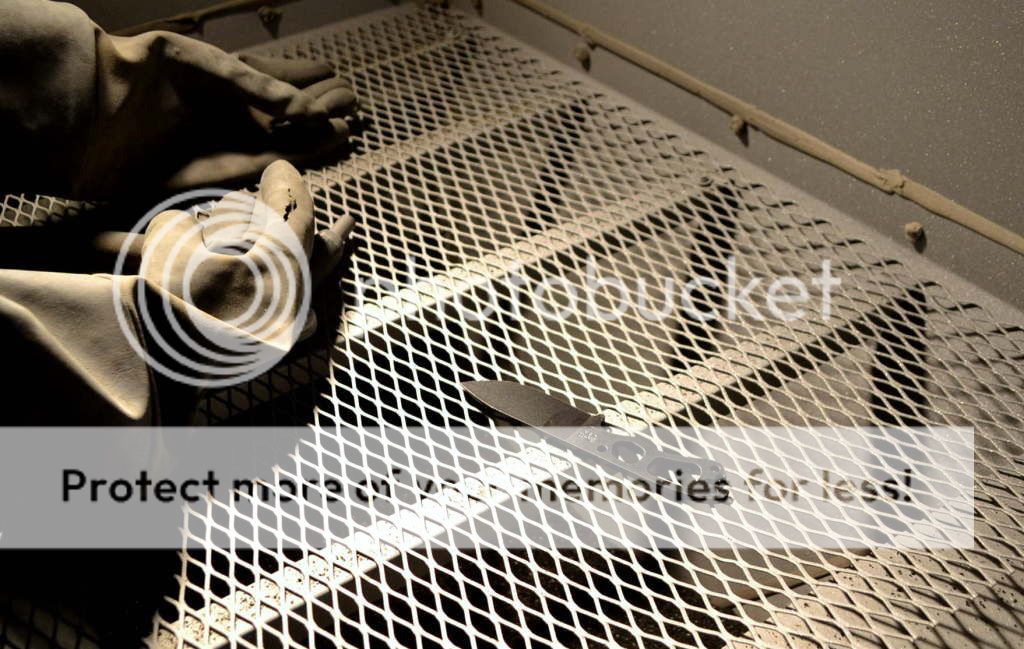

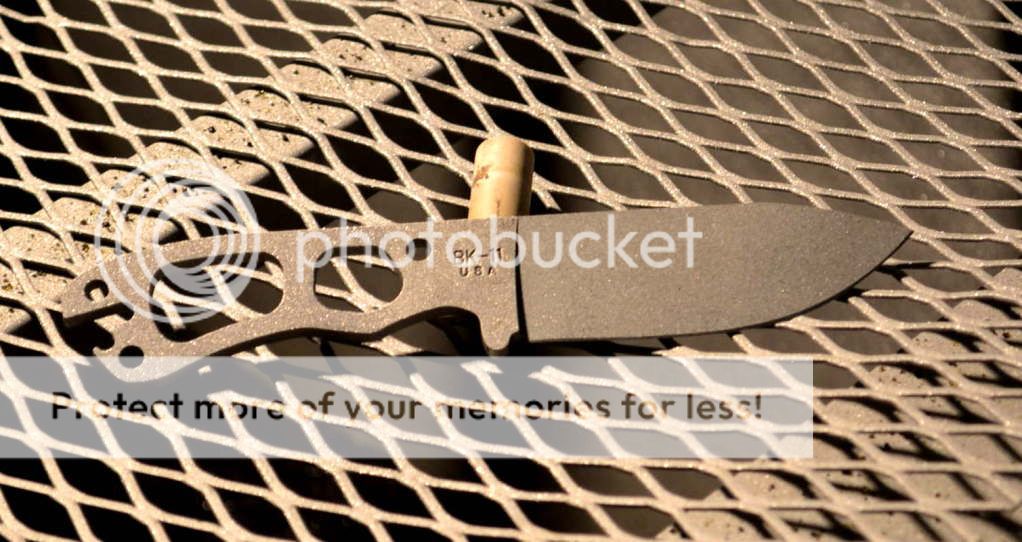

The BEST way???
We-e-e-ell, let's see... All out of BK-14's at the moment, so we'll have to demo with an -11.
The scene of the crime:
Before:
And 75 SECONDS later...
No scraping, no burning flesh, no mess to clean up.
Well, you did ask what the BEST way was... :D

Hey, you cheated :D
Man, I wish I still worked in a place with a sand blaster, it'd make life so much easier sometimes...
Its a Sandblaster??? See I did not even know that. I thought it was an oven of some sort.
