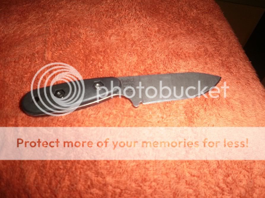

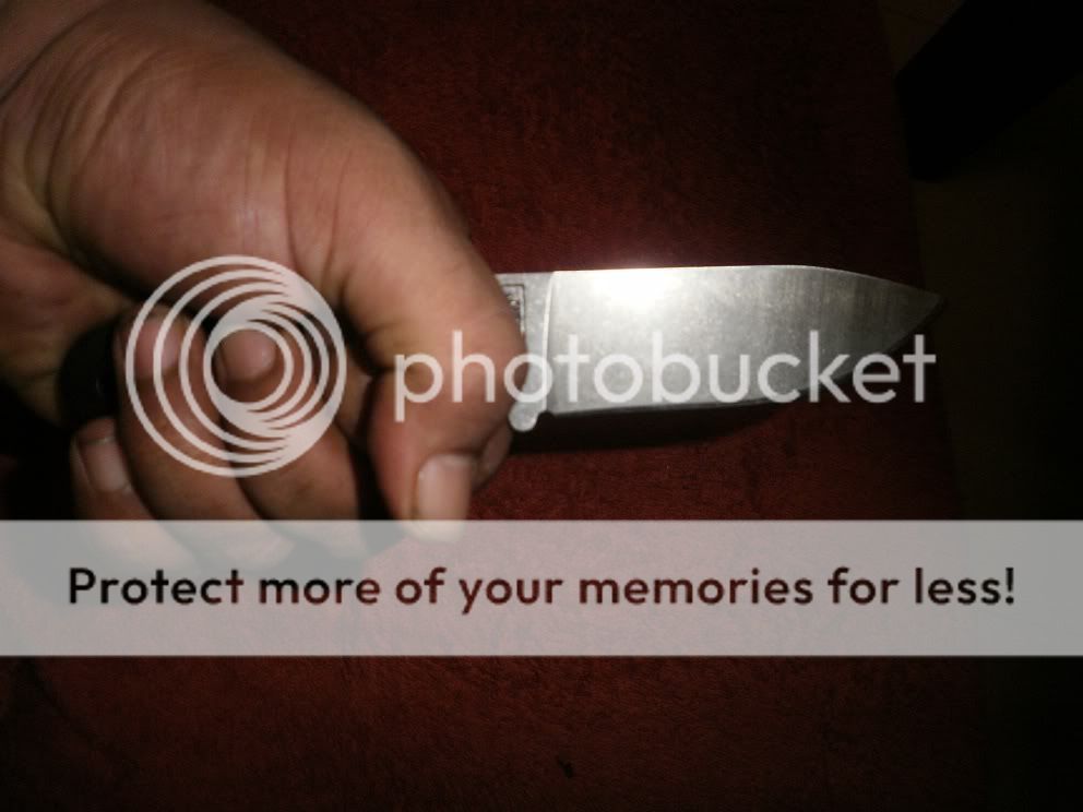

I did it. It was actually quite easy.
I sanded the coat down with 120 grit first
http://s1157.photobucket.com/albums/p583/raghavachari77/Eskabar/?action=view&current=Sanding1.jpg
http://s1157.photobucket.com/albums/p583/raghavachari77/Eskabar/?action=view&current=Sanding2.jpg
I read that it would be better to keep the coating under the scales but I did not know the effect the stripper would have on the zytel. So I wrapped the scales in foil and reattached them.
http://s1157.photobucket.com/albums/p583/raghavachari77/Eskabar/?action=view&current=Foilwrap1.jpg
http://s1157.photobucket.com/albums/p583/raghavachari77/Eskabar/?action=view&current=Foilwrap2.jpg
http://s1157.photobucket.com/albums/p583/raghavachari77/Eskabar/?action=view&current=Foilwrap3.jpg
http://s1157.photobucket.com/albums/p583/raghavachari77/Eskabar/?action=view&current=Foilwrap4.jpg
Then I left it in the Snot for 15 Mins and then realised the 120 grit wet/dry sandpaper would mark the metal. So I shifted to a steel kitchen scrubber
http://s1157.photobucket.com/albums/p583/raghavachari77/Eskabar/?action=view&current=Stripper1.jpg
http://s1157.photobucket.com/albums/p583/raghavachari77/Eskabar/?action=view&current=Stripper2.jpg
The kitchen scrubber took of the coat without touching the metal and I think it has left the primer on it. There is this smooth grey finish on the blade and I think it looks awesome. I am undecided on whether to sand off the primer. Advice please?
http://s1157.photobucket.com/albums/p583/raghavachari77/Eskabar/?action=view&current=Stripped1.jpg
http://s1157.photobucket.com/albums/p583/raghavachari77/Eskabar/?action=view&current=Stripped2.jpg
http://s1157.photobucket.com/albums/p583/raghavachari77/Eskabar/?action=view&current=Stripped3.jpg
http://s1157.photobucket.com/albums/p583/raghavachari77/Eskabar/?action=view&current=Stripped4.jpg
As you can see I left the coat to match the zytel scales. The lines are not too smooth but that part goes under the scale anyway. And I totally see the value of leaving the coat on under the scales, living in a wildly humid environment. Hence the reluctance to sand anymore.
