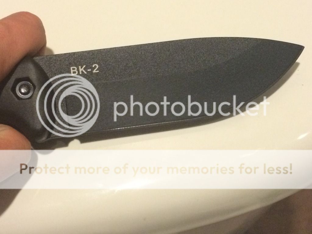

I did it today. I used 600grit sand paper smooth as eggs now. I did it on the grind portion of my bk2. Only took an minute or two and since its a fine grit you dont have to be too careful.

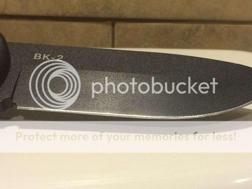

I used 600 grit regular paper because thats what i have on hand. Doesnt take much pressure or work. I think the photos show the smoothness in the right light.
Thanks for the photos. It looks like the perfect balance of smoothness and protection.

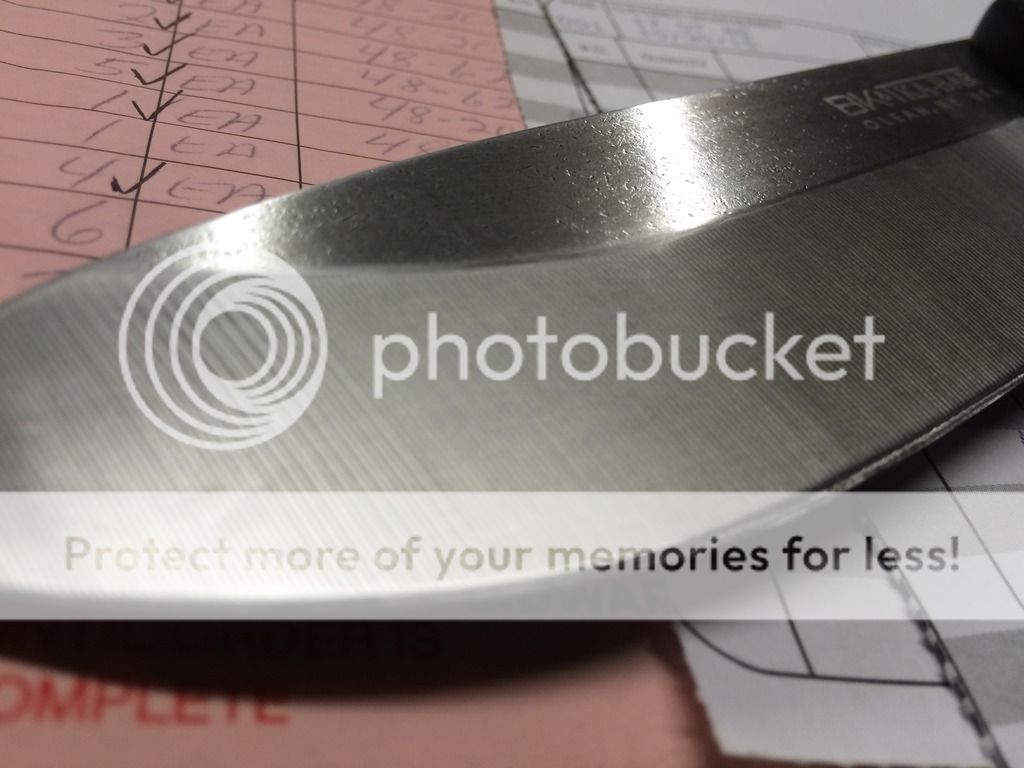

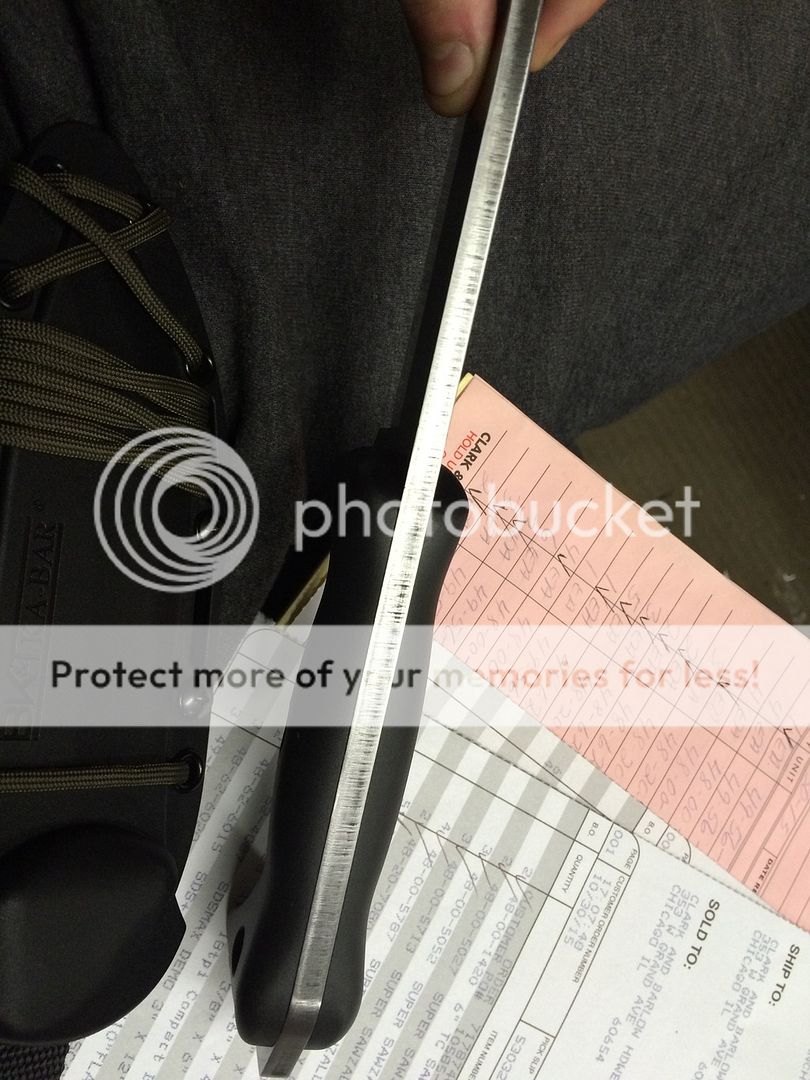

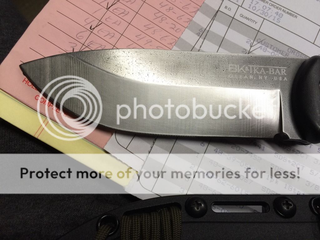

After sanding the coating doesnt take much to mess it up. I was splitting pallet boards for about an hour. That did it for the coating so i ised strip ease it comes in a quart. Its like a gel only took ten minutes to strip it right off.
The spine is tough to get every bit of coating off.
