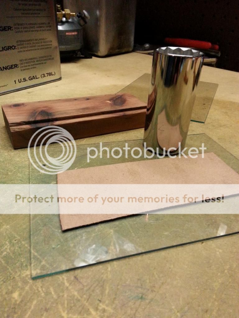

Stitchawl has a bunch of good strop info on this forum.I have a few made from veg tanned leather that was prepped by casing then working and compressing using a huge deep well socket to roll along the leather using a lot of down force and a glass plate.Something about moving the minerals present in the leather and hardening it so the surface don't deform causing it to effectively increase the angle and dull the edge.Cordovan horsey hide is the leather the best strops use and it's very expensive.This is for bare leather strops,abrasive compounds used to dress the strop probably work as good on cheaper veg tanned leather if it is not too thick.But lots of folks get great results with notebook backing and even the palm of a suitably rugged hand(not office hands).I got an insert for my KME that uses kangaroo leather but have not used it since the set up is only used by me for making thick edges thinner,but If Ron sells and endorses it is good stuff.
