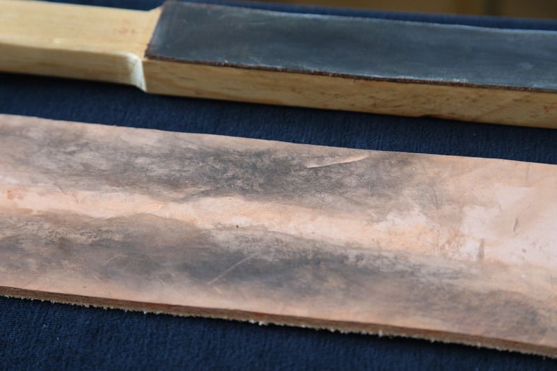

Hi guys . I have a question . I was at the flea-market and walked by a guy making belts . I ask if he would sell me a pies of leather . He asked me what for and I told him he said that the leather he had was cowhide and it might not work for a strop . I have a picture of it can any one tell me if this is good leather for a strop .
Thanks .
Cow is good.
Vegetable tanned leather is best. Chemical tanned leathers may have residues that may patina/corrode some steels over time.
You don't want it too coarse or too thick. Those in the image look okay.
Used the coarser side with green compound. Use the smooth side with white compound or diamond paste.
I got veg-tanned 8x11x.0625 for $6 on sale at Hobby Lobby. Picked up a couple feet of 1x4 and 1x3 Maple at big box store for about $2/ft.
This leather looks fine.
And with all due respect to TravisH, use either side with any compound. The fact that the flesh side is more rough will have no appreciable effect on the results you will get with compounds. Think about it for a moment... The leather is NOT sandpaper. You don't need to think about it as 'grit size.' And the compound is working in micron-size particles. Those are a fraction of the size of a human hair. Those bumps on the leather are a whole lot bigger than a human hair. The only difference you find between the grain side and the flesh side of the leather is that there is MORE CONTACT AREA on the grain side because it's smoother. Same sort of difference found in 'interrupted diamond' sharpeners vs continuous diamond. More contact area, which equals less time spent stropping. Of course, the actual time difference shouldn't amount to more than 10-20 seconds...

I'd say try both sides of the leather with the compounds of your choosing, and see what works best for you. The 'rough' side of common cowhide is highly variable, based on the many pieces I've tried. Sometimes it'll be OK, or even good. Other times, it'll be very lumpy or inconsistent in texture or firmness, with some areas feeling soft and other areas very hard. More often than not, I've compromised and 'roughened' the smooth side with some sandpaper, which leaves a velvety 'nap' on it; that'll take and hold the compound more easily.
As Stitch mentioned, when used with compound, it won't necessarily matter if you use the rough or smooth side, depending on the individual piece. Even after sanding the smooth side, which gives it a sueded type of finish, it'll quickly smooth out and maybe even gloss over a bit with use (especially when used with wax-bound stick compounds, which take a 'shine' with some use). The sueded finish of sanded leather just allows the surface to hold more compound and accepts the application much easier with stick/crayon-type compounds; makes it easier to get even coverage that way.

The majority of the strops we sell use cowhide. They make for a nice strop at a good price. You will be just fine using that leather.

i use both the thin and thicker leather's,with the 1/8'' thicker leather i use DMT diamond paste on smooth side up for out standing results,and for regular stropping with green compound i like the thiner leathers rough side up,looks like the leather you have there will work just fine,depending on witch compound you use!will determine what side you will use.[URL=http://s1157.photobucket.com/user/blanex1/media/BGBB7120.jpg.html][/URL]
