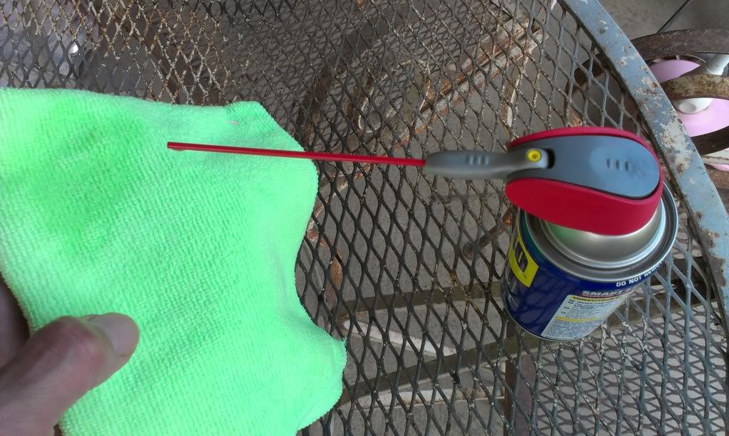

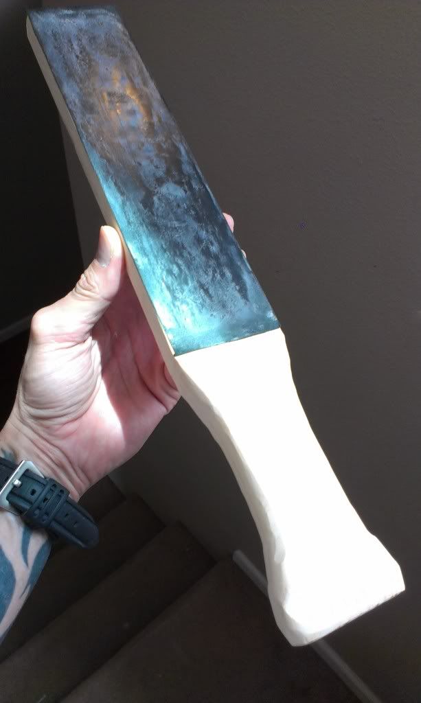

It occurred to me to start a new thread, but my pics and stuff don't seem like enough to me to warrant that. Hopefully the OP doesn't mind me posting these in his thread?

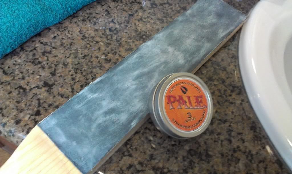

I cleaned my AlumOx strop, the one I use most heavily for my carving knives because I've started working with a harder wood that requires more knife maintenance.
Dirty strop interior lighting
Sun lit (first pic shows better)

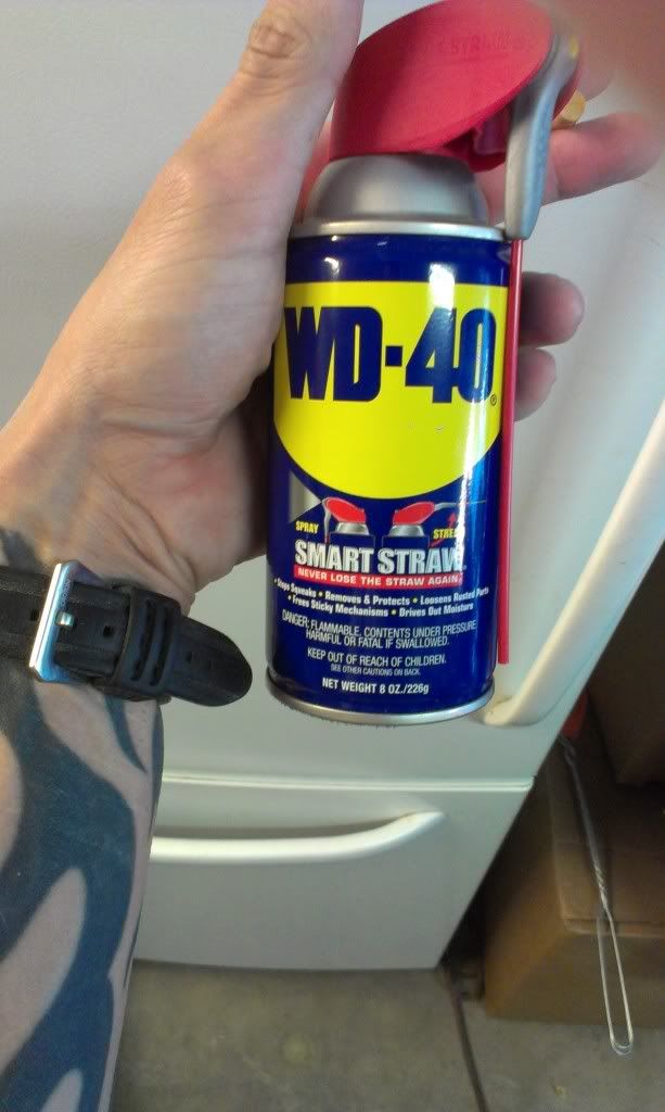

Wd40 and a microfiber towel

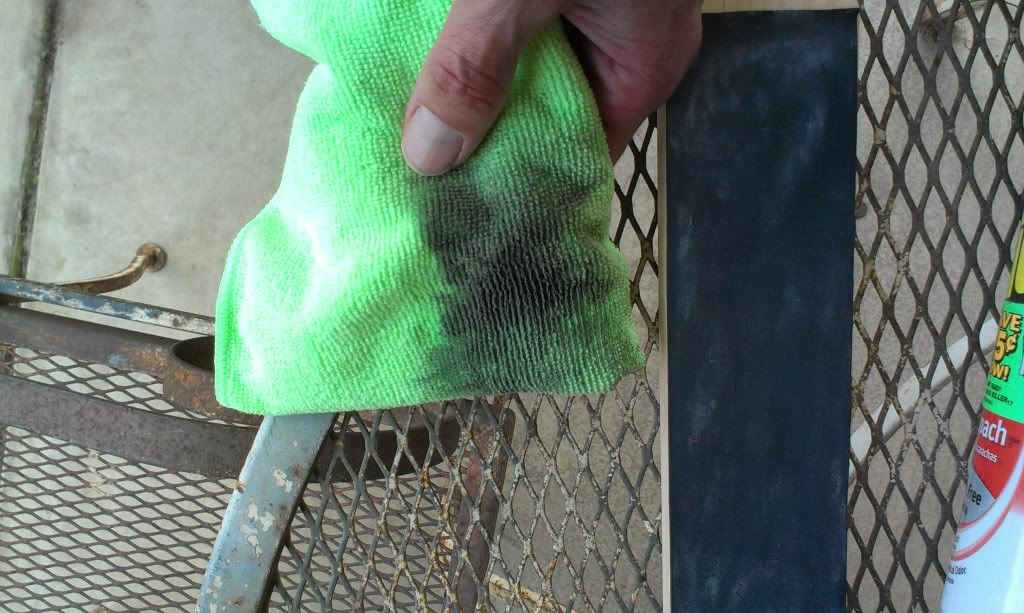

Swarf

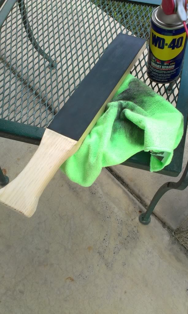

Cleaned in shade

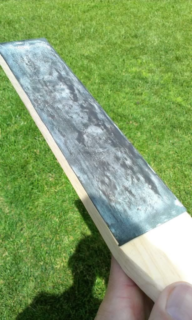

And in the sunlight
It's drying now, but I can already tell you 100% that I like it much better this way. As has been pointed out, every strop is going to be different from the next. There are too many variables to make blanket statements, that's true, but for me, with this strop, I'm going to say that I'm very happy with the results using wd40.

Looks good (very good, actually). I hadn't even thought of the microfiber towel for use with WD-40, but that makes good sense. These towels are great 'scrubbers'. I frequently use microfiber towels dry, for wiping down strops and hones when they get dirty, so I guess I should give it a go with WD-40 the next time.
David
And ready for action.
The compound looks to be applied heavily in the pic but it's used fairly sparingly. I'll run a junk blade over it a bit to help settle the abrasives as they are slightly aggressive in this carving knife specific compound, then it's game on. :)
