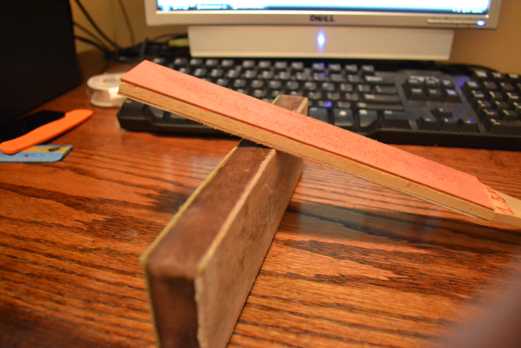

added a white side to a knives plus strop block
plus i got a heavy duty paint stirrer and glued leather on it and put 1 and 1.5 micron diamot paste.
tada! home grown hehe
